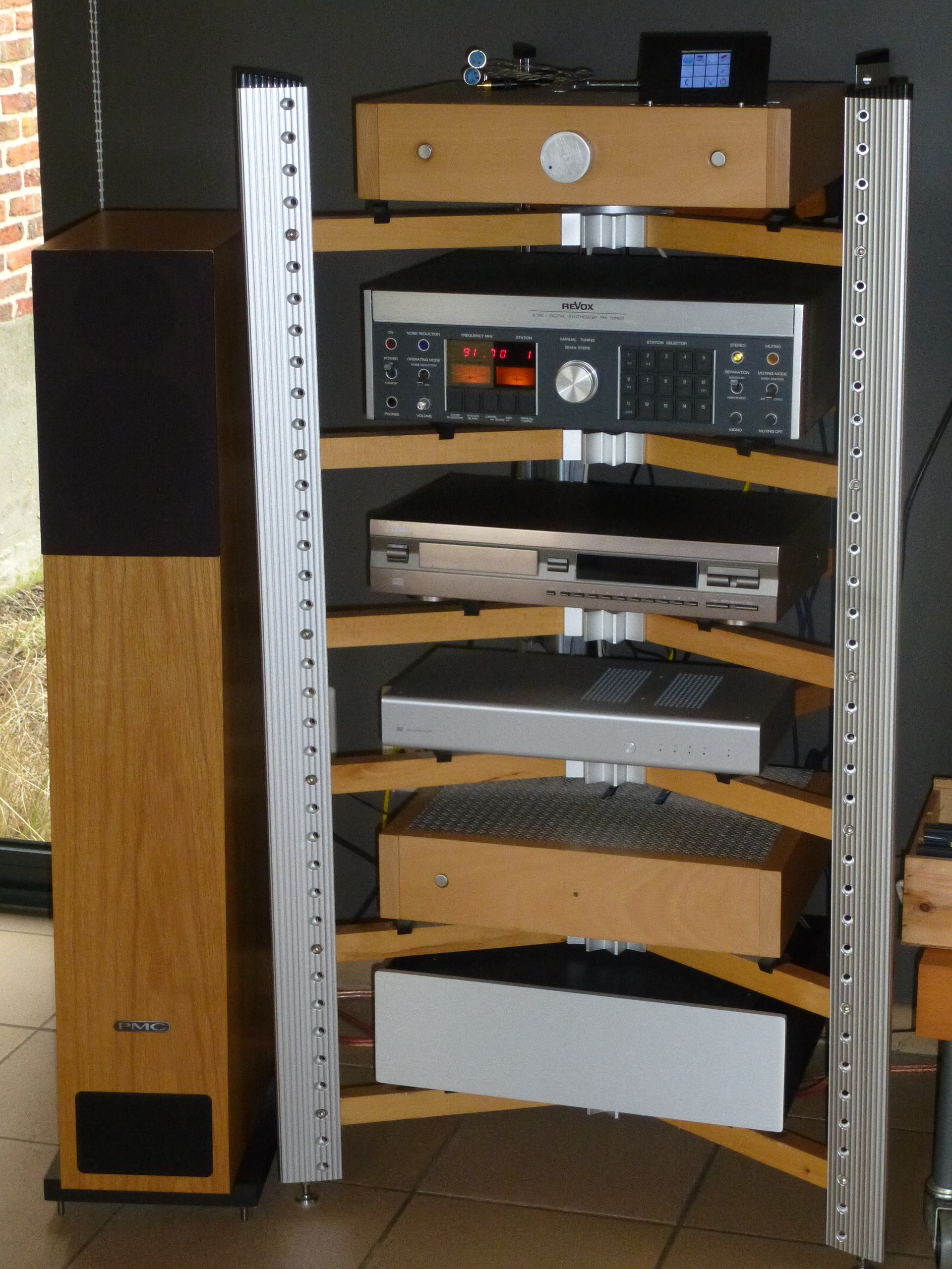

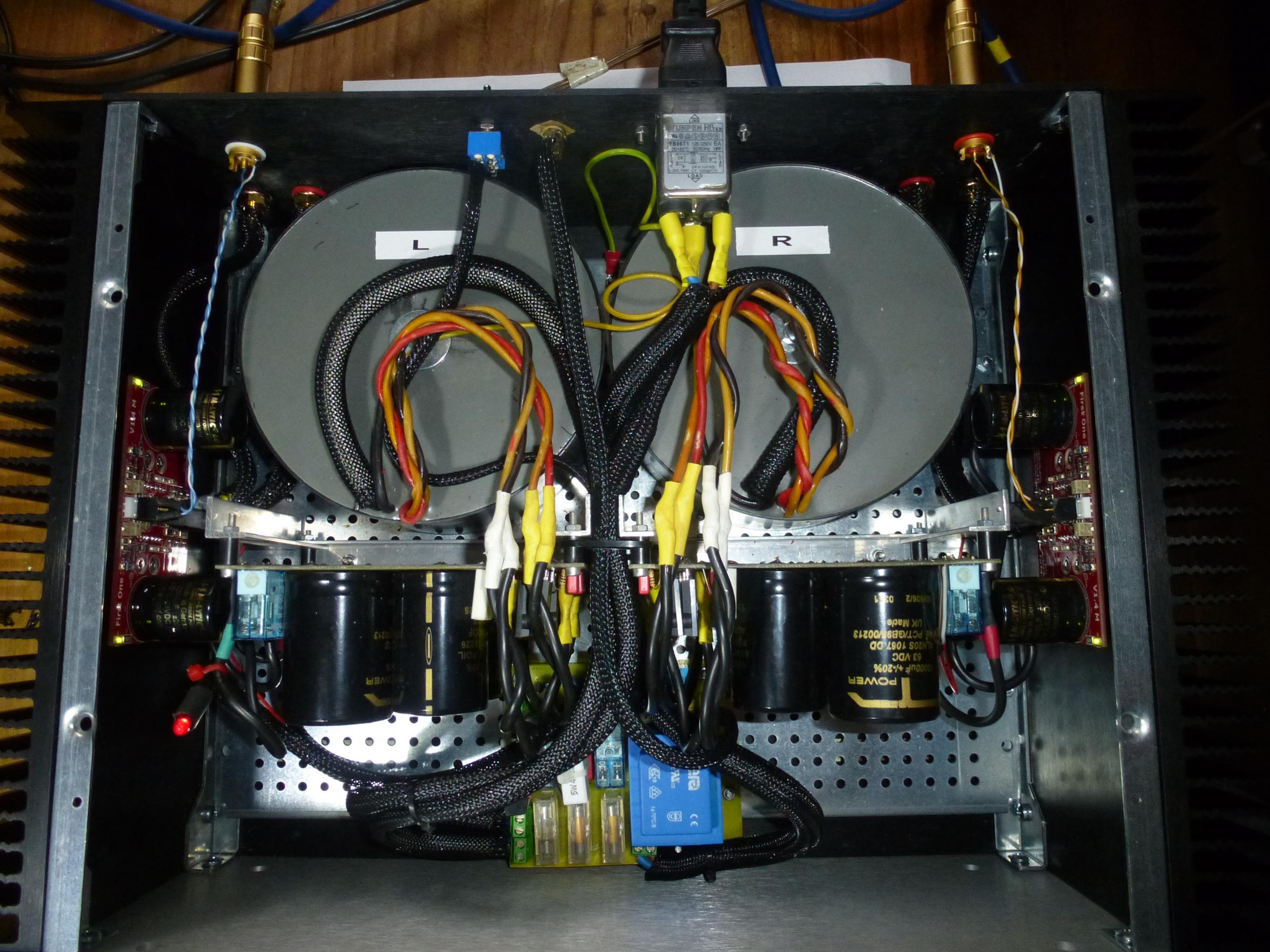

Finished my First One M last week. It replaces a Hypex UcD400HG-HxR. I reused the linear Power Supply which gives 56V from a 600VA-40V transfo by channel. Decoupling uses 20.000uF by channel and by rail. I think this must be at least as good as a SMPS.
Source is: Raspberry Pi - DAC Schiit Gungnir - optical volume à la George, but with DIY digital control and auto-calibration - DCB1 - Power amp. Everything is DC-coupled. Speakers are PMC Twenty 24.
The sound now? It's a big improvement in highs. They are silk now, compared to a more harsh sound from the Hypex. The Hypex was not bad, but with the PMCs the highs weren't perfect at all (they seemed OK with Focals before). Now a cymbal sounds like the real ones. Mids are better as well, but the difference is small. Lows are there, but the perfect control the Hypex had over the woofer isn't there anymore. The output impedance seems a bit higher on the First One then on the Hypex. Still OK, and lows are very strong and clear. But they are more rounded than the Hypex. If I ever build a subwoofer, it will definitely be with Hypex-amps.
The case is rather full. There is just some space left to put VUs or a display on the front-panel in a later stage. That explains why the layout seems to be the wrong way around for 240V-cable-length.
At the moment I'm happy with the system. Instruments are more separated than on the Hypex, but the sound remained very full. Compared to a gainclone a lot better as well. Also more refined. I thought I couldn't run a big risk spending the 200 Euro on 2 modules, a lot less than 2 ncores. It's the best 200 € I've spend for an upgrade. I don't feel the need to move to ncore anymore.
Negatives? Yes. I miss the schematics. I'd like to lower the gain, but don't know what resistors to change. The amp is also very unstable in function of supply-voltage and temperature. But until now I haven't seen the woofers flying through the room, so the deviations are limited. Nevertheless I'd like to try a DC-servo, but without the schematics that's rather hard. I count on having the schematics published one day, especially since v1.4 seems obsolete now.

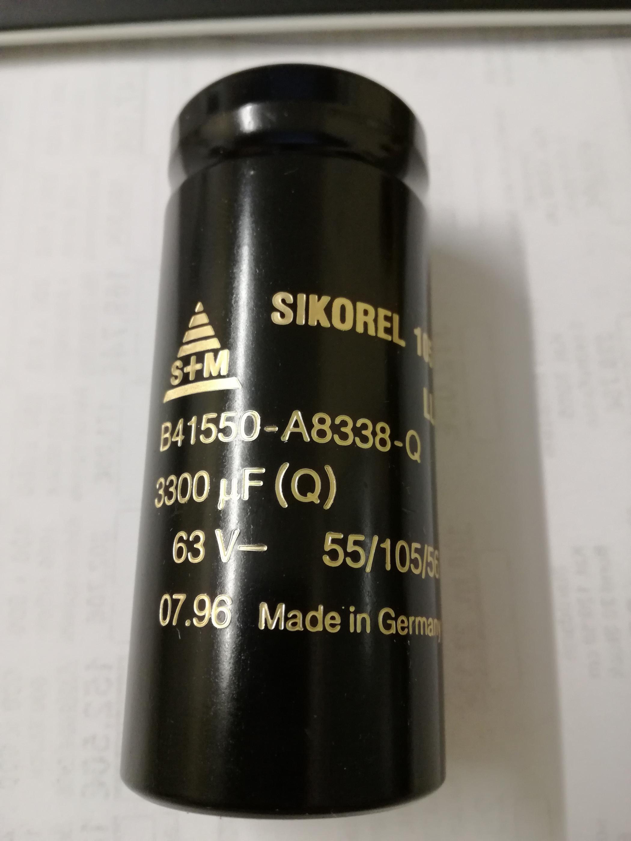

Hi Dominique, Link takes to a search page, can you post Brand and specs please?
Check these part numbers from Digikey or Mouser
1 - Kemet ALS30A103DE063
2 - Epcos B41570E8109Q
3 - Kemet PEH200MD5100MB2
I'm aiming for # 1 which is still affordable.
10000uF 63V
ESR = 17 mOhm @ 100Hz
Ripple Current = 10.8A @ 100Hz
Impedance = 14 mOhm
Lifetime = 5000 Hrs @ 85°C
Those are really good specs for the price
