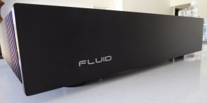

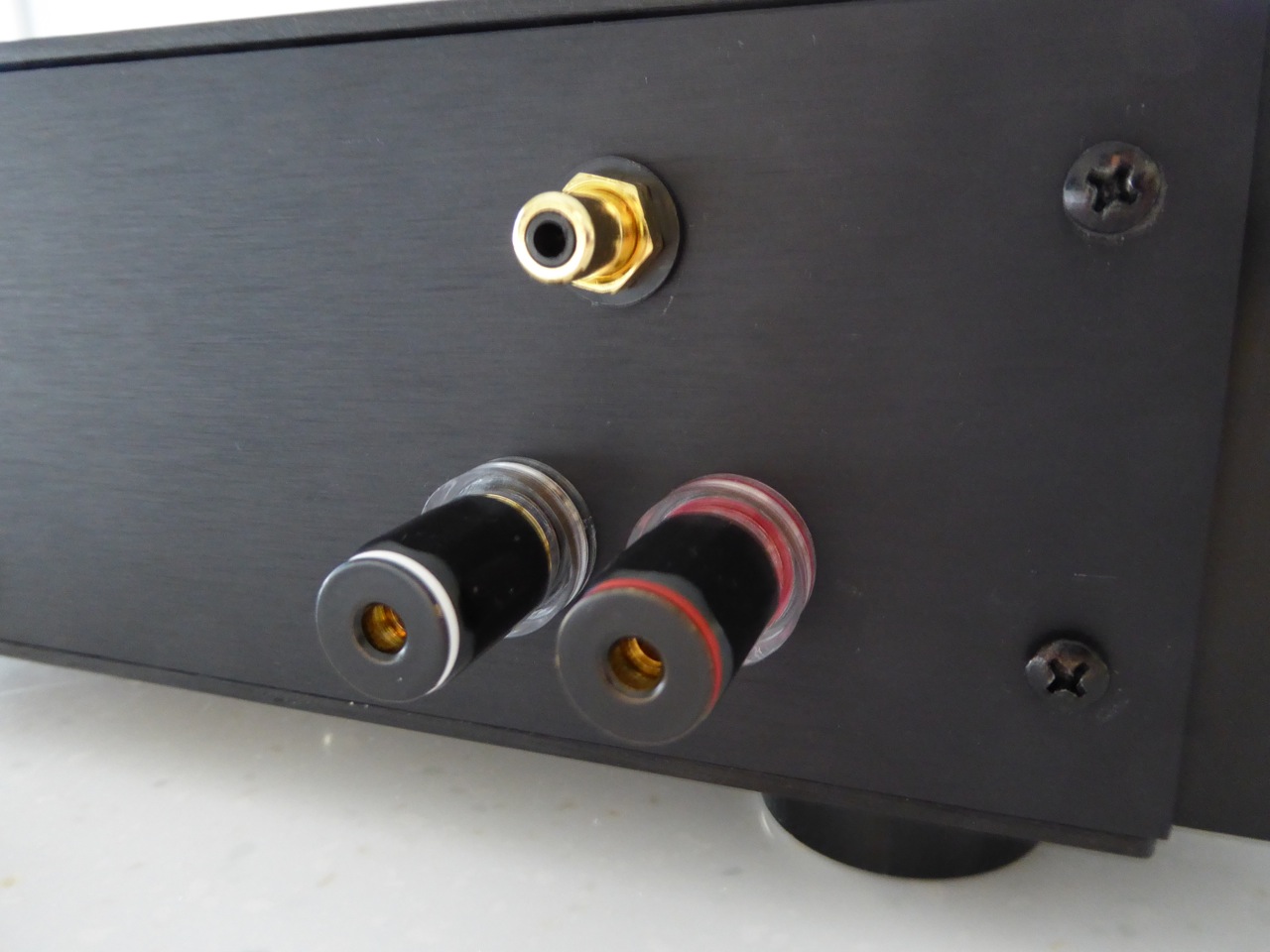

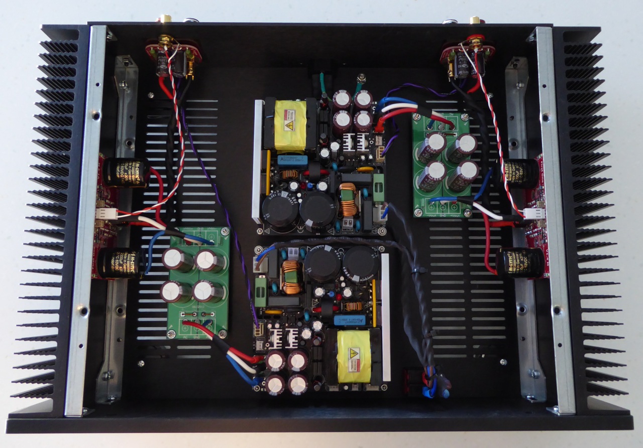

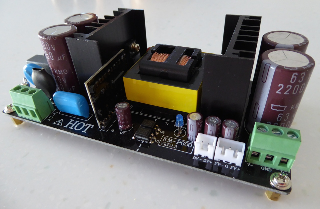

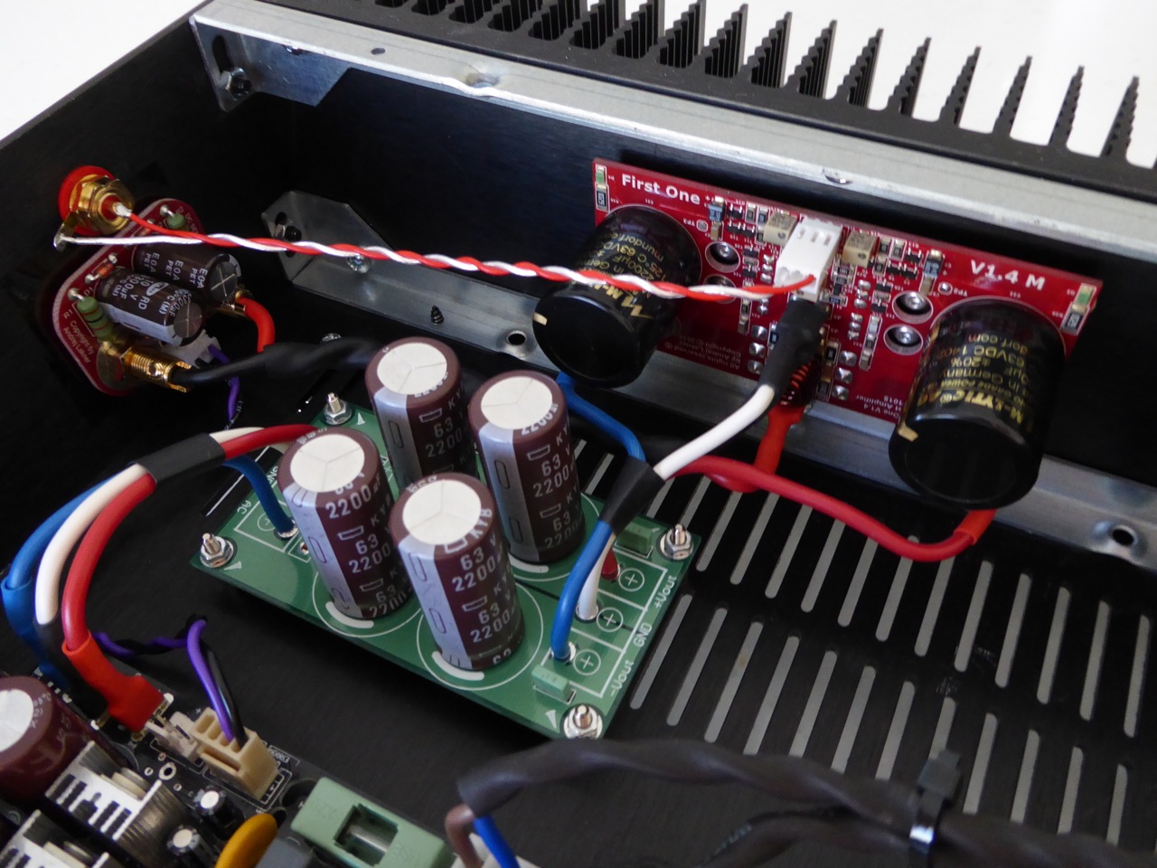

Stereo Amp finished

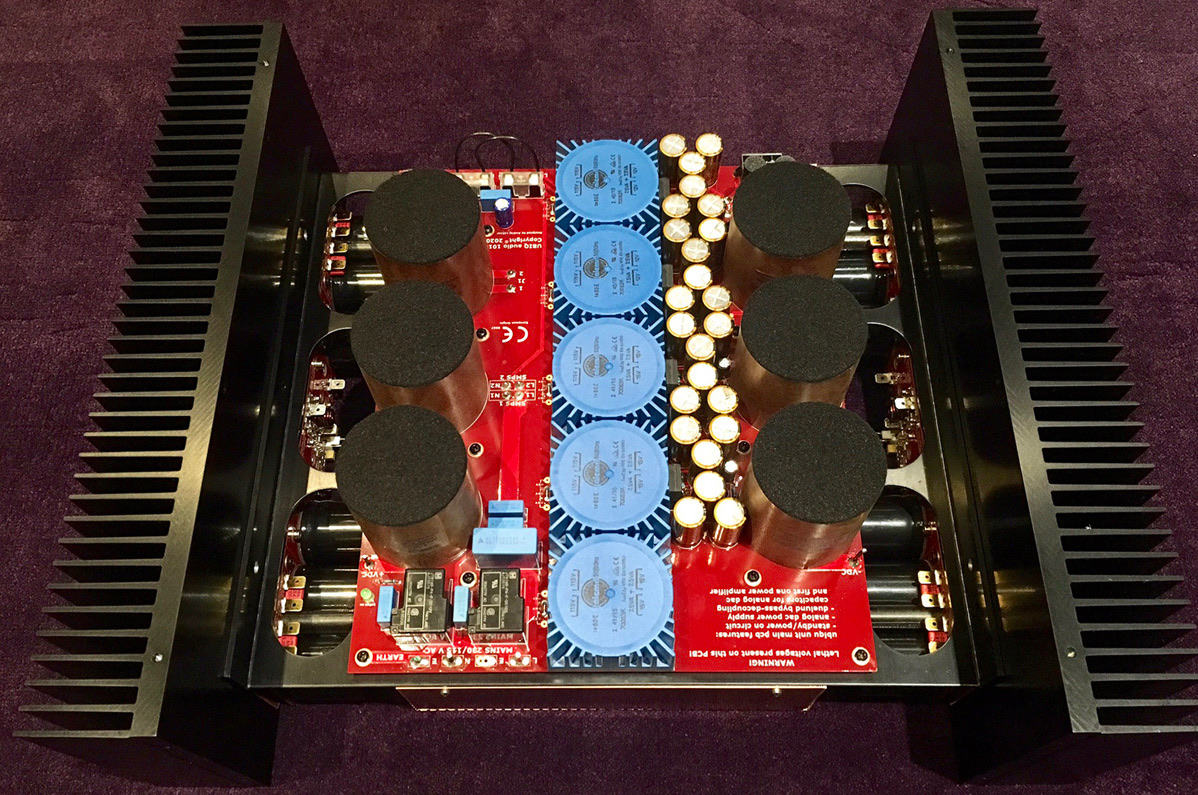

Hi Guys,
I have just finished my new First One 1.4M build with SMPS600 from Cresnet and some capacitor boards that I got very cheap from Taobao, 4400uF per rail extra United Chemicon KYB from Mouser, less than US$2 each when you buy 10, and very low ESR and high ripple when paralleled.

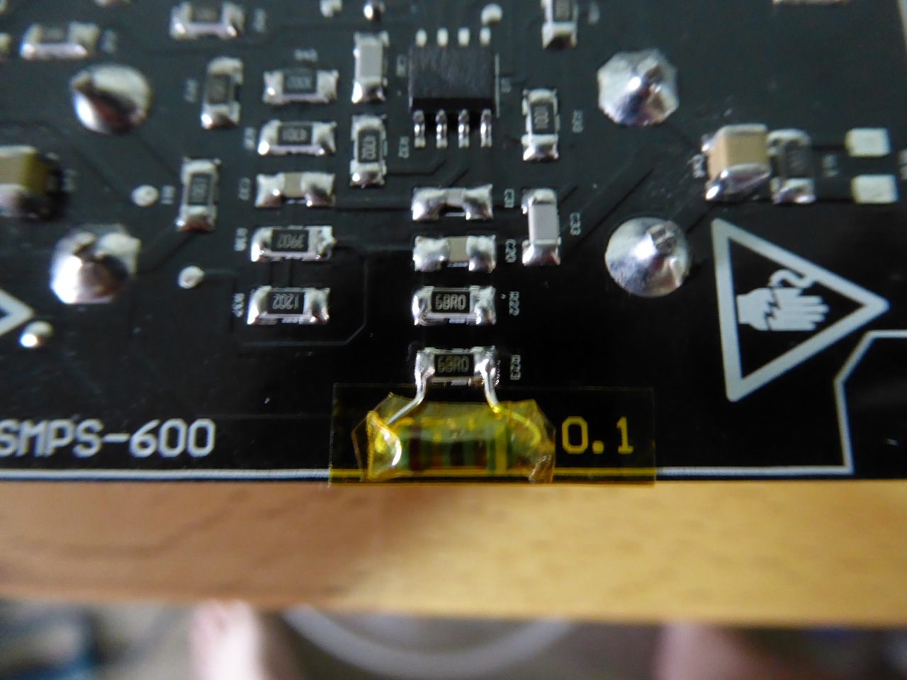

One thing for anyone who might want to add extra capacitance to an existing Cresnet supply. The extra capacitance tripped the Over Current protection at start up, with advice from Cresnet all it took was 1 resistor to be added in parallel and the problem was solved.

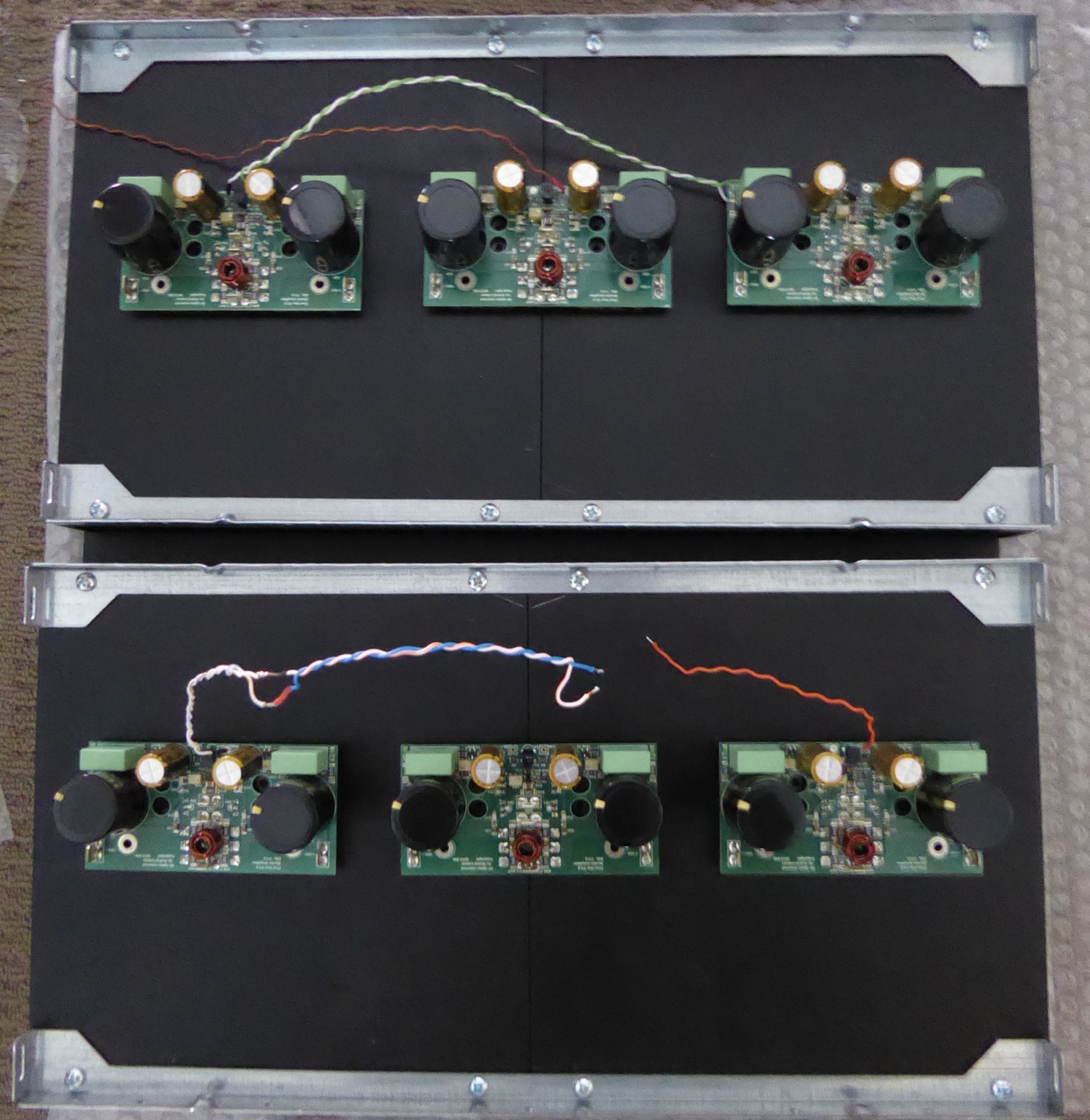

Next in line is the rebuild of my 1.2 modules into a 6 channel amp with individual power supplies.

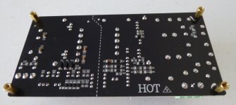

I have found another SMPS from Taobao that is very well made for a very low price, I have tested them and so far work very well and sound excellent. They drop around 5V under load and on 240V AC give 55V when loaded with a First One at idle. These are strictly 220 to 240V only though.
As I needed to buy 6 the shipping was making other options very expensive.

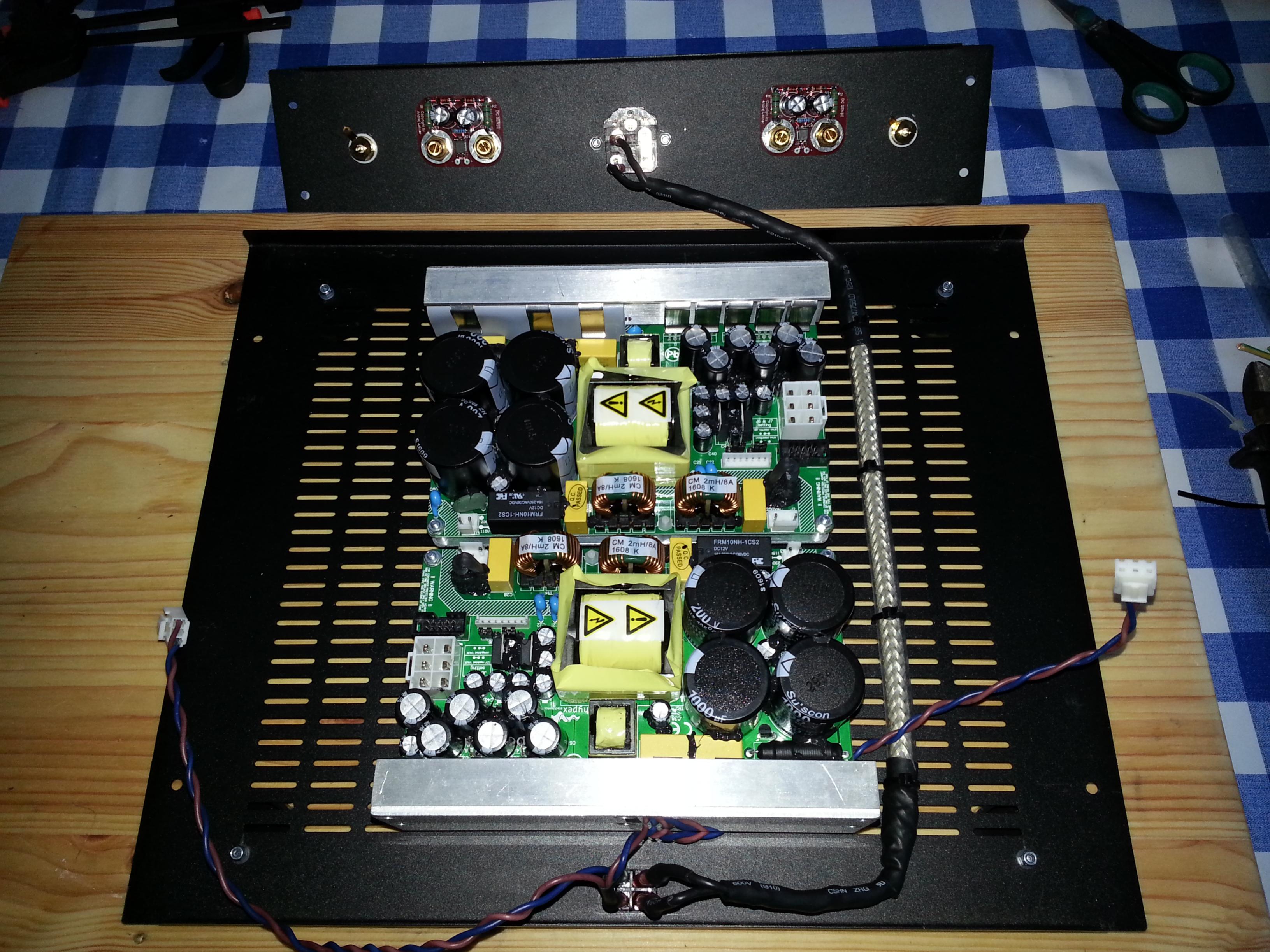

Hello,
I started my build of the first one amp 1.4. I am using 2 smps1200a400 from Hypex for power supply.
I have a problem when connecting. I currently have iec ac connector connected to a switch, it measures 230v ok. When I connect one of the power supplies the fuse in the iec ac connector blows instantly. I tried it two times with both supplies. I am using 1A slow blow fuses.
Hope it is something simple, anybody knows what I am doing wrong?
