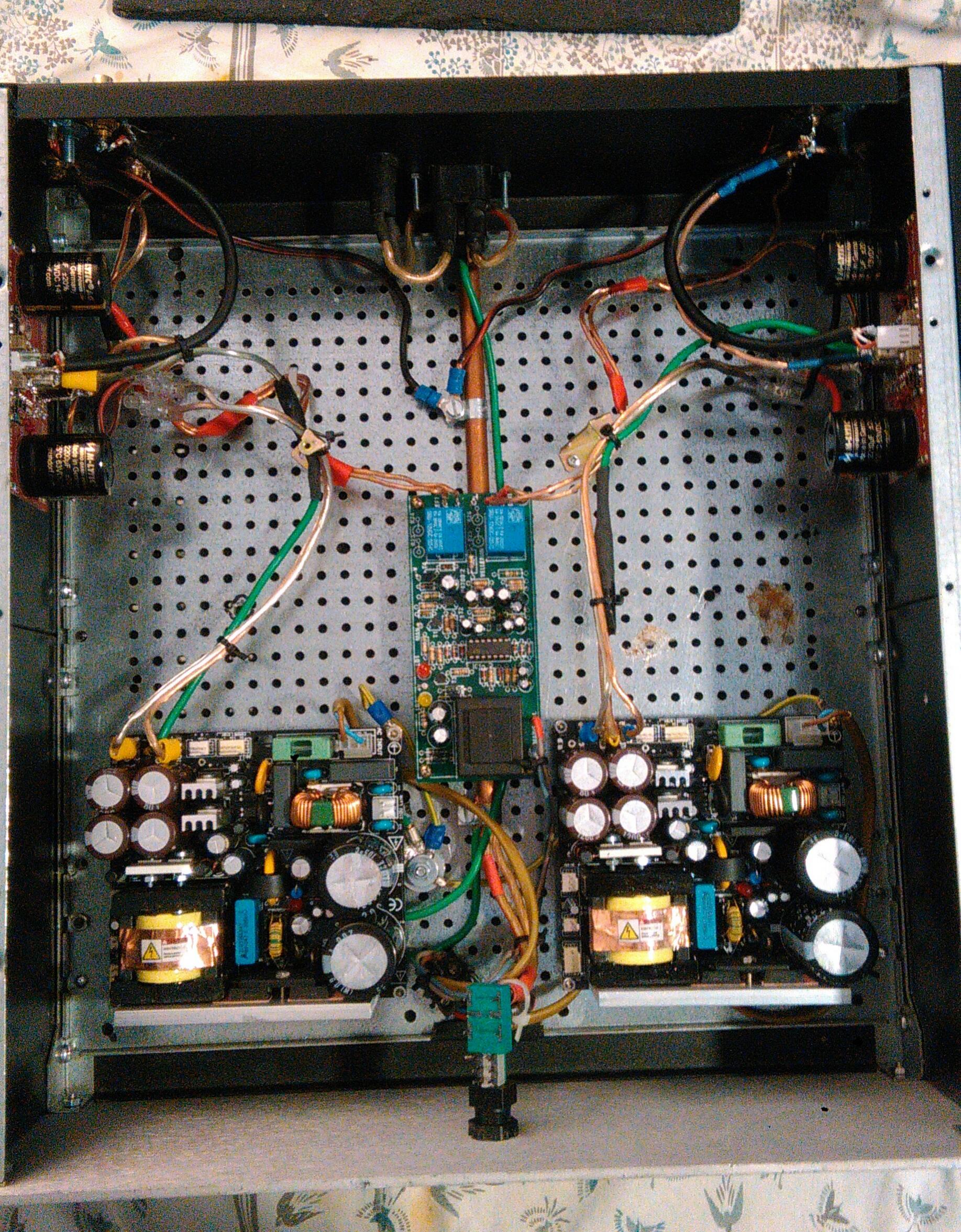

I just finished installing my 2 brand new Cresnet SMPS 600 psus (47.5Volts)
with my FO 1.4M modules (dual mono setup).
The sound I get is extremely good.
The previous PSUs I had were traditional R-Core 360VA transformers and about 10 volts less on the DC rails.
I'd say that the difference in the sound I get from my speakers is a better dynamic making small details more audible in all the spectrum.
Beside this sound improvement, there is an important difference I've noticed with the Cresnet smps: the current I now get allows me to fine tune the bias and offset of the amplifiers modules in a very stable way - when it was more or less floating (up to + or - 40mV sometimes, sometimes less) before with my r-core transformers and MUR rectifiers ............
Pictures will follow, hopefully tomorrow.
Cheers
JMK
Here is a picture of my new amplifier (in my previous LM3886 recycled case).
Extremely good sound.
