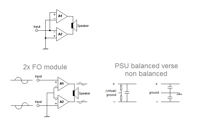

Isn't it called 'bridged' (as here)? Balanced is about matched impedance / differential amplifier (that could well be single-ended as here) and separating groud currents from signal path. I actually would be more happy to see balanced inputs rather than bridged outputs...
If you happy to see balanced inputs and at same can live with amp also get bridged outputs it should be possible, below first schematic is copy your link to bridge amp, then couple as in lowest schematic and you have fully balanced input. Can't predict if it would run trouble free on balanced PSU, but pretty sure on non balanced PSU with virtual ground it would work.
No, not bridged. Fully balanced input/output, matched impedance differential amplifier, couldn't be more differential than this, you'll see. 😉
The input (cabling) is properly balanced, but the amplifier itself in your topology is still two separate unbalanced amplifiers, not the difference amp. If the input signal has not symmetric voltage - you get only 1/4 of possible max power on the output...

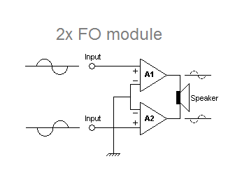

The topology drawing would be the best explaining. 🙂
But what I meant is to have also properly balanced single-ended output smaller versions (M and S). So we could have ground loop resistant smaller amps that could be combined with single PSU etc. without worry about possible hum and have the best S/N ratio non-interfering with best common mode rejection.

No worries, all First One modules will stay unbalanced input as till now. With fully balanced topology, the concept is to preserve original differential signal from the source not to make new subtraction in FO amp's front-end, it is meaningless even wrong to do that. Once the signal is differential, high Z from GND, there's no reason to differentiate it again and again every time in every unit in the signal path, for me that is wrong since it introduces new distortions and subtraction deviates unnecessarily.
My point is to make balanced amplifier which amplify both phases of the signal independently and summ them at the speaker itself. Pic below explains it well (thanks BYRTT).
