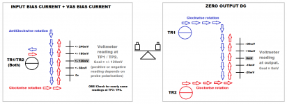

I find it impossible to adjust DC. One channel 35 mv and the other 51
Yet it is well explained on the instructions paper...
First, patience. Next, let warm the amp for one hour.
Then write a column on a paper of the effect on bias and DC offset of each move of each trimmer.
Then trim with patience, given the above, and when you arrive at a promising level, let stabilize again and return measuring after half an hour or so.
With the approach above, I got 7mV on one channel and I thought something was wrong on the other because I got 0mV.
Good luck,
M.
I was satisfied with 35 mv. in each channel. Not enough patience.
Guess its nearly same process as with VSSA amp and maxlorenz can maybe confirm that, it was nearly impossible go in 0-5mV area without having two DMM connected at same time as suggested in manual, also i made below visual for VSSA amp to help understanding under calibration.

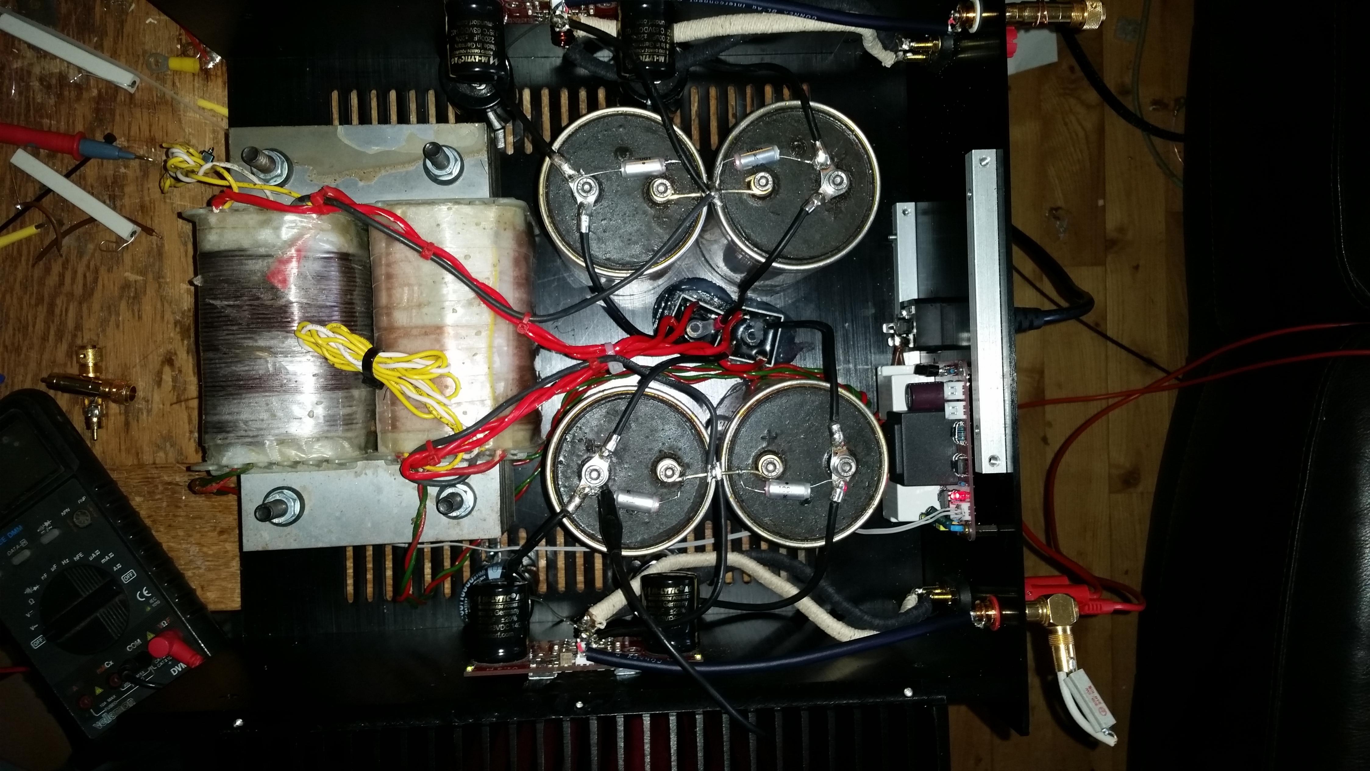

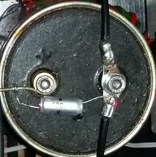

Another thing looking your build stumble over those bypass caps on power bank looks very small and wonder if their effect is measured in situation, because if not recommendation seems for audio gear either do not bypass to stay clear of new impedance peaks in the problematic region of 1...10Mhz or go on the "too large" side. More on the subject over this thread and think especially post 10 and 20 have good explanation and visuals http://www.diyaudio.com/forums/powe...ing-psu-capacitors-effective.html#post1566979.
More concern is about grounding scheme...
It seemed to me, from the picture, that there were multiple grounding points, instead of one star ground...I may be wrong thou...

No hum and fantastic sound. I will order some more. I do not like starground but bus.
