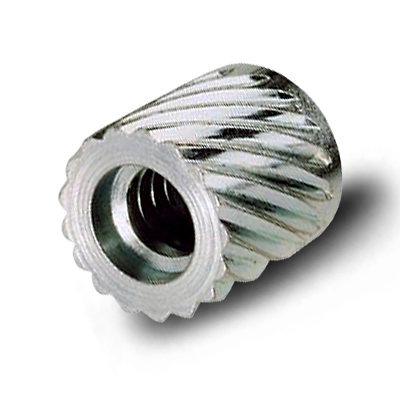

The solution to save your heat sink is to find a local machine shop that can burn the drill out with an EDM machine. It will cost some but shouldn't be that expensive for a single small drill bit. If after the drill is out the hole is a mess you then drill that hole larger and install what is called a Heli-coil in the hole to bring it back to the original tap size. The machine shop who can burn out the drill bit can install the heli-coil for you. It should be much less than having to purchase a new heat sink. The Heli-coil is a similar idea to what LC showed but it is made for repairing threads in metal, what LC showed is for putting a thread insert into wood or plastic, I've used thousands of those, they are not for your repair. You won't be able to remove that tap with a drill, the tap is harder than a drill and you just will walk of the center and make a bigger mess. Find a local machine shop who can fix this for you. The Heli-coil is a stainless steel insert that will last forever. It takes a special tool to install the insert and they come in a kit from McMaster Carr if you just have someone burn out the broken drill but requires drilling and taping the hole to a special size for the insert. This is how a cylinder head on a car is repaired when someone pulls the threads out of an aluminum head when installing the spark plug wrong or having one seize. A very common repair on threaded holes in aluminum.

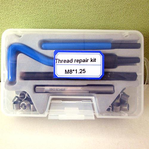

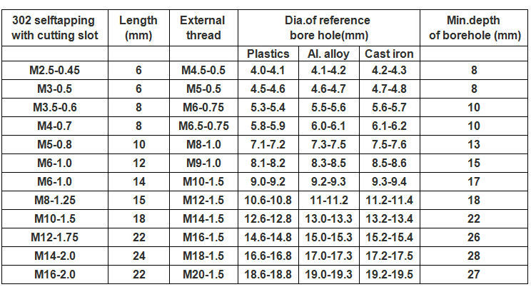

I agree with the helicoil solution, but M3 is a small hole. I think the outside threads on an M3 helicoil would be M5 size...
attachment.php
Meaning the hole (after removing the tap) can't be much over 4mm. Don't mess around, look for help would be my advise.
In air-cooled cylinder heads it's quite a common practice to helicoil all tapped holes because they will last longer and be stronger than the original tapped hole. I've done all exhaust studs on my own air-cooled heads.
attachment.php
A DIY kit looks like this (for small numbers)
attachment.php
M3 is quite hard to get right though(*). Easy to break a tap. On my project I used a drill stand for a hand drill to guide the taps. Doing all of the moving/rotation by hand this gave way less sideways motion. A guide/template for drilling the holes is very welcome too. More work, but less of a chance of things going wrong.
(*) reason enough for me not to tap M3 unless absolutely necessary. It might even make sense to use helicoils as a standard solution for M3 holes in aluminum. That way you're drilling and tapping for a M5 size. 😛
(the pitch is different though, the helicoil kits come with a tap as the pitch will be the same as the hole it's filling in).

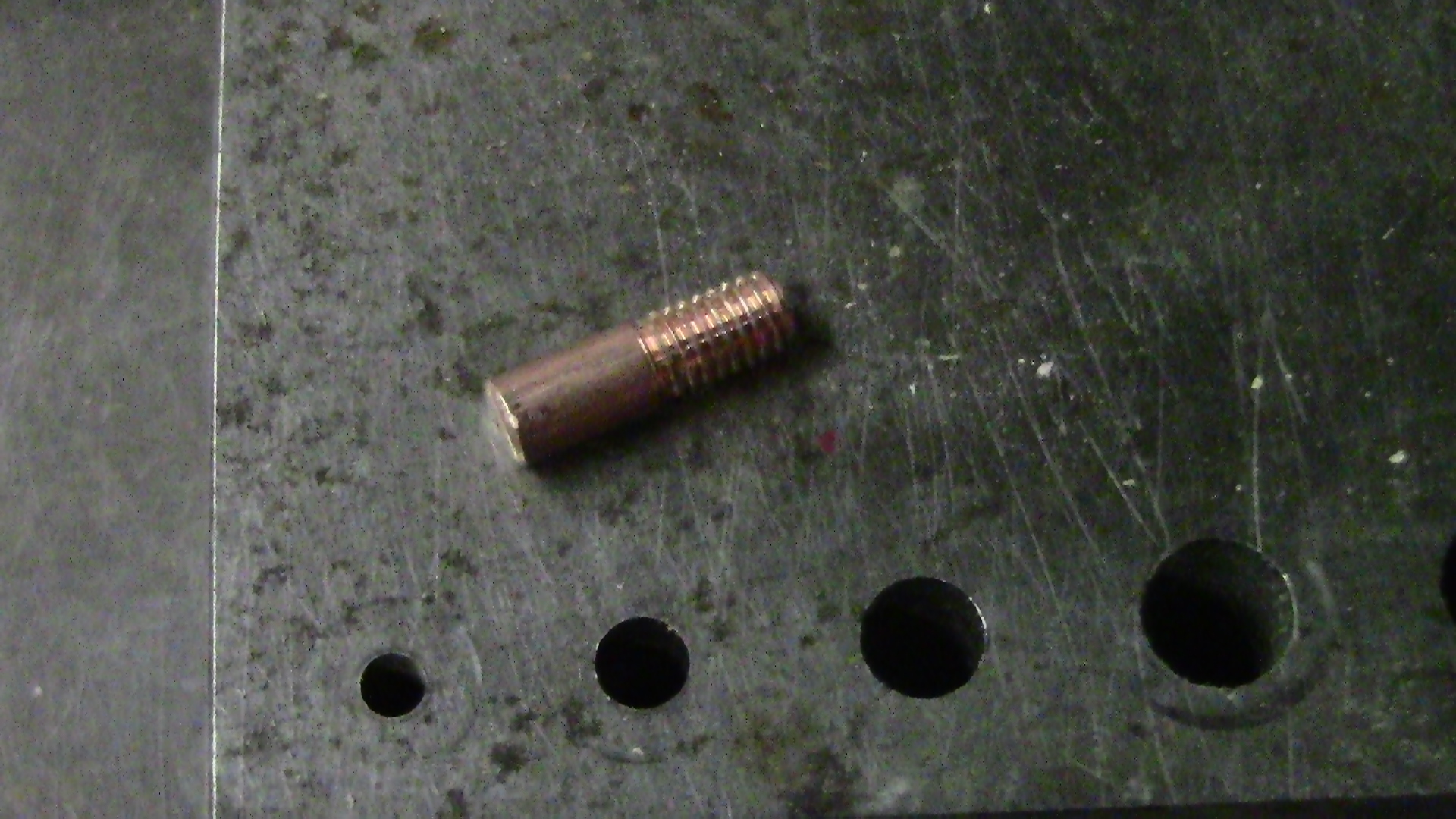

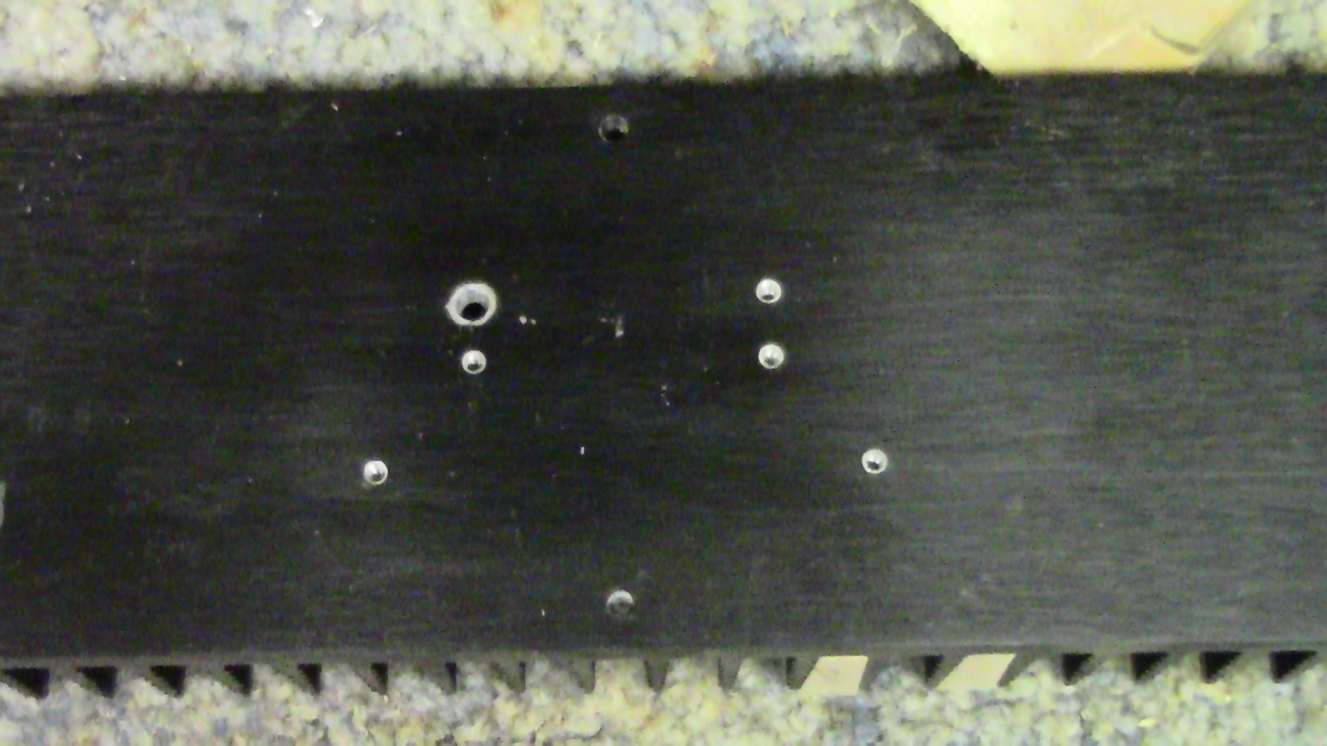

I got the tap out 🙂
I will post more pictures later when I am not hurrying to work. But I wanted to run this idea by You.
I found a solid copper plug with a tiny pin sized hole that is just slightly larger then the new hole, it would be a perfect plug. I know copper has slightly different properties with heat, as it does not dissipate heat as well as aluminum, but maybe in this case, it will work just as well.
Is this a good option, or should I stick with finding an aluminum plug or rod?

Allen,
Good to see you're back on track.
If you look at high end heat sinks for CPUs, you'll find that they often come with a copper base and aluminum fins. AFAIK something to with copper being better at transferring the heat from the chip to itself, and aluminum having better properties (also cheaper) at dissipating.
So you should be good with a copper plug. 🙂
