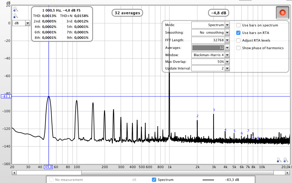

Hi guys,
I m done with the power up sequence and some heating 🙂
well with hype 62Volt, the 2U heatsink x 300m rise to 57°C ...
I ve played with some fft and the PSRR and the hyper together gives a pretty nice graph. But could you just confirm that this graph looks ok from your experience ? (0db is 4.5V out put of amp) which gives roughly a 300uV for 50hz.
If you confirm then all is fine.
Thanks in advance

hi guys sorry to bother you with this, originally I just wanted to get an acknowledgment about the figures which I got by a first bunch of mesure to make sure that the cabling doesn't destroy some standard figures.
After the night, and some tuning of the bench (earth and 0V signal to earth, it appears that the graph posted above (can't delete it) is not representative for the 50hz and 150hz as they are also present even if I remove the +-64V faston :cheeky: also the graph shows rays at 2k and 3k and they do come from the measurement device (a bit old EMU0404) so dont mind
ok, so at the moment, I figure out that the 100hz and 200hz ray coming from the SMPS is rejected by the FO to a point where I still get it at the output for less than 125uV (-91db on a new graph). so this looks fine for me to move forward with the next step here which is to post some listening impressions 🙂

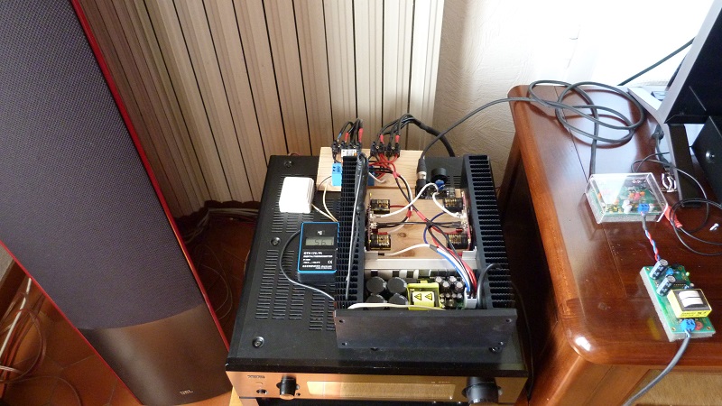

Hi there,
here we go, FO 1.4 is in situ in the living room and connected (biwiring) to a pair of great (but not officialy in the "hifi" range) JBL LS80 (3.5 way with 2 x8") for 3 hours ago now
what to say ... despite the nice spring wether outside, I m just stuck in the sofa. you know this feeling if you do DIY for some year : one day you plug a new component and all of the sudent, it rocks ! you cant stop putting all your CDs and you feet seems to have a direct cabling with the woofer . you see what I mean.
Well the firstone experience is even beter than that. in addition to that your body feel very proud and you smile for some minutes with a feeling of "yeess, I got it".
Yeah the firstone is just amaizing. Deep and very clear bass, no any noise whatsoever, so clear but not bright. very very good. you feel that music is just natural as it should be.
So good I m now hesitating to build a second one for biamping, as this is already amaizing good in stereo with a single hypex ! the only drawback of my config (2Ux300mm) is that temperature stabilize at 57°C and rises to 59°C at relatively loud level...

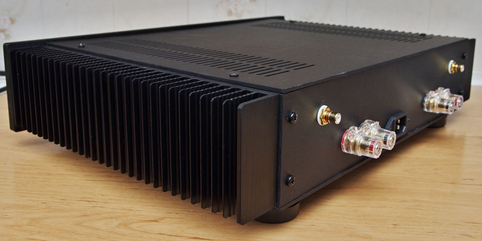

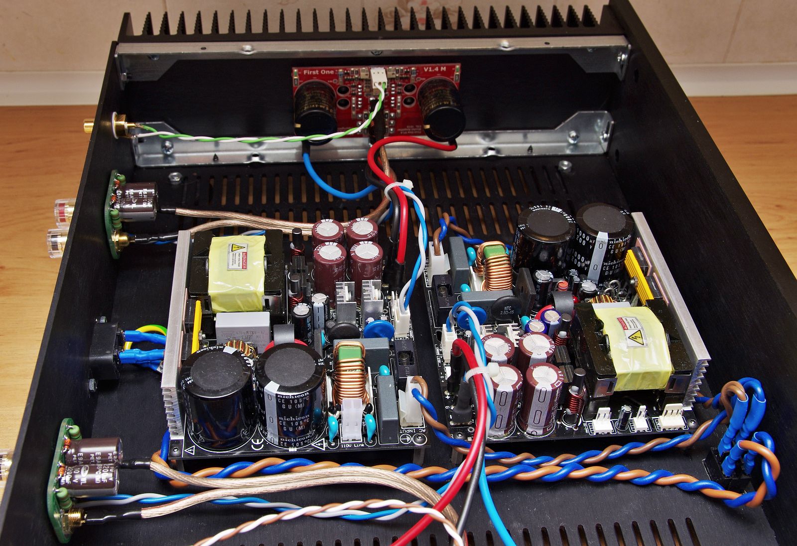

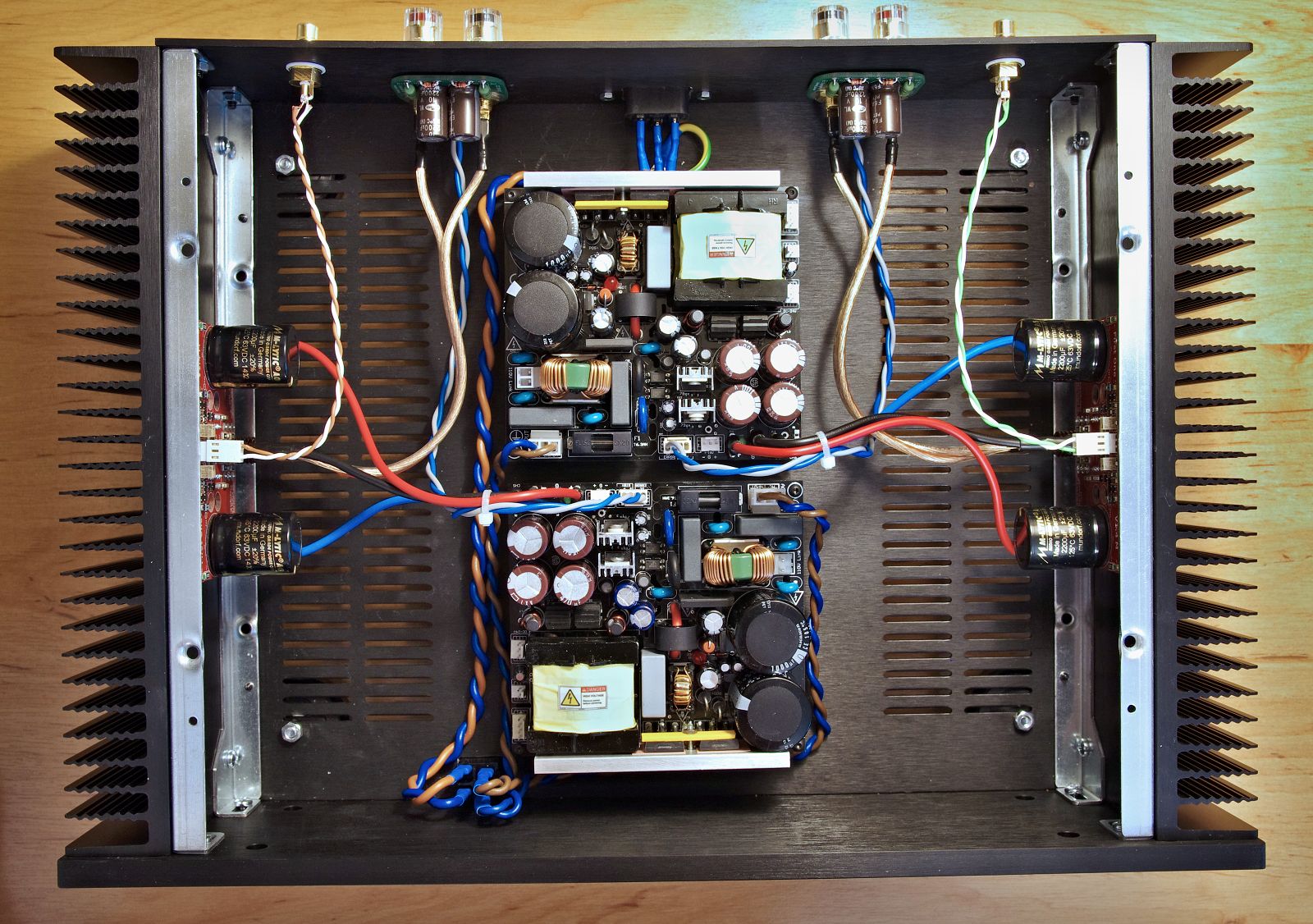

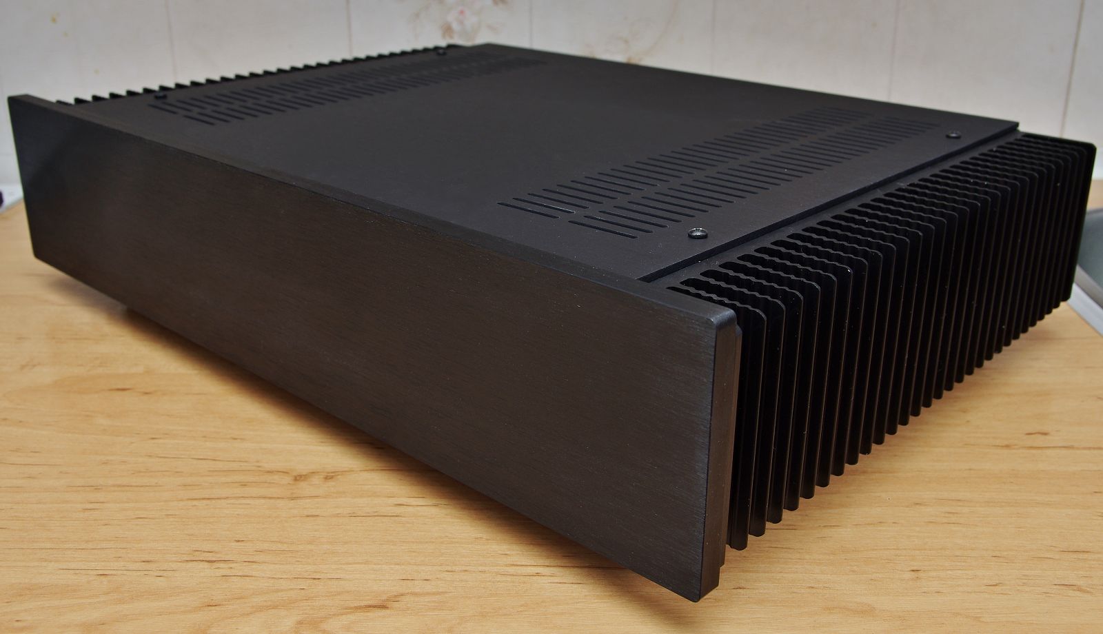

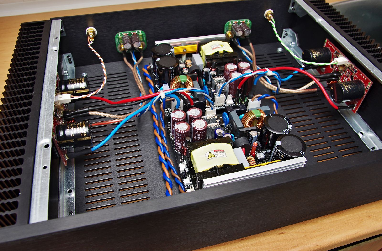

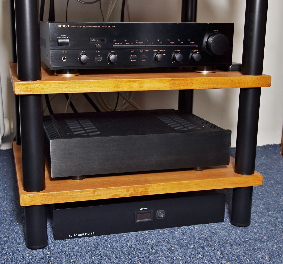

Hi, I greet all,
I would like also add to the lucky owners of this great amplifier.
I finished building my FO 1.4. I used all-aluminum chassis 2U 300mm, that it fits perfectly.
The temperature on the radiator near the FO module ranges from 40 to 45 ° C, it is great. :up:
Two SMPS power supply (+/-55V) are from Cresnet (thanks Sami).
Everything works perfectly. Now I just listen to music and I'm happy :happy1:
Now before me I have no speakers, but singers and instruments 🙂 😎
Thanks LC :worship:
Robert
