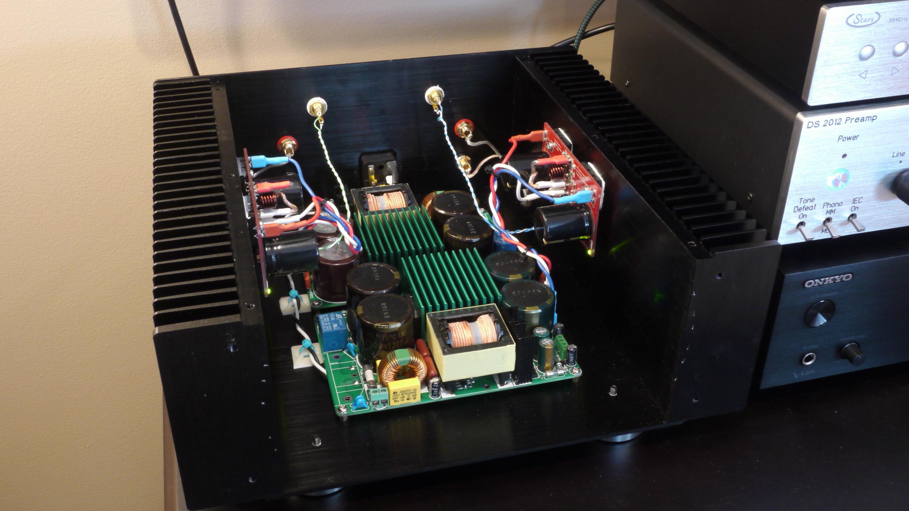

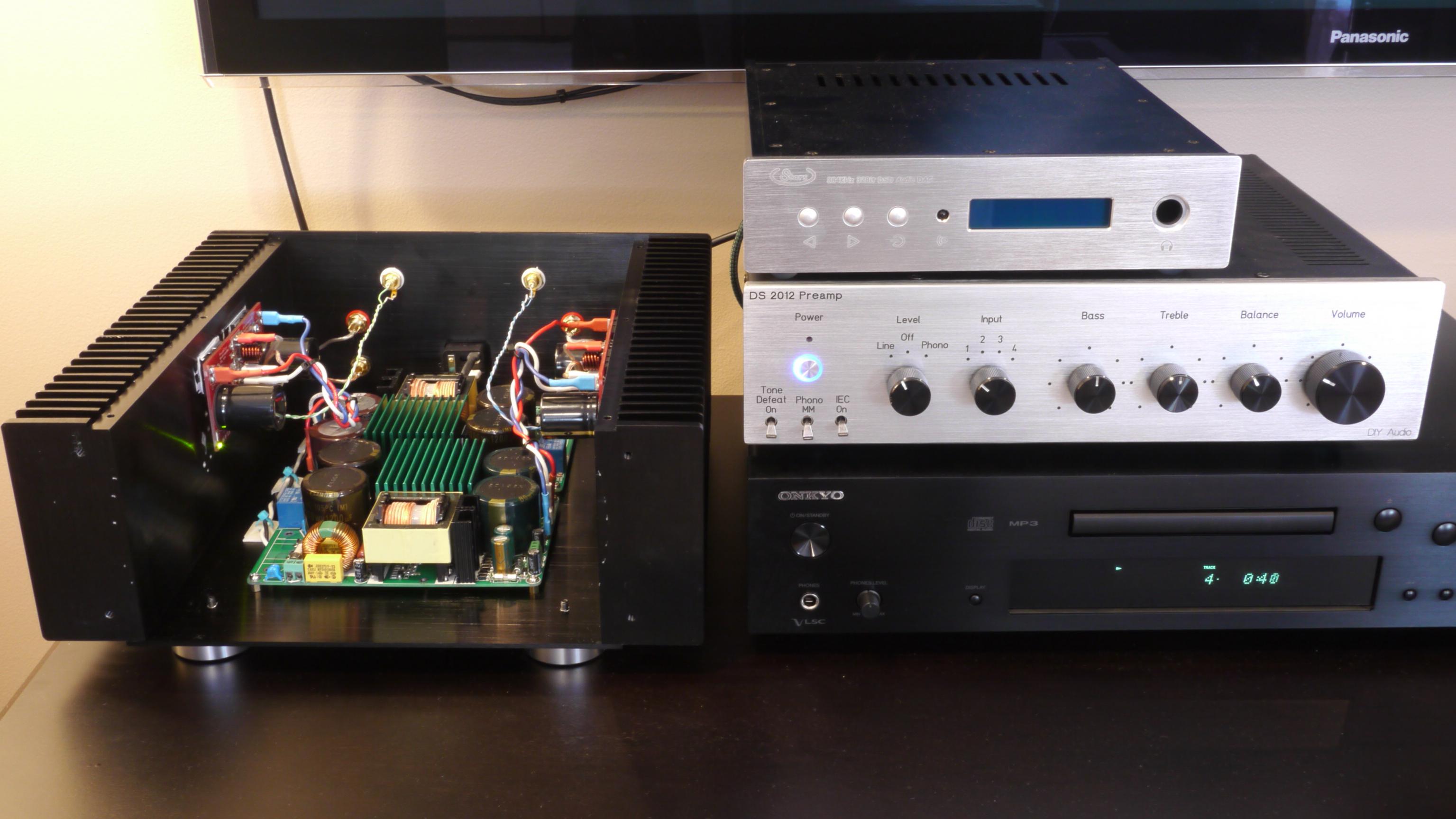

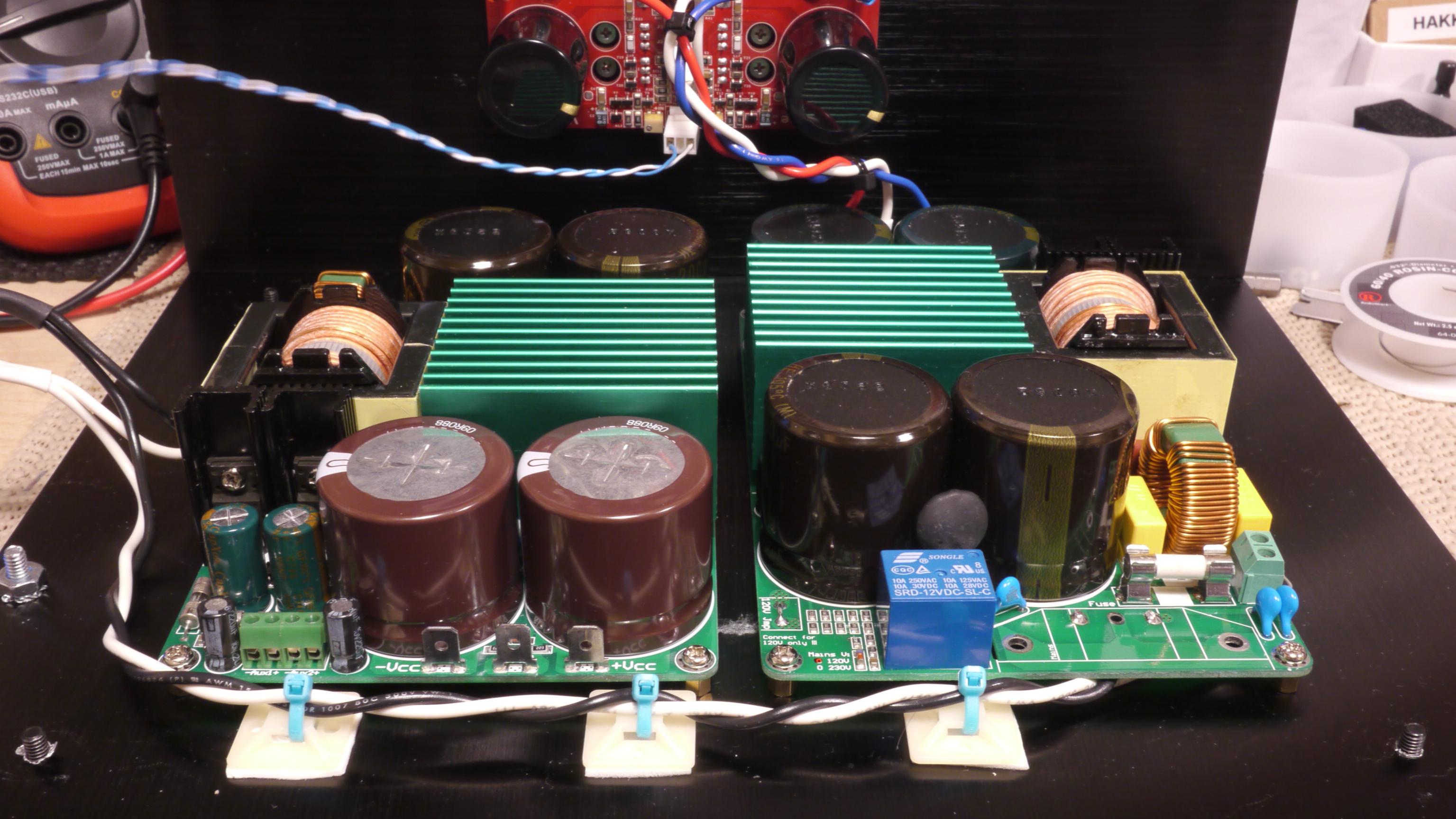

I put the FO amp into temporary service this morning in my listening room. All I can say is WOW! I thought my last amp (LM4780) added a great sense of dimension, clarity and space to the music. Well, I would be wrong. This amp is absolutely one the best DIY amps I've heard and moves to the top spot so far. I'm warming it up as I write this using my goto all acoustic instruments CD and they sound as if they were all onstage at the end of my room. It's that good. :) The strings are reproduced with fullness and clarity and the highs are effortless and smooth. Vocals are equally clear and simply pour out of the full sound-stage. And there's plenty of solid and faithfully reproduced bass as well. Actually I'm surprised with how solid the punch of bass is when it is called upon to be reproduced. And I don't have a sub-woofer hooked up to this particular rig.

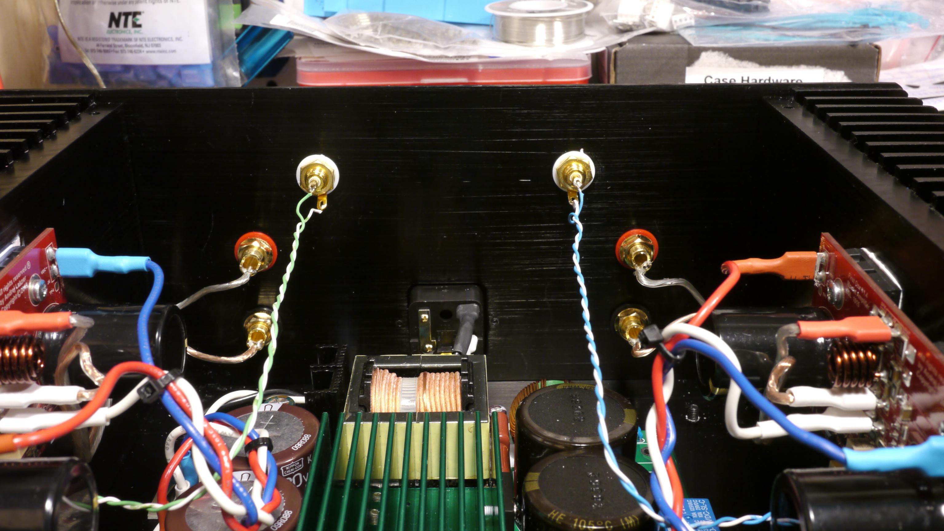

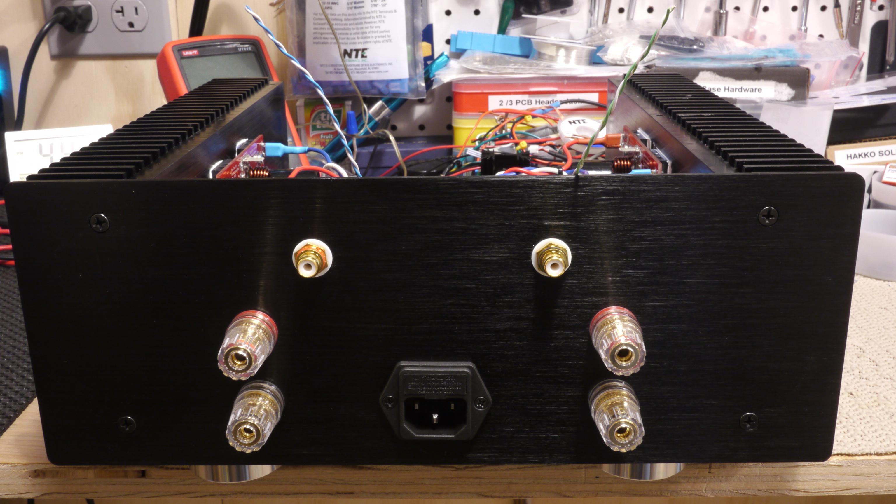

Attached are pics of the wiring I finished up. It's not totally done yet, as the front panel needs a switch and other custom milling for meters. I'm using it with an Onkyo C-7030 CD player, DIY Doug Self 2012 preamp, and Energy, Reference Connoisseur RC-30 speakers. Sounds marvelous. :D Even at moderate listening levels the heatsinks are barely warm. A tad warmer around the output devices. Oh, did I say this amp - right out of the box - is super quiet and I simply hear no hum. No tinkering needed here folks - unless of course you want to. There's not much to improve on! :)
Thanks LC for an exciting new amp. You've given the DIY community an amp module that is affordable and sonic qualities that are unmatched. All you need to add is a PSU and a few hookup wires and you've got one fantastic sounding amp. More listening later today.
Rick

Redjr ...nice job.
Just one hint to you and other. Instal modules 180o around. You have supply wires under and input wires up...and signal lines don*t cross supply wires and not goes near capacitors. I got some noise at 1.3 modules when i got with signal lines to close to capacitors. I used twisted cable like you. In your case better useing coaxial one.
Redjr ...nice job.
You are absolutely right. That was my original intention and a concern of mine too. I hate to admit it, but I really botched up my left heat-sink, by breaking off not one, but two drill bits while making the holes. Not my usual high standards. And I didn't want to wait another 2 weeks while I waited for a replacement heat-sink from China. :( In the end, I had to 180 the module for the fit I wanted. And keeping my OCB (Obsessive Compulsive Behavior) :) intact, to keep the symmetry of the inside, I went ahead and mounted the opposite channel 180 too. Not the best thing to do I know.
So far, I haven't noticed any real interference, but the configuration may be causing some issues that I can't hear. Not sure if it it applies to audio, years ago I learned that if you have to have wires in close proximity, cross them at 90 degrees. As you say, I could replace the twisted pair with a good coaxial too. I'll wait and see. Thanks again for the tip.
Rick

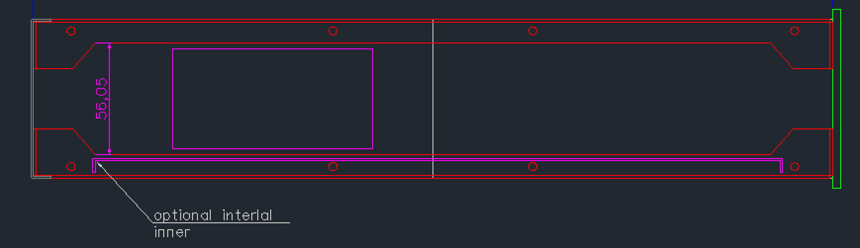

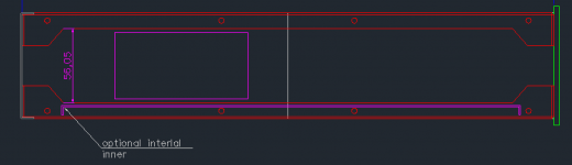

Here is a screenshot of the CAD drawing of a 2U Dissipante case.
There is 56mm between the steel rails which leaves about 3mm on either side of a First One PCB. The Magenta rectangle is the same size as a First One PCB 100 x 50.
