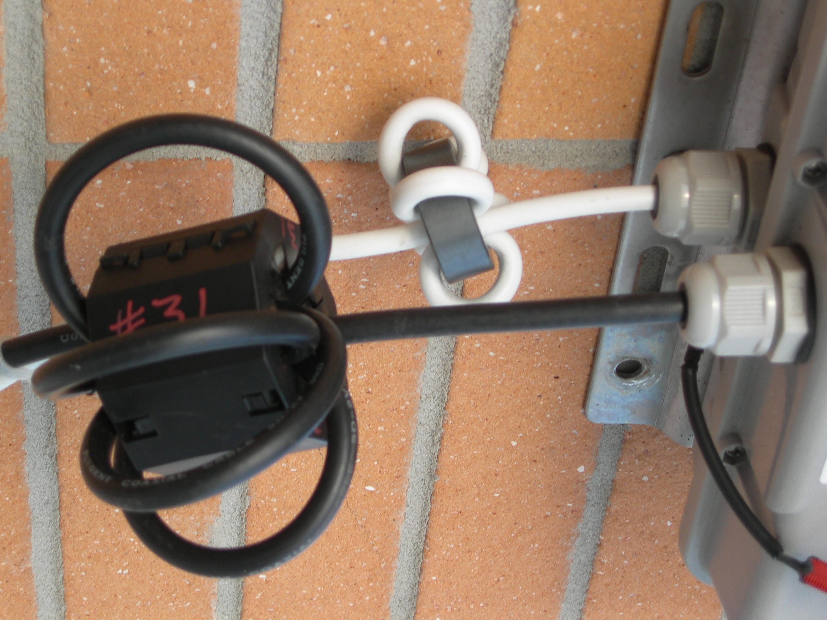

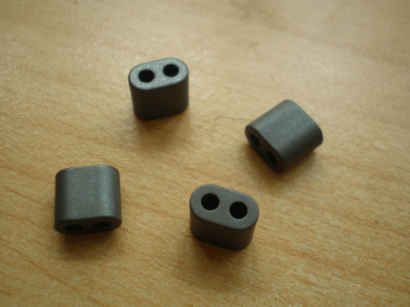

taco,you always could use a pics nose at the power inlet and use a ferrite core at the DC output.
