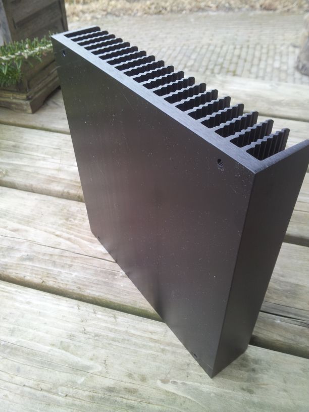

What do you guys think of this heatsink?
I have been entertaining the possibility of piecing together my own chassis.
I like the Dissipante U3 chassis offered at the diyAudio store, however, I really like what Lazy Cat designed, esp in terms of size, specifically height. There is a good chance that I will be building more then one stereo amp. In fact, I can easily see having three to four power amps powering my dream 4.4 system. So for the sake of space and air circulation, I would prefer to find ways to lessen the height of my chassis.
I learned quite a bit about heatsinks from this article by Rod Elliott, ESP:
ESP - Heatsink design and transistor mounting
It is amazing how many heatsinks have the fins going the wrong way! :eek:
I also came across a First One build in progress at HiFiDuino. Scroll about half way down, and there are some additional ideas about selecting heatsinks, esp estimating C/W or K/W visually using examples from fischerelektronik:
https://hifiduino.wordpress.com/category/amplification/
The main difference I see between the Dissipante 3U and Lazy's Chassis, is Lazy used a heatsink with higher fins which allows a slimmer chassis height.
As I can not find anything with a 300 mm length here in the US, I am limited to 250-260 mm, which means I need to consider atleast 100 mm overall chassis height - which is 30 mm less then the Dissipante height. Four chassis at 100 mm each (total 400 mm) is only 10 mm higher then three 3U dissipante at 130 each (total 390 mm). See where I am going?
I do know heatsink length is more effective then heatsink height, but with the First One mosfets being so centralized, is the length as effective?
Also, being the First One mosfets are so centralized, would this particular amp module benefit from a heatsink with a thicker baseplate? Not much is mentioned in the resources above about baseplate thickness.
I found a 260 X 200 mm heatsink on ebay, that looks really nice. My plan would be to cut it in half for two 260 X 100 mm pieces, one for each module. Note the 16 mm baseplate.

Hi Allen
If you would be using SMPS1200A400, no additional mains filter is needed, onboard filter already present and serves the purpose very well, since there's no sign of any HF disturbances on any appliances anywhere I use or brought my amps. Also vice versa no mobile phone could disturb or inject HF to either SMPS or First One PCB alone to modulate with symptomatic annoying buzz sound. Connect everything as per User manual schematic, no brainer and it works.
Regarding heatsinks, simple rule of thumb in all cases it has to be 0,5K/W max. and the wider it is, the thicker base plate it has to have. Since I like slim cases SK157 was my preferred choice and SK519 for monoblock chassis. Check the prices at Fischer Elektronik, I think they'll be competitive also in US.
Regards, L.C. :cheers:

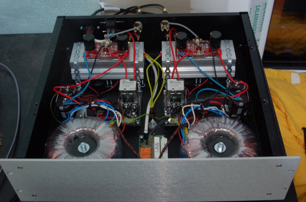

Hi LC and others.
Attaching the photo of my FO implementation.
- 2x linear PSU (2 x 500VA), with total of 40mF capacitors, + softstart
- DC protection and delayed speakers connecting modules with >30A relays
- active cooling -> ~0.4 K/W

Hi PAX1
Perfect dual-mono with linear PSU, congratulations. Hopefully fans are silent ones with temperature on switch, maybe even with speed control. Calibration check would be easy since modules are in horizontal position, certainly perform measurements after heatsinks gets warm to app. 40-45°C.
Do not spare us with sound quality report of course after burn-in period is over.

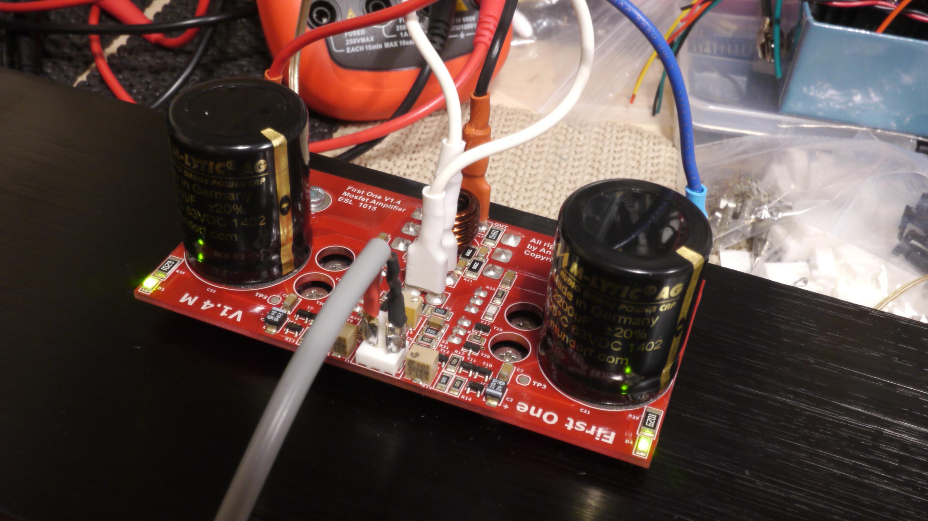

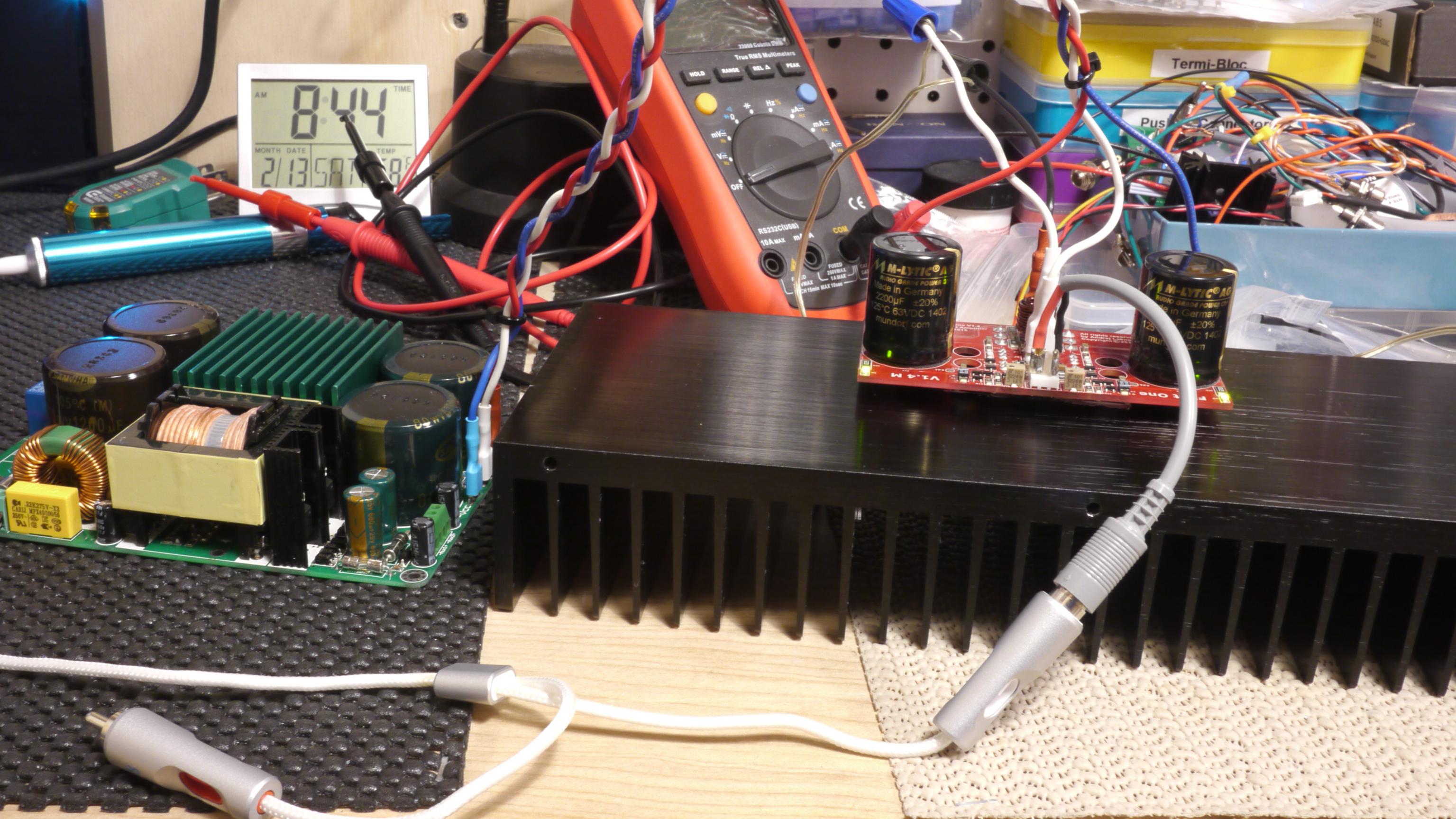

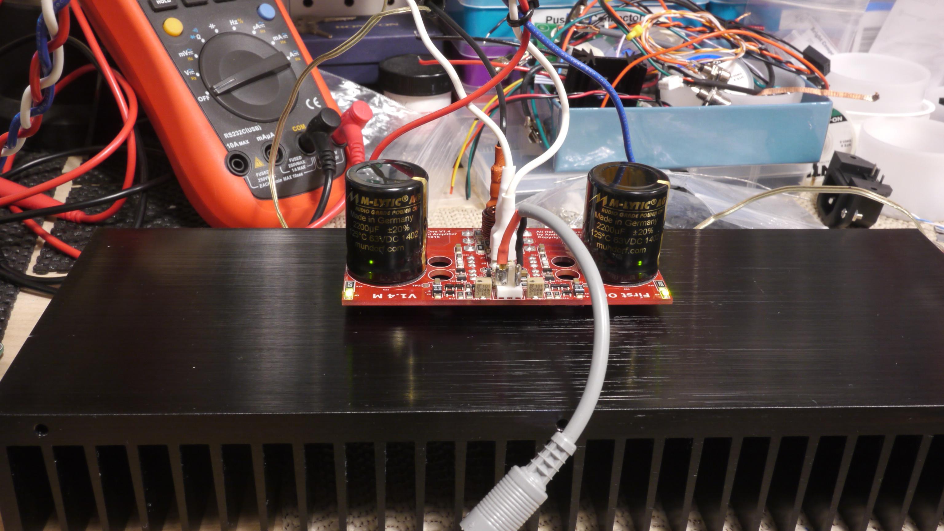

Hello all,
Here are few early pictures of my testing the FO modules this morning early. With very limited time on my bench but they sound so sweeeeeeet. And I haven't adjusted anything yet! I may not they sound so good. Just made sure there was no DC on the output. I'm using the SMPS800RE x 2 from Connexelectronic. Been very happy with his SMPSs over the years. True quality builds.
More testing and pics of my 'first' FO amp build to come. :)
Rick
