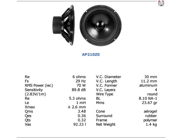

Here's the data for the woofer..

Thanks for your interest and yes I already own these drivers and bought them as I thought it would be a fairly inexpensive first project.
I was thinking along the lines of a small (ish) floorstander. When I have used formulas from Vance Dickassons cookbook, based on the T/S parameters supplied by Audax, a cabinet of 42litres was specified for a tuning frequency of about 37Hz.
I was planning on using 1inch Mdf for the baffle and 0.75inch plywood for the remainder of the cabinet.
For obvious reasons I would like to stick to using these drivers, even if they may have been the wrong choice. At the time of purchase I did not have a great range to choose from as I did not have the internet.
Gareth

If that's the case, I'd be pleased to model a box and a crossover to help you out. As for the cabinet, what's your preferred height?
Jay, thanks for your offer of support anf to be honest after reading all these posts I think I just might take you up on your offer.
I already have a basic knowledge of what the different crossovers are cabable of, their roll-off's, phase change ( up to 360° ) etc etc which is why I needed to ask about the drivers I have.
If the offer still stands I would very much appreciate your help.
Thankyou
Gareth
