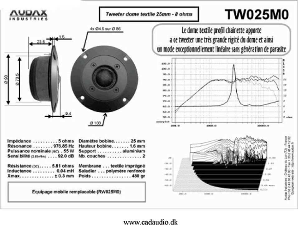

I am building my first speaker. It will be a two-way bass-reflex design using an Audax AP210Z0 8inch woofer and an Audax TW025M0 tweeter.
I want to build a simple first-order Butterworth crossover for these drivers. I was thinking of crossing over the drivers at 2000Hz. Looking at the manufacturers data for the tweeter it says that the resonant frequency is 976Hz but looking at the supplied graph there is a resonant peak at around 2700Hz of about 25-27ohms.
Does anyone know if this peak will cause problems and if my design is viable? If not are there any suggestions that can be given?

Hi gareth,
Welcome and congratulations on your project. There are several issues here, and please take all comments you get as help and not criticism.
First, 2-way designs with an 8" woofer are rare and difficult to pull off - they're out there, but again they are few and far between. They usually require high order (steep) crossovers that can be quite complex, with many components, and thus expensive. This is because the operable frequency ranges of the drivers don't have a good overlap - either the tweeter has to operate at very low frequencies, or the woofer has to operate at very high, or both.
This brings me to my second observation about your design - a first order crossover in this case, especially for the tweeter, seems to be quite inadequate, so I must ask, how did you arrive at this design? Is it something you actually researched or modelled with software, or simply what you want to do? I'm afraid that if you build it as stated you will find the drivers distort and the sound quality will not be anywhere near its potential.
Now, I haven't looked up any data on these drivers - I'm opining on the fly here - so perhaps you could post frequency response curves, etc. for a more scientific assessment, but in lieu of that I have to agree with MaVo that you should consider building an established design for your first project - this is the most commonly given advice here for beginners, and most others too!
If you've already bought the drivers then you should, or have someone, model an appropriate crossover for them, if it's possible.

Since you already have those drivers, you might want to consider adding a 3rd small midrange to each?
Starting with a good sized bump at 1.5Khz the rest of the high FR of the 8" drivers is pretty rough:
http://www.partsexpress.com/pdf/296-175g.pdf
Also, HF output will be very directional on a woofer that large.
I couldn't find the FR graph of the TW025M0.

Thanks, I was beginning to think that someone might say that a three way would be the way forward. I appreciate your advice.
I will make a .jpg available containing the data for the TW)25M0, the same is available for the AP210Z0 if needed. I hope the quality of the .jpg is OK
Will the three way be much harder to design? I have a pair of Wharfdale 4" mid-bass units which I could incorporate or perhaps I should look for other drivers.

The tweeter spec sheet you posted looks strange. Near 3 kHz resonance peak for a 1" dome tweeter w/ a rear chamber? Something must be wrong. I think the 977 Hz Fs on the spec list should be the correct number. The impedance plot seems not correct.

I was thinking the same thing in that the resonant peak near 3000Hz and that the quoted resonant frequency (fs) are not the same.
What would you suggest?
The bass driver, AP210Z0, seems to have a fairly flat response up to about 2000Hz and a sensitivity of 89dB. Maybe I will use a 2.5 - 3dB attenuator with the tweeter.
