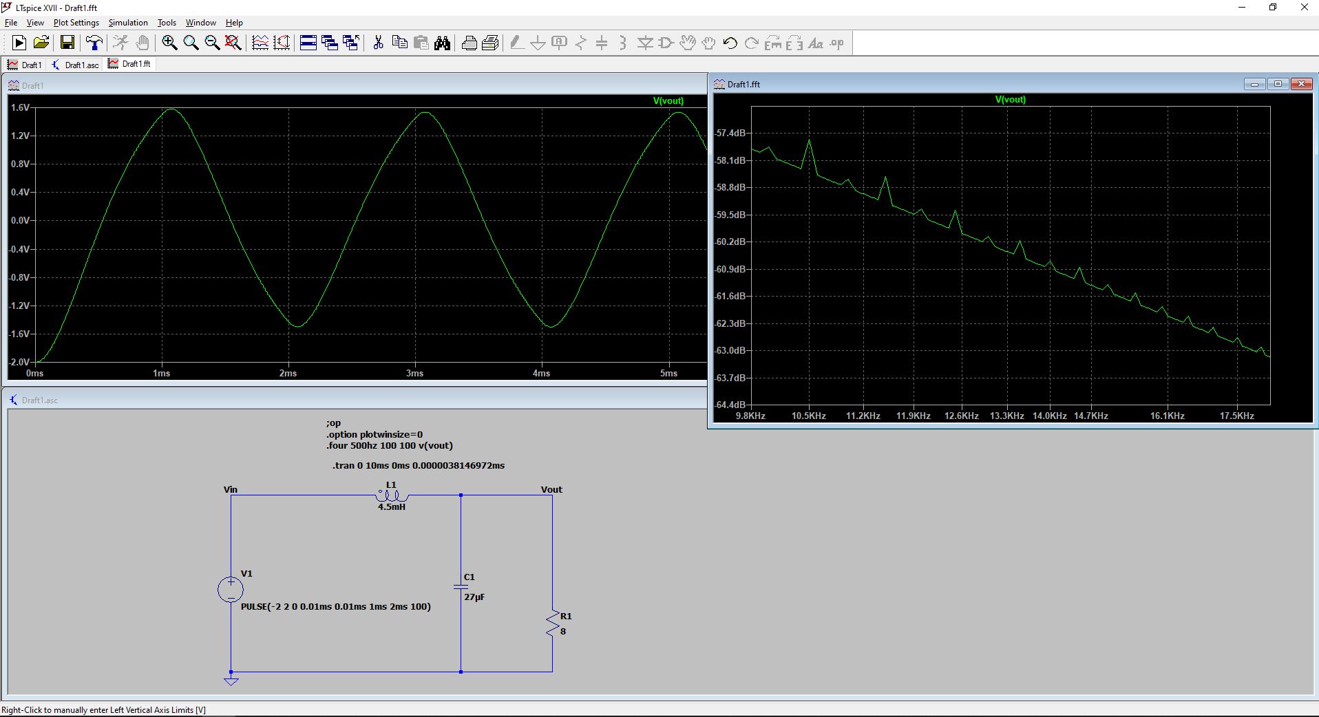

I am not an expert at LTSpice. I only have a very superficial understanding of how it works. So please go ahead and tell me everything I have failed miserably at in a condesending manner. It is easier then testing it yourself on your own computer or pointing it out in way that I could actually learn something from.
Here I have run a 500 Hz square wave through a 12 dB/octave 500 Hz LP filter.
There are harmonics way above the noise floor all the way up to 20 Khz - even though it is low pass filtered. A 500 Hz sinewave does not show any harmonics above the fundamental as expected.
Can't see anything wrong with this. Of course you see the square wave harmonics above 500Hz because your filter is 12dB/octave, so that is the rate they diminish with rising frequency.

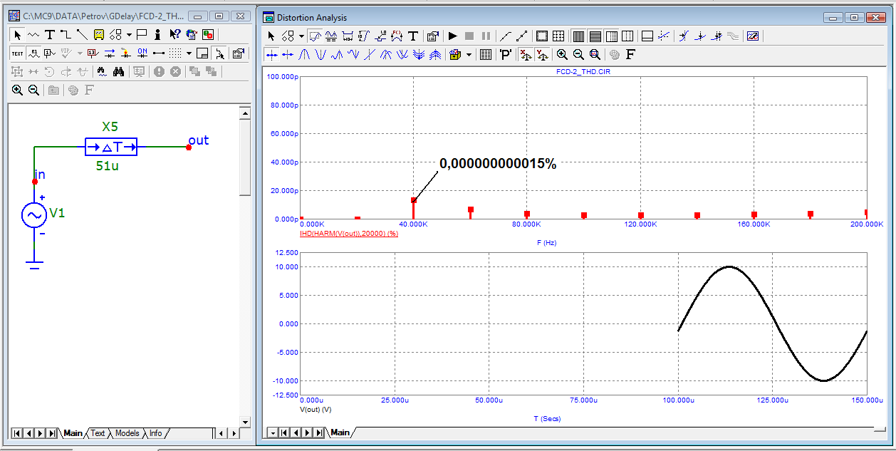

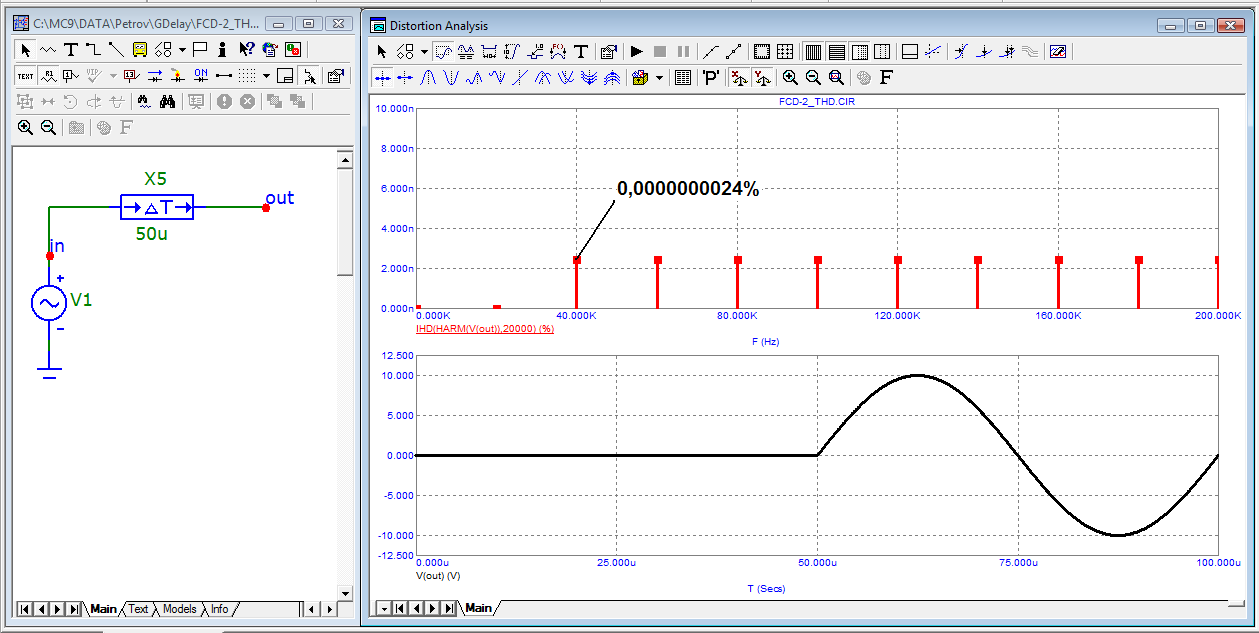

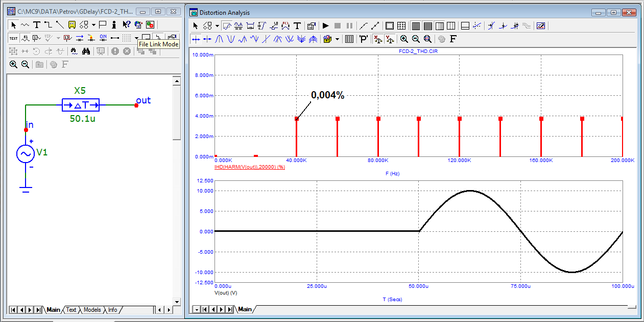

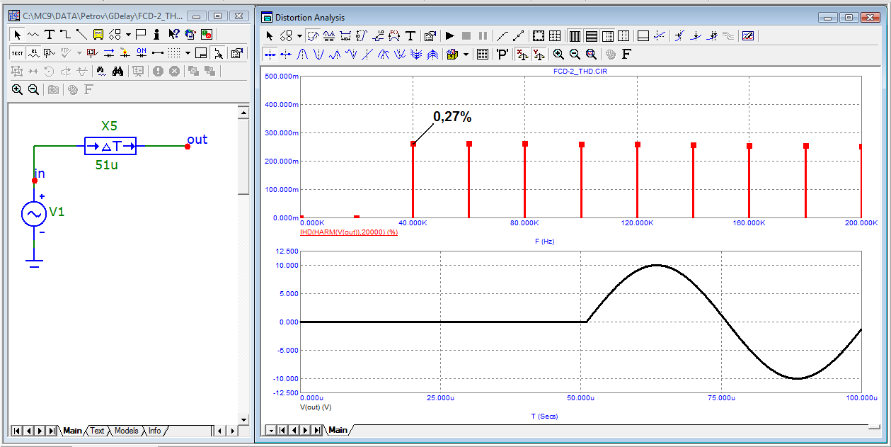

When my colleagues start telling me about the distortions of the first period in the simulator, I immediately understand that this colleague has no idea how the simulator works, in particular Microcap. For information: the program counts according to the last period from the burst that we set for analysis. If we set a burst of five periods, then the program will make a test for the 5th period by substituting it multiple times in front and behind so that the signal turns into a periodic one. The program does not pay attention to the phase of the signal, it is important that the period is whole. That's all you need to understand. The program works in the same way for the first period.

For information: the program counts according to the last period from the burst that we set for analysis. If we set a burst of five periods, then the program will make a test for the 5th period by substituting it multiple times in front and behind so that the signal turns into a periodic one. .
I don't think that is correct. It doesn't substitute anything. If it did, you could never see the evolution of a signal over time.
