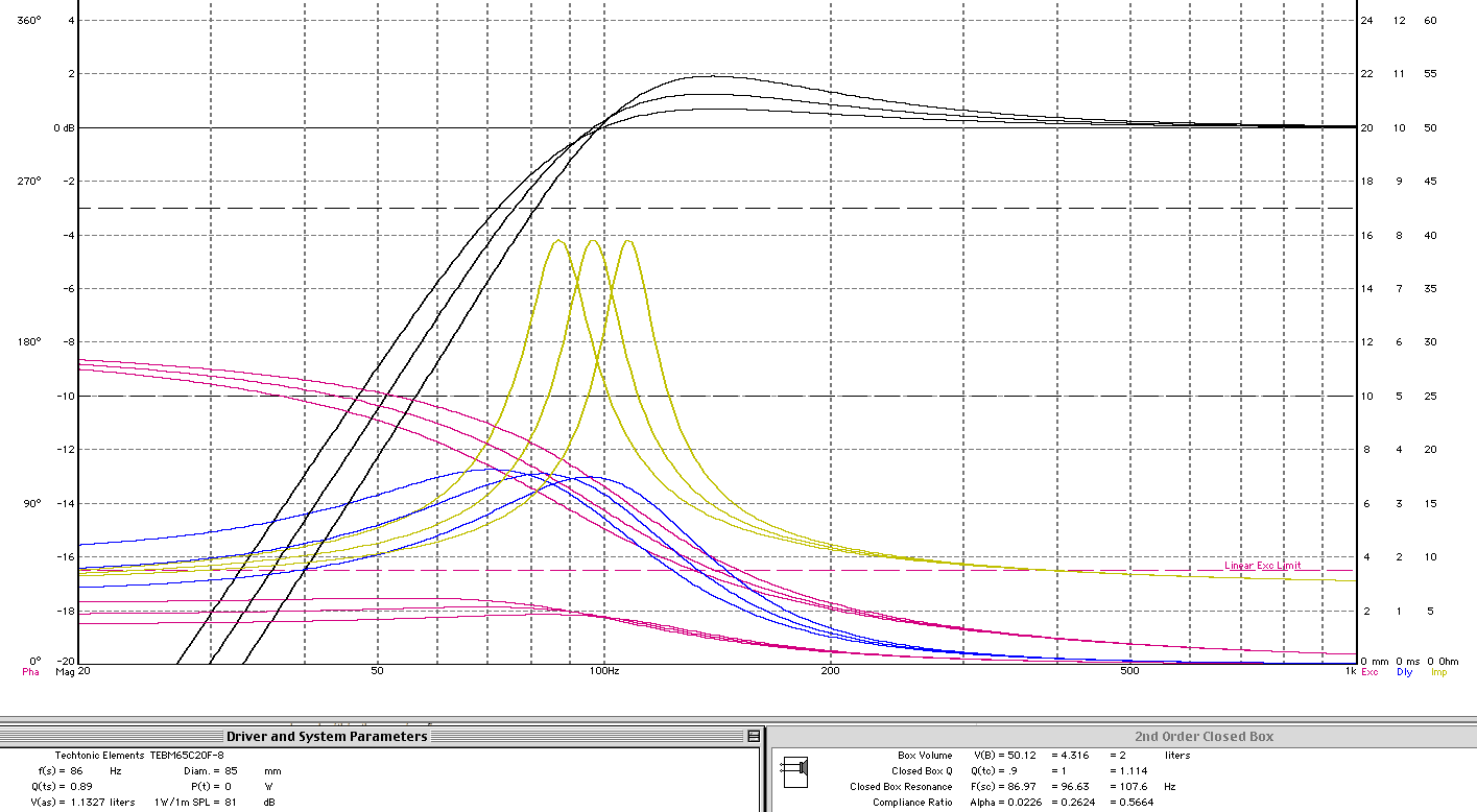

can i ask what you mean about the 'high q'? and what this means?
The Q is, in short, the shape of the roll-off of the box with driver. The end Q of the box is (almost) always higher than the Q of the driver in free air. The spec for the driver is 0.89 so that is as low as you can get -- that would take an infinite size box (in practise you can get real close in a lot smaller box than that).
A box with Q = 0.707 is max flat, 0.5 is considered as low as you want to go, 1.0 as high as you really want. Anything higher than 0.707 starts to put a bump at the low end before it rolls off, not all that bad a thing with a driver like this that doesn't go very low anyway).
As you can see from the attached sim, not a lot of difference between 4 and 50 litre, and i added a sim for 2 litre which is not horrendous. You can see where the biggest box possible comment comes from. Keep in mind damping will increase the apparent box size (say max 20% in practice).

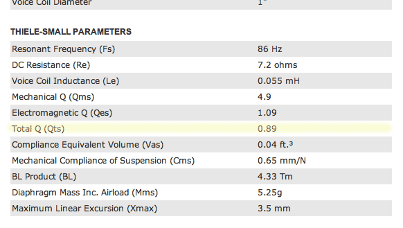

As I noted earlier, it's more than likely at least 1.07, plus combined with a +/- 20 Hz Fs variance, this driver ideally needs either an OB or TL.
GM
I don't ever pay attention to those as they are sometimes wrong, so didn't notice they are the preliminary specs listed on the Aussie site.
I DL the manufacturer specs listed under MANUALS/RESOURCES off to the R.H. side of the page: https://www.parts-express.com/pedocs/specs/297-2156--hibm65c20f-8-data-sheet.pdf
GM

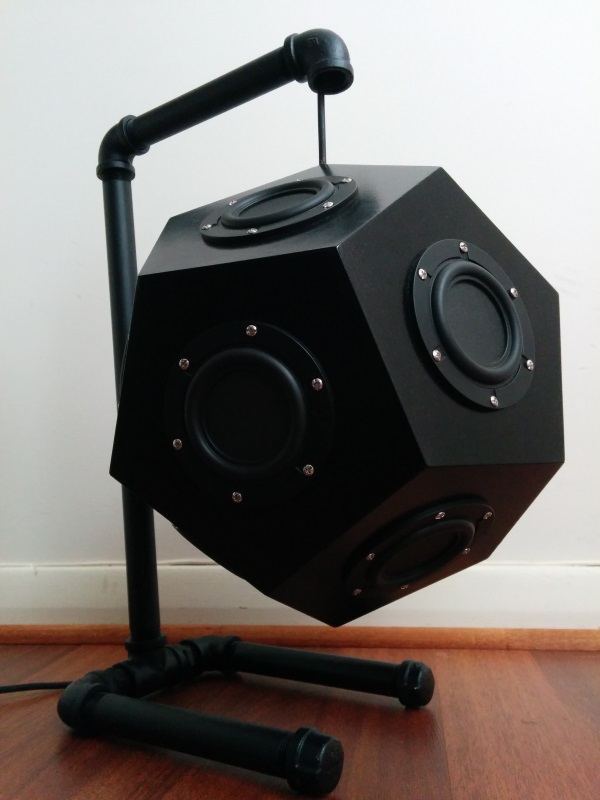

Nice work! How do they sound?
I swear I've seen these somewhere else online?
xrk971
I think it sounds great, it is completely balanced and isolated from any other object so it produces a unique sound that I really like. I thought it would struggle to produce any bass, but it holds its own just fine.
ewollowe
I am not the first person to make a dodecahedron, they are traditionally used as a omnidirectional point source for acoustics analysis. I have seen a few other about on the internet including a 3D printed version and one cast from concrete.
ewollowe
3D printing seems like an obvious solution to irregular shapes like this, but cast concrete - that'd be a very interesting jig
oh, I see it now, casting for each face, then glued up
