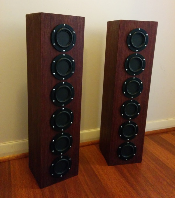

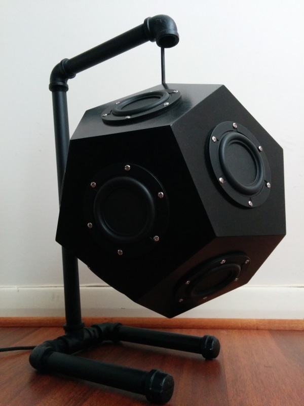

Advice from fellow noob
Hi Paceman 007,
Also new to speaker building myself, I just built a couple of different enclosures using these little Tectonic full range drivers.. (In fact I just joined the forum to show them off today)
I got mine from Parts Express in the US but then found what seem to be the exact same driver with a different sticker on it available in Aus from RS electronics. I stuck 6/12 of them in my enclosures but they seem to have pretty good reviews for single speaker boxes too.
The dodecahedron might be a bit more complicated than you are looking for, but you can not get simpler than 6 timber rectangles screwed and glued together then veneered. I took a few photos of both builds along the way here.
Might be a case of the blind leading the blind, but I think these sound fantastic! Might be tricky to meet the $50 budget unless you skimp on some of the finishing touches like the veneer / paint.
Good luck!
Cheers.

cool stuff HNTE.
Nice find with that driver, good to know they're over here.
Have you had any issues with comb filtering with the mini array?

Thanks ewollowe!
I don't have the right ear to know regarding the comb filtering, they sound better than my old floor standing speakers from JB hifi which cost me an arm and a leg at the time, so I am happy.
I am interested in testing/quantifying their performance (I'm an engineer I like numbers) but I'm not sure where to start, I'll get my google on and see what other people do.
