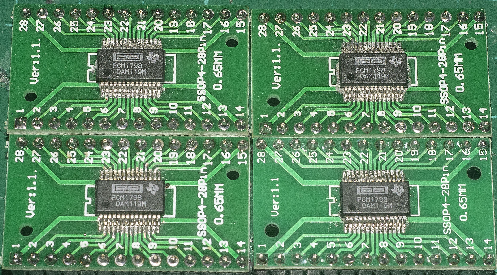

Photo, pins are slightly off the pads but within QA tolerances. I always aim for best practice.Well flux me, Nigel's tip worked. A liberal application of flux was what it needed, all the excess came off onto the copper wick, a real eureka moment.
Thanks Nigel.
You probably want to check for shorts between pins with an ohmmeter, some pins at the bottom row look shorted.

I tried again today, using the paste onto the pins not the pads and a hand iron. Sadly one side is out of line with the pads, so might not work.
I'm just hoping two out of the four work okay, I will go over them pin by pin with the multimeter.

There are special tips,made for this method. They have a concave area at the tip to hold a pool of solder.I took a very good smd soldering course way back and that is what we used,they work very well.Make sure and use flux,always.
Yes, the tip is the secret sauce (plus the flux). With a standard tip it doesn't work. The concave "hole" in the bevel tip allows to add and remove solder at will in seconds. It's so easy it feels like cheating.
