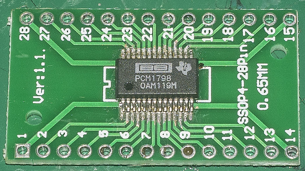

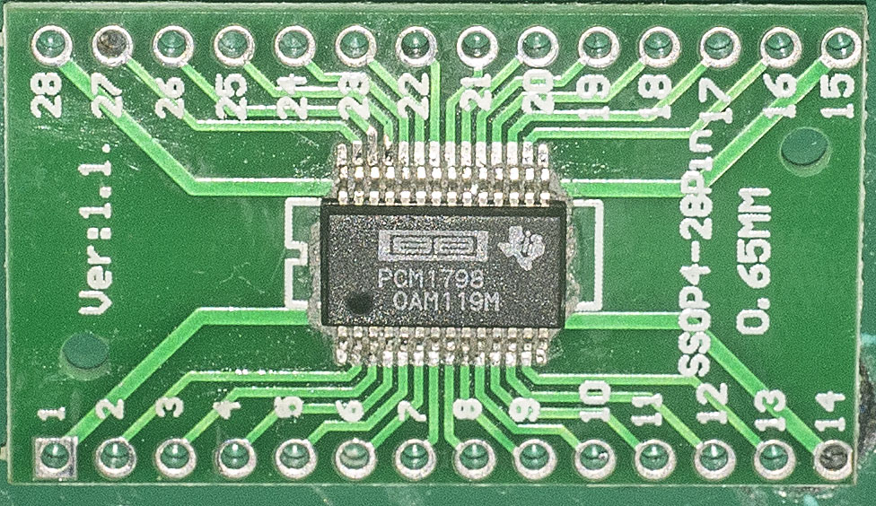

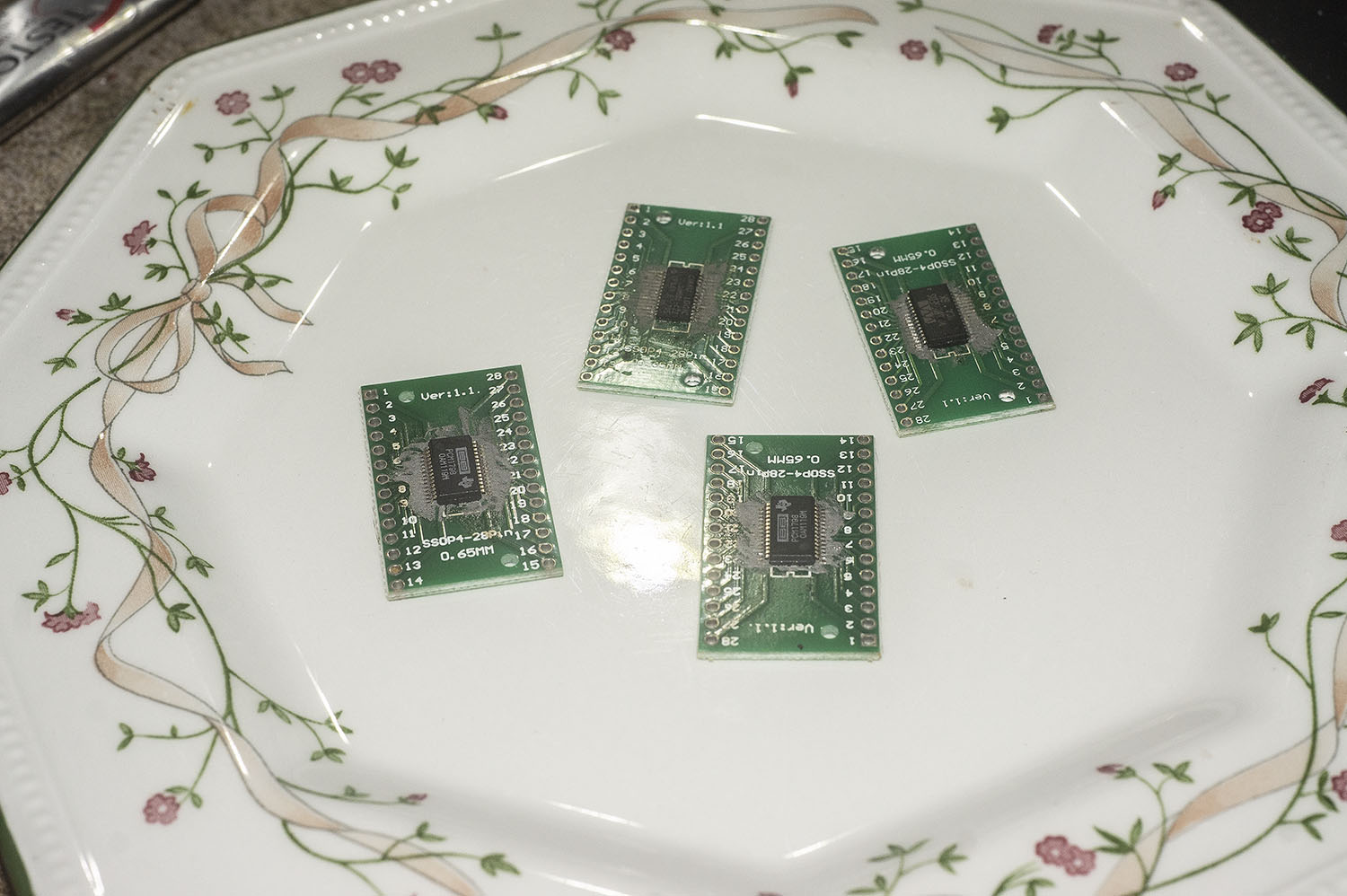

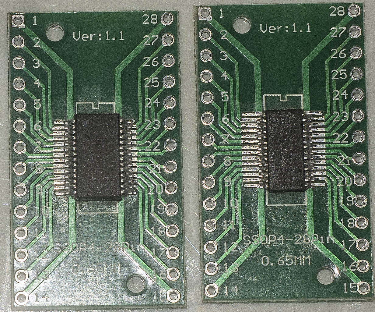

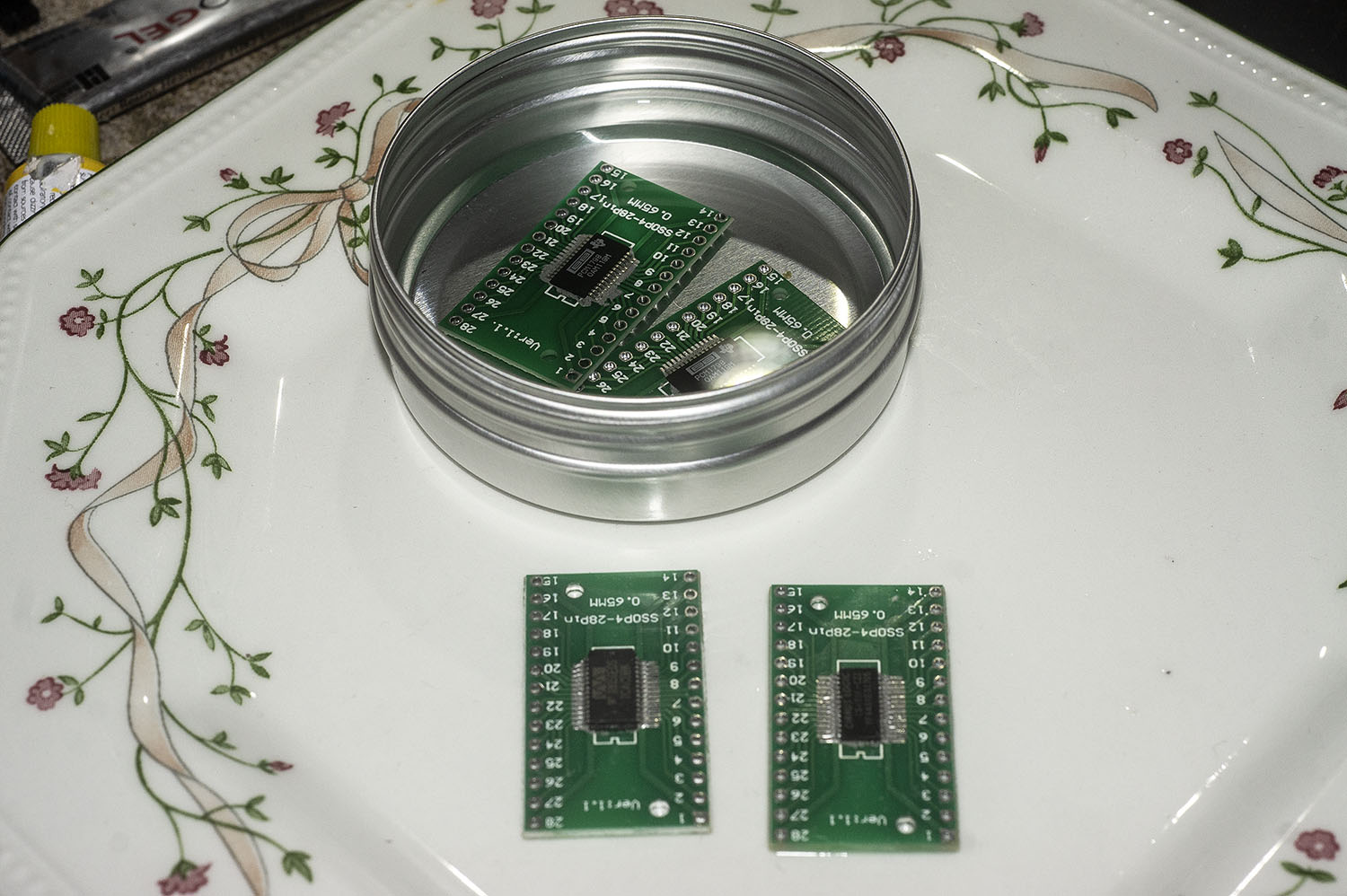

I had a go at using my kitchen oven to reflow solder some DAC chips onto adapter boards and it was only a partial success.
I put on a liberal amount of solder paste and have ended up with the chips securely soldered onto the boards, but a lot of left over solder paste. I tried soaking them in a bath of Isopropyl and scrubbing them with a soft cloth, which took most of the paste off, but there is still loads left in the nooks and crannies.
I take it I need to get rid of all of the leftover paste as it will be somewhat conductive. Question is, how to do it, try different solvents or put them back in the oven?
Three came out aligned nicely, the CS4398 is wonky and will need to be redone.
Next attempt, I take it I need to use as little solder paste as possible? Any tips for applying the paste and how much to use?

Solder paste only needs to be applied to the component pads, the first photo shows way too much solder paste. In a production environment a stencil is used to apply the solder paste.
It seems you managed to clean most of the solder paste off the pcb, I think the best way forward is to either put the boards back in the oven to reflow the solder or to run a soldering iron over the components pins with some solder wick to remove the excess paste. Its difficult to judge from the photos. Solvents wont remove partially melted solder.
Alternatively and this maybe the better way to attack the problem, remove the DAC IC's, remove the solder paste from the pcb with a soldering iron and solder wick and start over with solder paste applied to the component pads only or depending on your soldering technique you could just remove the ic's clean the board and handsolder the ic's back onto the pcb.

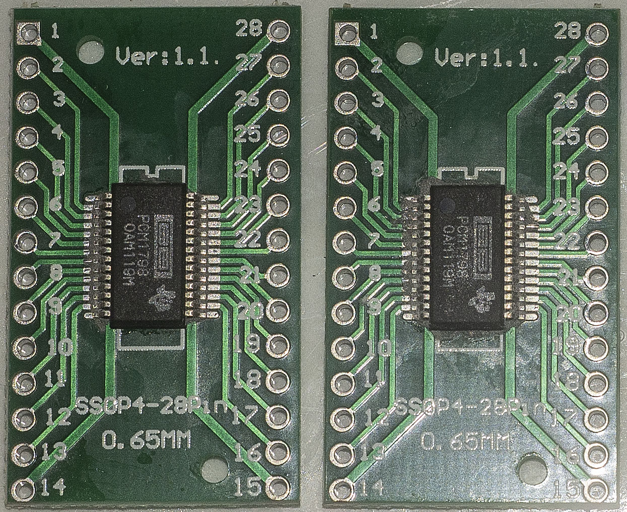

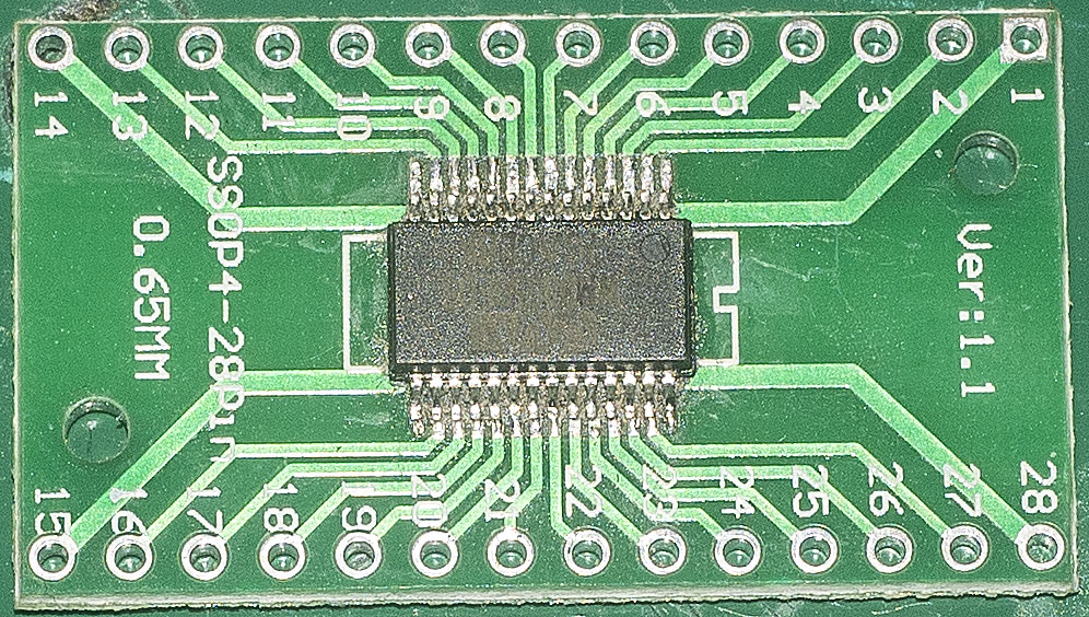

That's exactly how I did it Nigel, I have a pair of PCM1798s here soldered on boards that have bridges that just will not shift despite spending a lot of time with the copper wick trying to clean them up. If you'd like to have them, I'll pop them in the post, you might have more luck than I did.

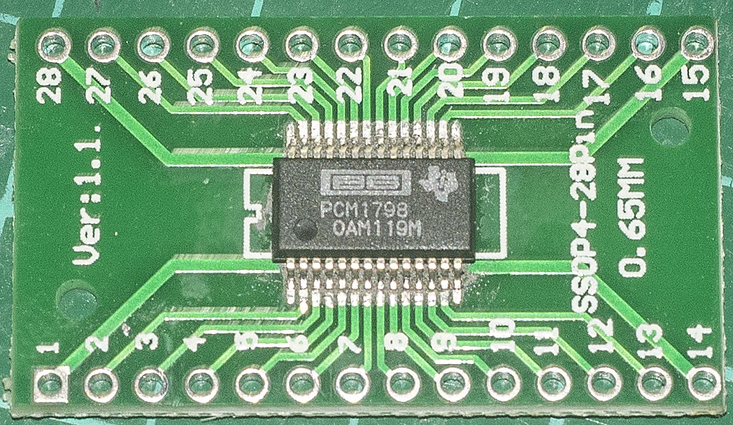

I tried cleaning up the chips I did in the oven with the soldering iron and wick, they have come up quite clean, but there is still some crap lurking underneath, do I need to get rid of every trace of the gunk from the paste? If so, I'll have to remove them from the boards.

I don't think this braid has any flux, it's cheap Chinese 'Goot wick'. No problem though, I have a couple of ancient but still very useful pots of Fluxite.
Well flux me, Nigel's tip worked. A liberal application of flux was what it needed, all the excess came off onto the copper wick, a real eureka moment.
Thanks Nigel.
You probably want to check for shorts between pins with an ohmmeter, some pins at the bottom row look shorted.
