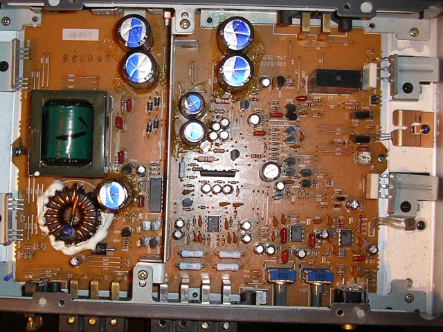

Hey, I've recently got hold of a non working KAC-716. The light comes on, but nothing comes out the speaker output....
Would it be possible to just use the SMPS from it?

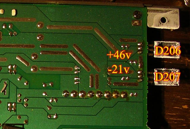

I've just tested the rails on the amp (with no load)...
It seems one of the rails is a little low at -21v. 🙁

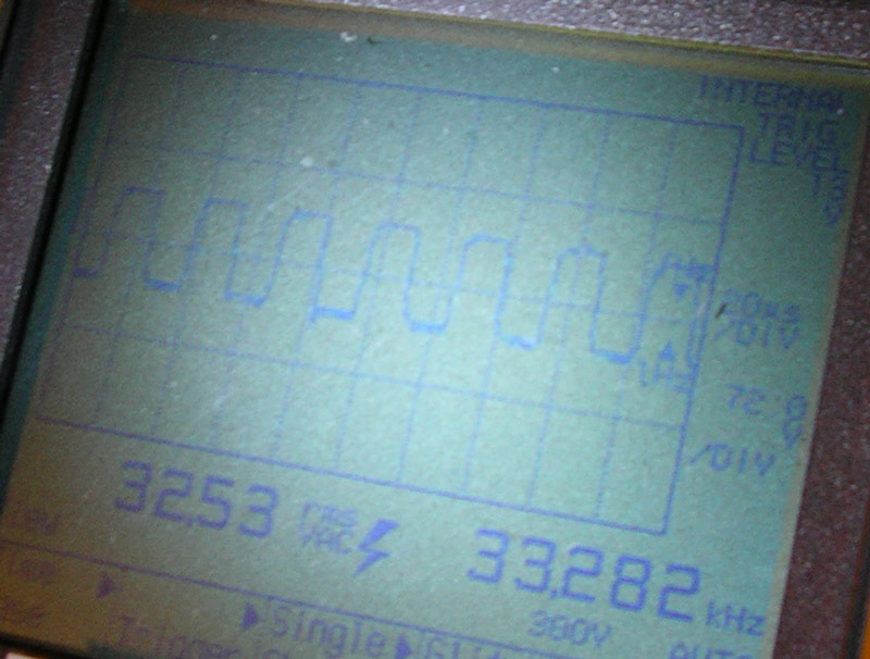

When you say rectifiers do you mean D206 and D207? I've checked the outside legs on D206 and D207, and they are both getting a square wave, 32Vrms @ 33khz according to my Fluke 863.Perry Babin said:Check the legs on the rectifiers. One may be broken.
This is measuring from one of the outside legs to ground. Here is a photo of the wave:
EDIT: Could it be one of the 50v 1500uF caps that has gone?
The voltage on the center leg should be the same as the peak voltage of the square wave on both the top (for the positive rectifier) and the bottom (for the negative rectifier). Is this the case for both rectifiers (yes, D206 and D207)?
Well, the voltage on the center leg of D206 is fine, as it measures as 46v.Perry Babin said:The voltage on the center leg should be the same as the peak voltage of the square wave on both the top (for the positive rectifier) and the bottom (for the negative rectifier). Is this the case for both rectifiers (yes, D206 and D207)?
But the voltage on the center leg D207 is a little low, at -21V, which seems strange. If the rectifier was broken, shouldn't it read 0v?
This is why I think it could possibly be one of the 1500uF caps...

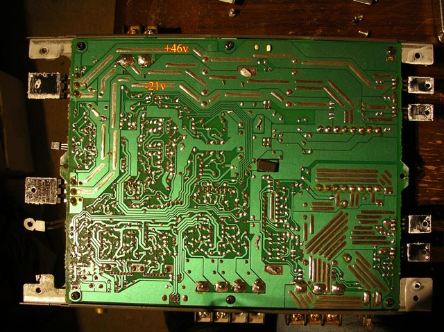

I've blown up the part with the rectifiers to make things a little clearer (I hope). 🙂
If you have the same signal on the outer legs of BOTH rectifiers and the DC on the output of the negative rectifier (on the center leg) is clean (no excessive ripple), the negative rectifier has to be defective.
Well the caps looks visually fine, no bulges or goo... so a bad rectifier makes more sense.Perry Babin said:If you have the same signal on the outer legs of BOTH rectifiers and the DC on the output of the negative rectifier (on the center leg) is clean (no excessive ripple), the negative rectifier has to be defective.
As far as ripple goes, 46v on the middle leg of D206 is pretty ripple free.
The -21v on the middle leg of D207 has a bit of ripple, around 2-4v above and below the -21v line... I'll see if I can get a good pic somehow.

Also, I can quite easily cut to wires on the top of the PCB to isolate the output of D207 from the caps... Would this help at all?

Anyway, I cut the wires linking the centre leg of D207 to the caps, and I'm still getting the same reading... -22v
I'll desolder it tomorrow, and check it out of the circuit.

I've attached a pic of the top of the PCB which may help.... I should be able to get the big metal thing out without a problem tho. 🙂
