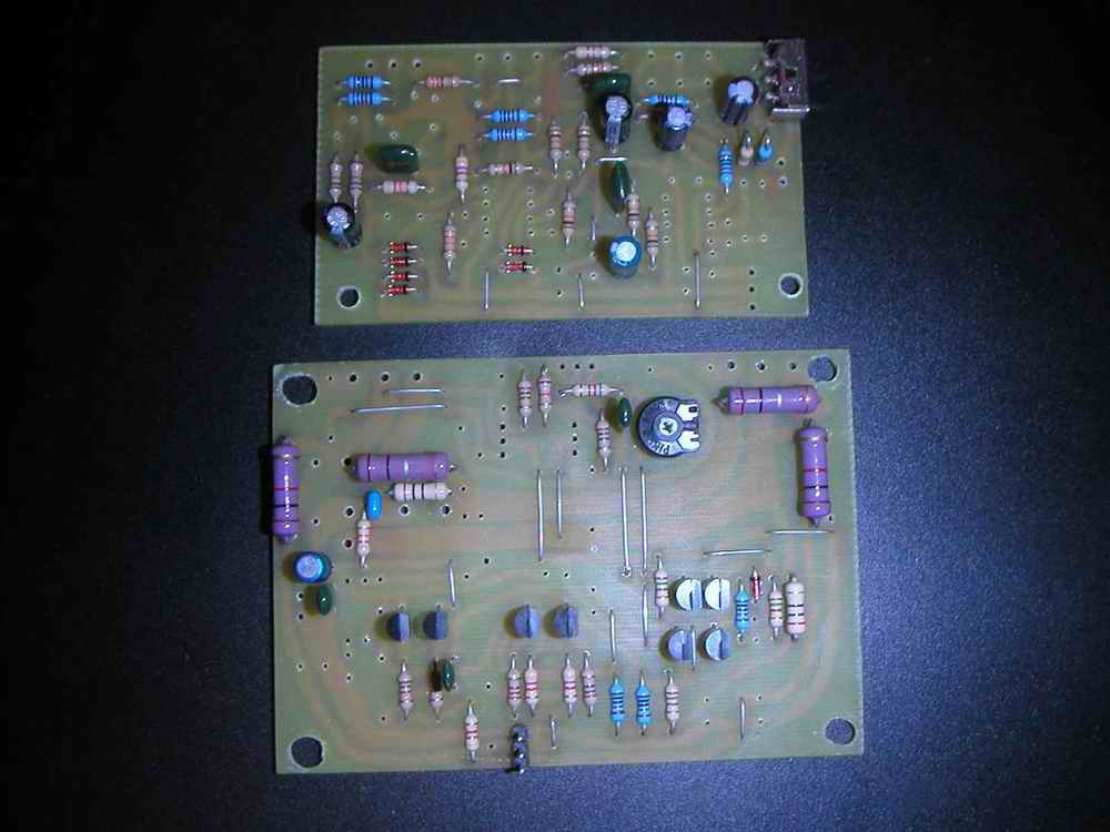

Finished Car Amplifier schematic + PCB based on Kenwood KAC-716
Hi
Other picture of car amp+ preamp.These days I will put picture of SMPS and complete car amplifer
