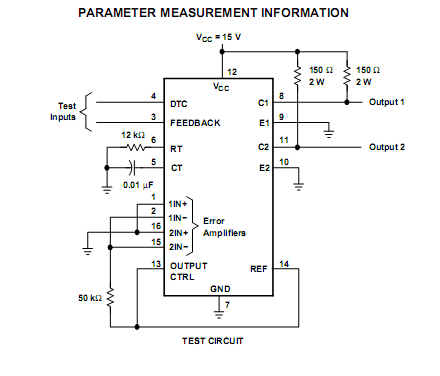

if you really need feedback, it would be done pretty much the same as with SG
find one that has TL and has feedback... I think you will only need hand full of components more for that
TL494 has DTC pin 4, Feedback pin 3, 4 inverting/noninverting pins 1,2,15,16, I've attached image from datasheet.
I'm confused which all pins are for U an I control???
The 0.2 winding factor is for the primary. It's not critical.
