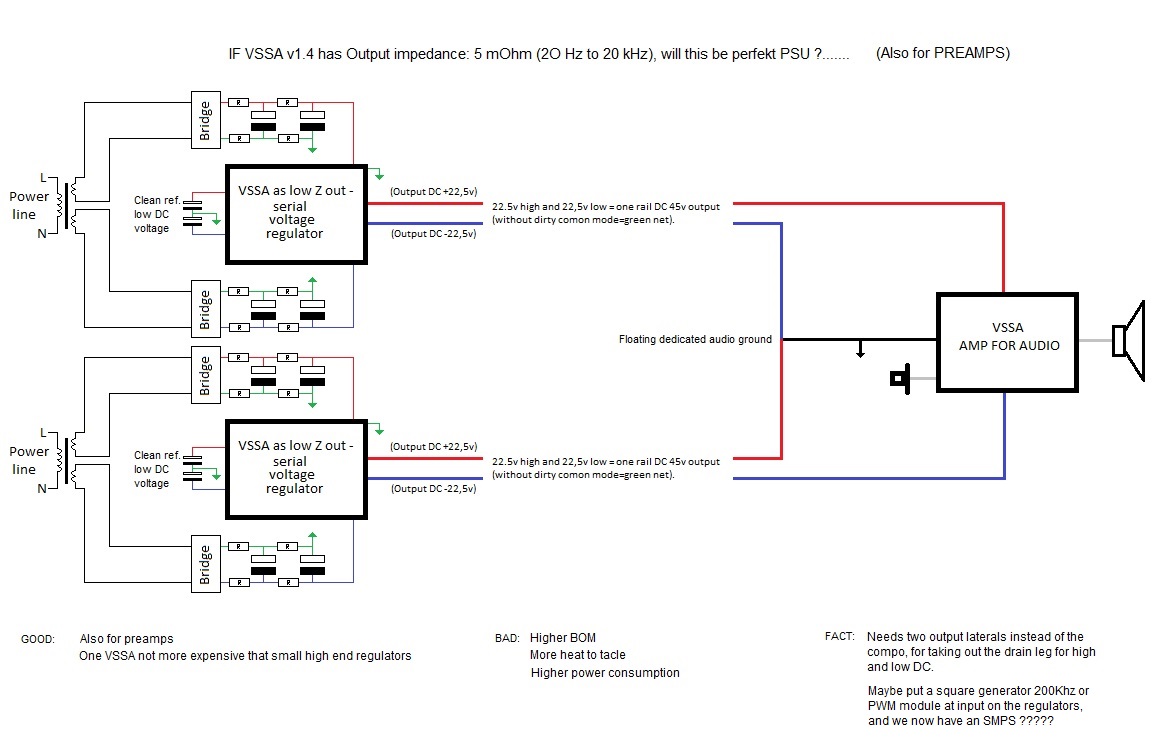

Hi peter,
did you see an issue to split the board in two boards : a positive one and a negative one?
Marc
Marc

That would depend on why you want to do it.Hi peter,
Marc
So, for example, the bridge rectifier will be split in half. Also, if connected to a class A-B amp, you will no longer have a balanced circuit. Each half of the board will see current pulses corresponding to the demand from one rail. (The problem actually occurs not at maximum current, but at zero crossover, when the current stops abruptly). Filter caps not connected to the same point, etc...

No Pmi my idea s to split in two but with on rectifier complete rectifier bridge eche rail and connecting the ground of each at ground point from amp board.
Marc
Marc
It should work. You may have some very sharp current transients in the connections. Where is the common point of the two large filter caps? I suppose you can just try it and see how well it works.No Pmi my idea s to split in two but with on rectifier complete rectifier bridge eche rail and connecting the ground of each at ground point from amp board.
Marc
I think i will implement the cap. mu. on BG1 board, then i can route ground trace thick enough that runing at on end all the length of the board. Will try on eagle this evening

Thanks for answer and glad to hear it is an regulated SMPS that is available.
Still want to make trials of different PSU and amps setup before final build, but must say it is teaser against good SQ anyway with this amp as you descripe sound.
I am hobbyist and do not have skills for making serial valtage regulator of VSSA module, but i could not get over Andrej's manual claiming z out 5 mili ohm, hey that is perfect serial voltage regulator, so that is DEVIL again, but cant do my own, and it is not simple anymore but relative cheap (see picture).
