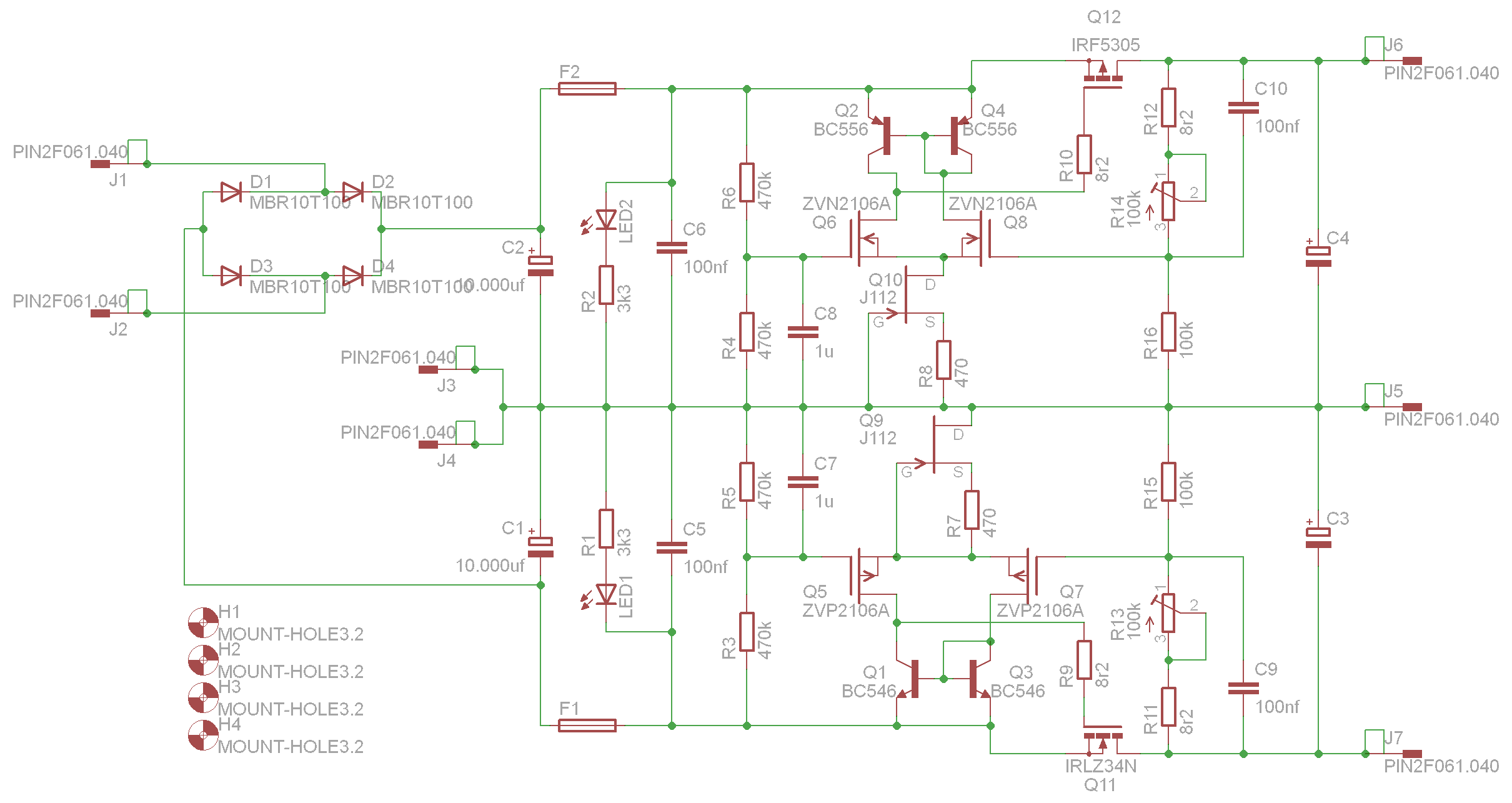

R11, R12 on your schematic should be 100k, not 8R2!
Yes right, thanks for pointing the mistake.

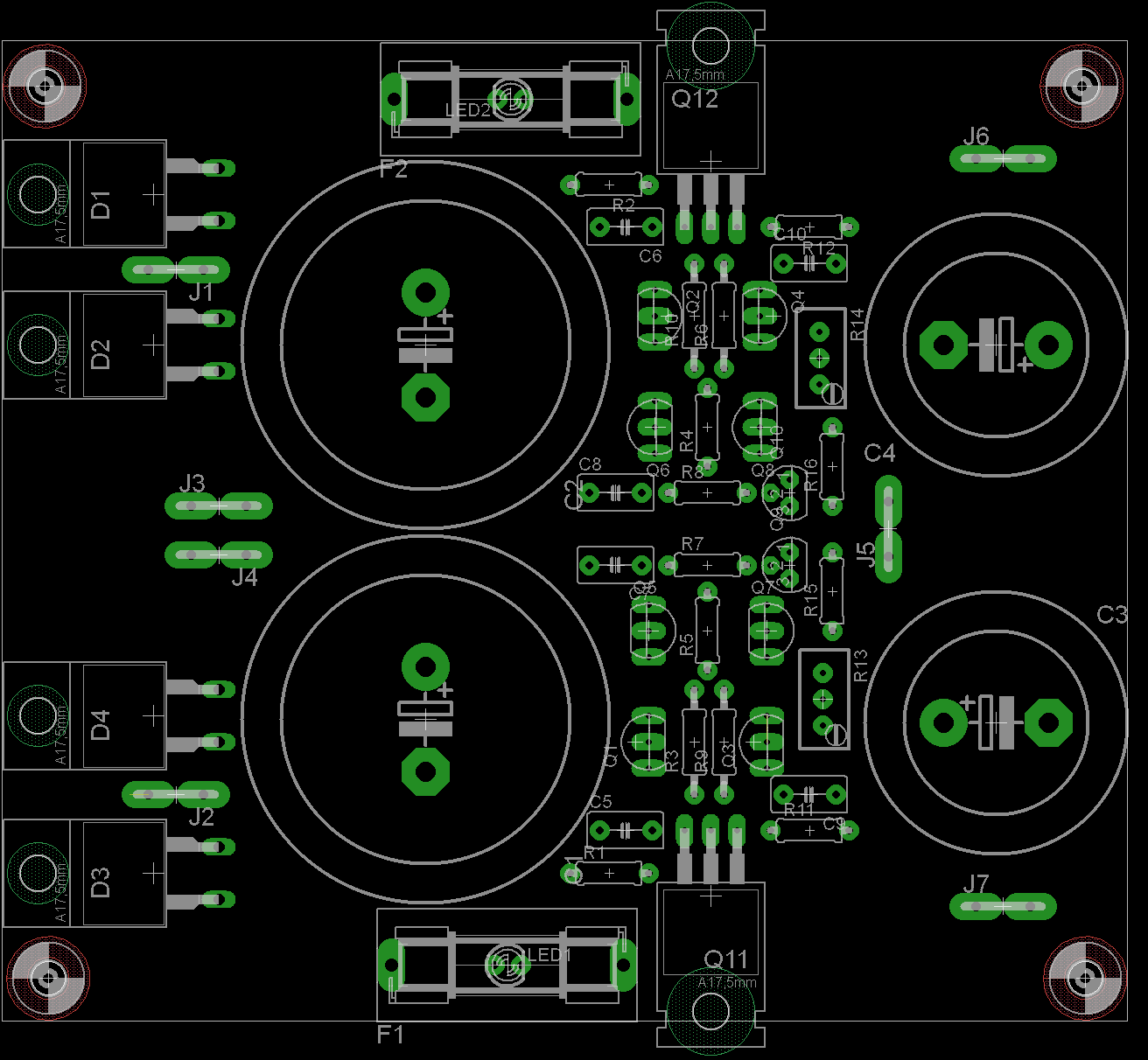

Looks nice Marc, like all your other layouts, 😉First layout try on PMI schematic...
Board size : 110x95mm with all devices on one heatsink. This board has less option as PMI one due the size goal

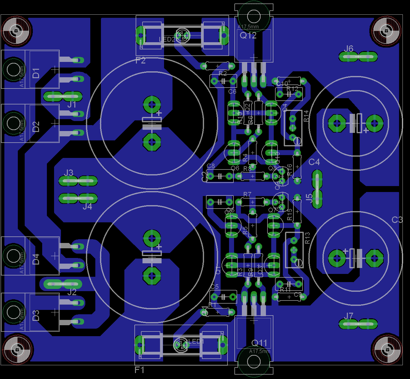

You are correct about the board size and options. I do have a comp placement & route that will work on one layer, but it looks like I have to extend the board another 5-10 mm to make sure it can be diy etched. I will try to get back to it later today.
J112 is rated at up to 35V breakdown voltage. Another alternative, BF244B, 30V (requires 390R instead of 470R).Should be fine. For higher voltages, the only thing that might cause problems is finding a JFET with suitable rating (in PMI's design, it needs to be able to handle 0.5x the input voltage, in my original design it's 1.5x).
I connected the Jfet to ground because I wanted to be able to run the supply up to +/-60V rails (eventually), and that was easier if the Jfet has to be rated at only 1/2 rail voltage.
The startup and shutdown may not be as smooth as the original circuit, but it is still quite good. Better than I had hoped frankly. I think this is a very clever and cool (pun intended) version of a Cap Multiplier circuit that MrEvil has gifted us with here.
Hi Idefixes,
Nice layout 🙂
A couple of points that may be worth noting (or not, I'm not an expert).😀
Eagle can now connect 1 pin to 2 pads so you don't need to do that trick on the schematic to connect both pads together. See the standard library: con-faston, device: PIN2 for an example on how to create the component.
It is advisable to use a vector font on Eagle PCBs. The text will move around when you generate your gerbers otherwise.
You may need to add larger holes to allow the head of the bolts to go through the PCB on the transistors on the heatsink.
It is nice and less error prone to have all the polarised capacitors orientated in the same direction.
For standard resistors I usually allow 10mm. They will squeeze into 7.5mm but don't look as nice.
A shorted legged version of the component for Q11 and Q12 will fit nicer.

Hi Idefixes,
Nice layout 🙂
I will look that
Generally i drill 8mm hole for this use and it fit.
Yes it's what i make , but i this case the caps orientation allow to place faston spad either over nor under caps... i will check what i can achieve
I use 207/7 package in general because of place saving, and 207/10 when i need to route more than 2 tracks between res. pads. When you check the layout with 207/10 at every place i have to grown the size board and 110*95 may be 100mm is the max i can. I agree nothing impossible to do for swap to 207/10 in this particular layout but with others it's critical...
regards
I will try, bu need to create package i think...
Thanks for spended time to advice me.

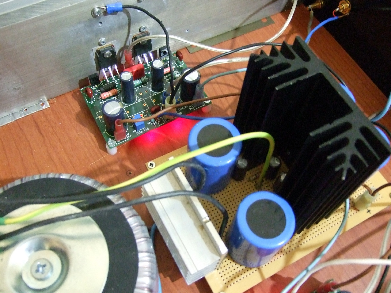

ATX supplies can have very high and continuous output currents, and this translates into heat that has to be dissipated in the pass transistor heatsink in a Cap Multiplier.
Indeed. This size a sink reaches almost 20C above ambient at 7W constant loss. Its for a multiplier (Darlington) serving a two channel class A amp.
