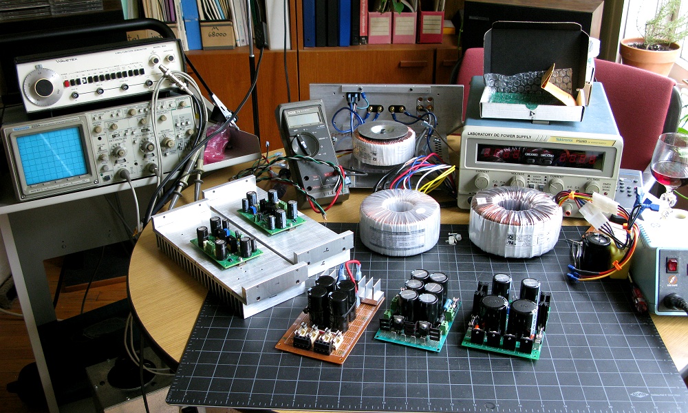

The pics below are just about everything used for testing, old Tektronix oscilloscope, signal generator, VSSA boards mounted on heatsinks etc.

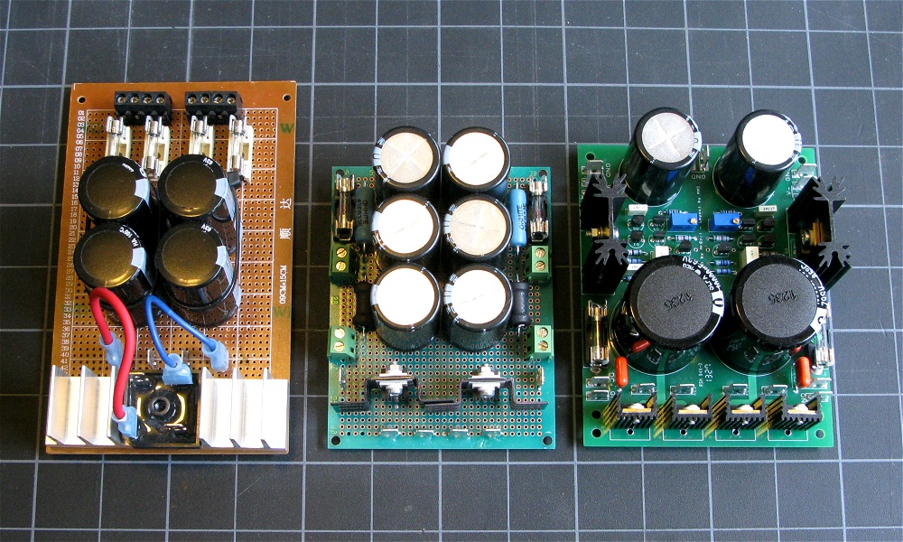

The second picture shows the two power supply versions used for comparison purposes. Left to right, a bridge rectifier and capacitor bank w. same value as the main rectifier filter cap on the new board. The CLCRC configuration, same total capacitance per rail as the Cap Multiplier board. On the right, MrEvil's Capacitance Multiplier.

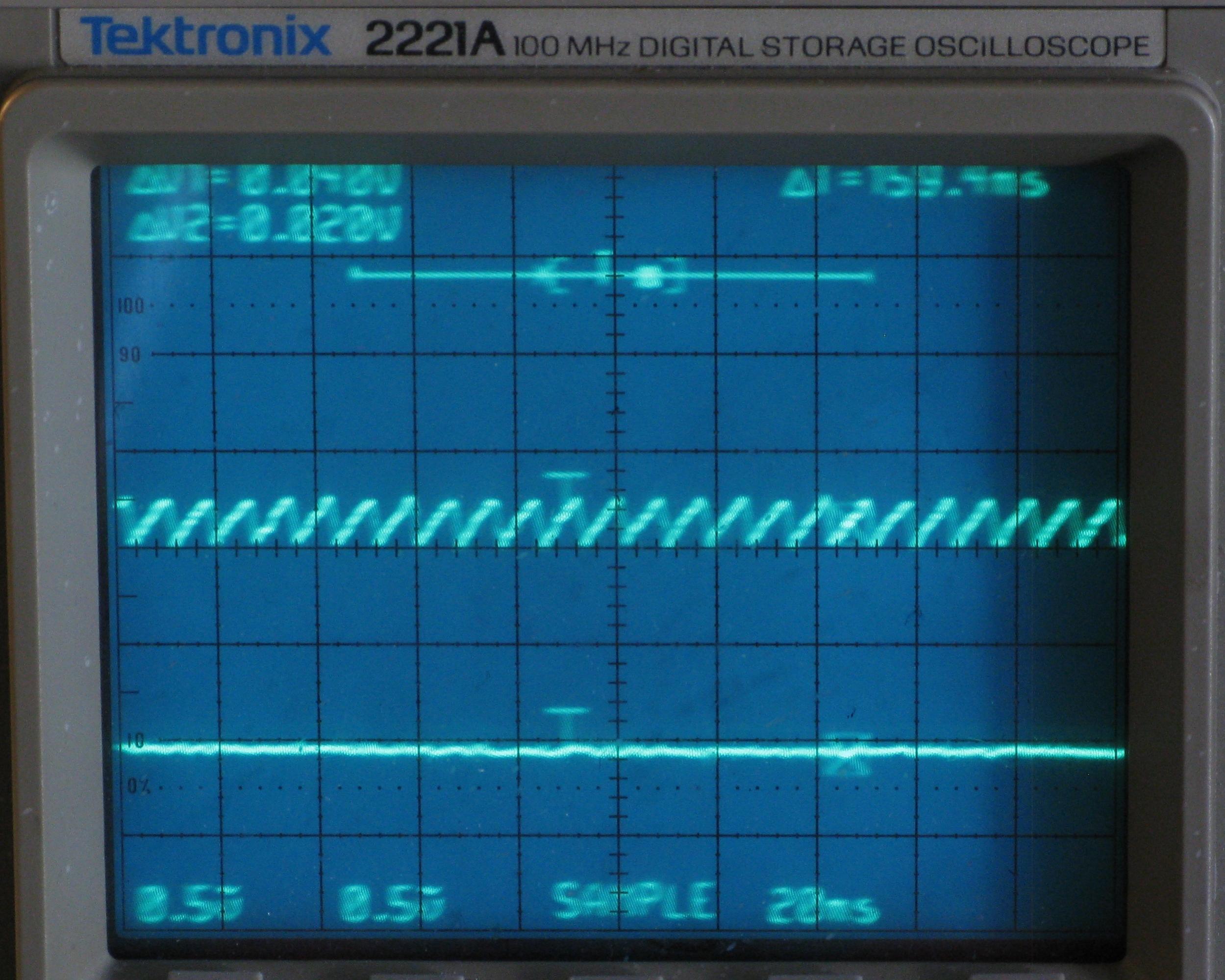

I thought I would post this one test result as it relates to a discussion elsewhere. This is one reason why I was interested in using MrEvil's Cap Multiplier with VSSA, and later I hope other similar circuits.
The first pic shows the power supply ripple before (top trace) and after (bottom trace) the cap multiplier and pass transistor, in other words at the main filter cap (top) and output of the supply (bottom).... during a quiet passage w. little bass content.

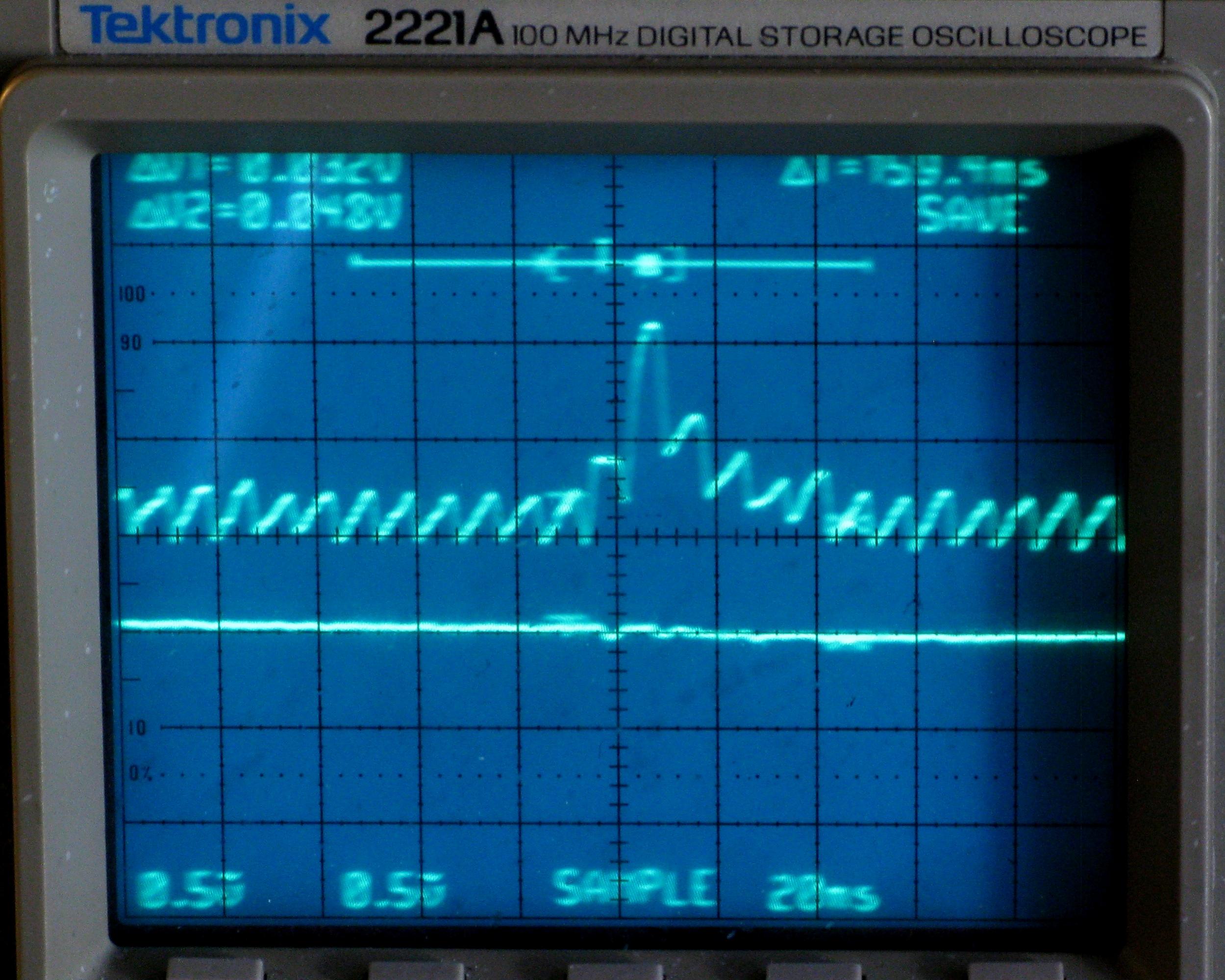

The second pic shows the same, but during a passage with moderate/heavy bass. Top trace is before the cap multiplier pass transistor. Bottom trace, after the pass transistor, at the output of the supply. Without the cap multiplier, noise boosted by LF transients easily exceeds 4x the ripple voltage.
In the second picture, you can see the ripple riding on top of what is a single transient, about 40-50 msec long, or 20Hz frequency. The lower trace shows that the capacitance multiplier is effective in suppressing even sizeable LF transients. (not necessarily every cap multiplier will do that, it depends on the time constant of the RC circuit, but this one will, and quite well) At the output of the power supply, there is barely a trace.
The material used for the test is just what I happened to be listening to this morning, David Benoit, Shadows, track 5. Fairly easy listening, new-age-ish music to have w. morning coffee... 😀)
The power supply was not loaded externally, like some of my other tests, so the ripple represents normal load plus standing current. Dropout voltage was set at 0.8V, and the volume was turned up to moderately loud, I would say 3-6 db above my normal single-room listening level. DC rail voltage adjusted to 35V after the cap multiplier using variac. Oscilloscope on digital storage mode. Vertical resolution 0.5V per division, standing current ripple under these conditions is about 200-250mV.
No exotic parts. This is with the first board I built. I ran short of time building the second one, so this is w. close to the least expensive parts I found at Mouser.That's a pretty impressive result, Pete, and this is without any exotic parts at all?
Parts from reputable sources, but general purpose filter caps, diodes, etc. Output cap is a 4700uF electrolytic I bought in small q. from another member here for around $1.25 each, input cap is a 10,000uF made by CDE (SLPX103M063H7P3), around $5, rectifier diodes are the generic Schottky diode we already discussed. Rest is as per my BOM.
(This is not to say that a better-grade output cap would not help at mid-high frequency... 😀)
