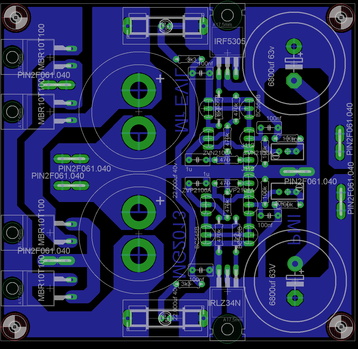

Looks good Marc! It is nice to have an option to use screw-mount caps especially if you have them already. If you don't the snap-in type are usually less expensive.My definitiv single layer PMI Cap multi. Will be etched soon. Reservory cap are screw one i have in stock, and output caps are 30mm diam. This allow to easy mount 63V models.
Marc
I think the output caps are available in 25-mm aren't they? I have two different types on hand, 4700uF 63V, Nichicon and Panasonic. One of the other members, dudaindc is selling the Nichicon 4700uF caps in the swapmeet section for around $1.25 in small lots.
yes i have already good BC154 22.000µf/40V in stock as Chemicon U32D 22.000µF/63V screw caps. For output i have Nichicon KG type I 6800µF/63V they are 30mm wide. ROE band in 4700u/63mm or nichicon KG type II are 35mm wide.I know that panasonics snap in TSHA are 25mm diametre.

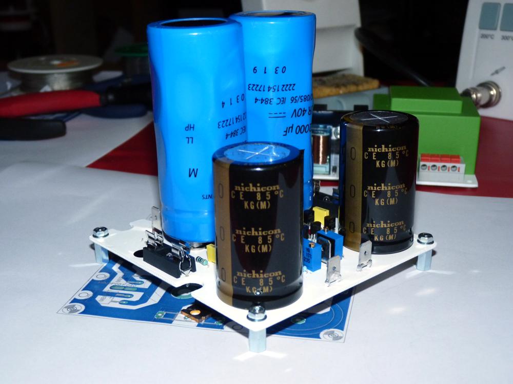

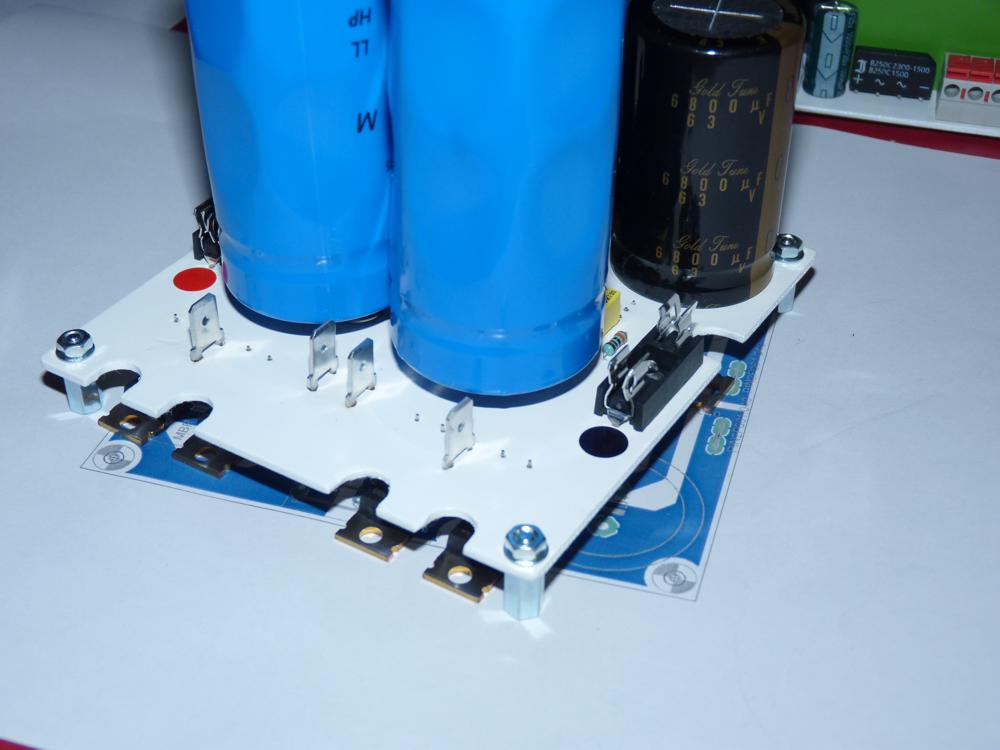

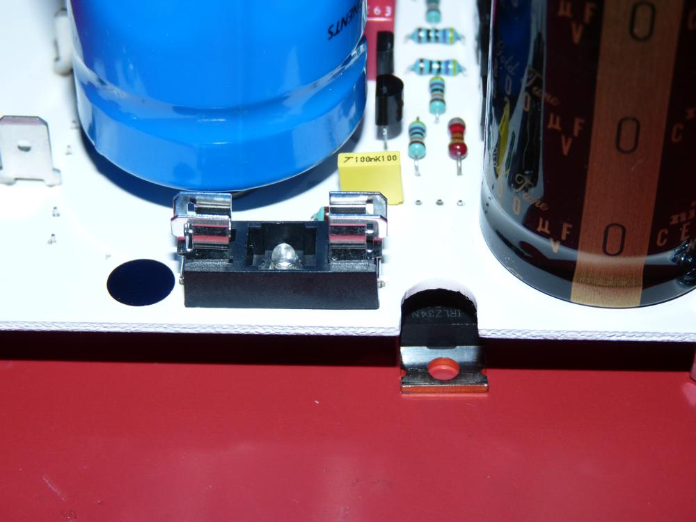

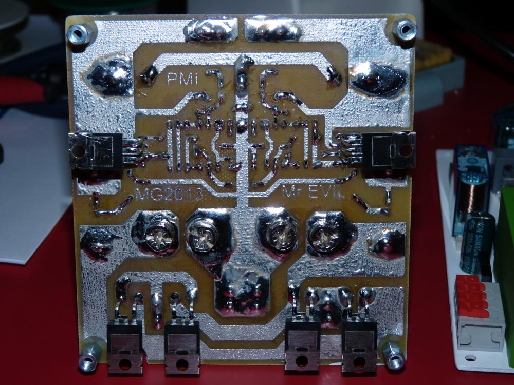

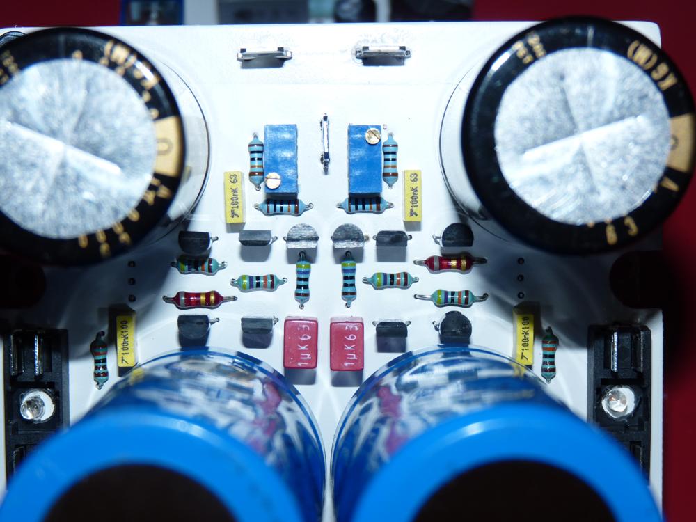

Just finishing to solder the first CapMu board destinated to my Versatil (Borys BG1-BJT schematic interpretation)...
Very nice Marc! Makes me wish I had opted for some more impressive caps, I'll have to see what I can dig up for my next pictures... 😉
I was thinking it will be a pitty not to use this caps as i have 10 unit in stock and 4 for more mallory screw same rating but 50mm diam as BC have 35mm diam.
I have 4x U32D screw caps 22.000µf but 63V. As the output caps are rated 63V to i can use this board for testing a +/-50Vdc rail amp version.
Marc
