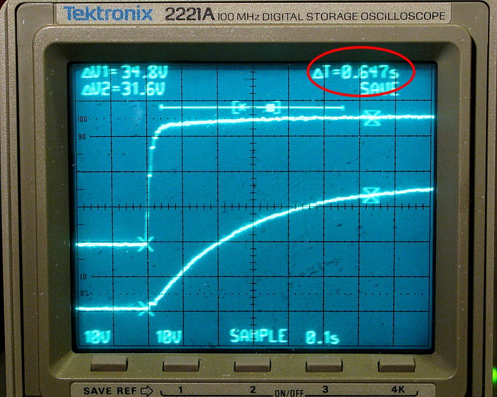

Soft Start
For myself, one of the "winning" characteristics of this particular Cap Multiplier was the soft turn-on (meaning the rail voltages come up gradually).

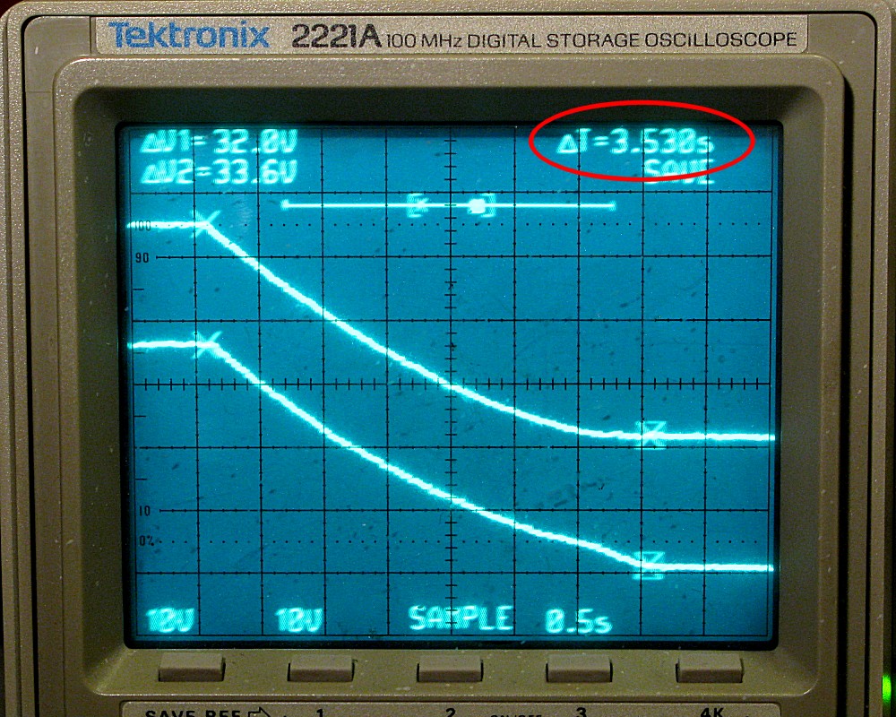

O-scope screen shots of some of my tests were posted above, but I am reposting this one below for illustration.
1) In the first picture, the cursors of the storage scope are set to measure the normally fast voltage change before the CM filter. This is fast enough that if the amplifier is predisposed to transmit the resulting transient to the output, you will hear some kind of startup noise.
2) In the second picture, the scope is set to measure the slower voltage change at the output of the Cap Multiplier. In most cases, this will push any startup transient down to the sub-sonic frequency range... in other words, no startup noise, or at least none contributed by the power supply.
3) Third pic is the shutdown, posted for completeness.
Note: If you already have soft-start and muting circuitry, this may not be relevant from the standpoint of what you hear from the speakers, however I personally believe that a well-behaved start and shutdown is one of the benefits.

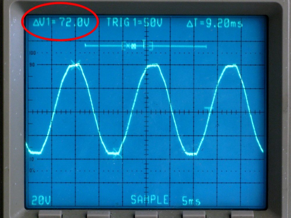

Rectifier Diode Selection
The Capacitance Multiplier PCB can be used over a fairly wide range of voltages and currents, but components have to be selected with appropriate ratings.
In the case of the rectifier diodes, average current rating, peak current rating, and maximum reverse voltage have to be observed. To put it another way, the rectifier diode should be selected the same way as any other linear supply, CM or not.
The average current depends on the amplifier, but the peak current depends on the size of the reservoir capacitor. The larger the reservoir cap, the greater the momentary current generated when the cap is charged.
The reverse voltage rating of the diode is given roughly by the maximum pk-to-pk voltage at the transformer secondary.
Example, using my transformer with a nominal 25V secondary winding:
(25V(rms) * Sqrt(2) * 2) * 1.05 - 0.7 ~~ 73.5V
This is the reverse voltage seen at the rectifier diode.
Picture below shows voltage measured at light load. The bottom of the waveform represents the period when the diode is conducting. The top of the waveform represents the period when the opposite polarity diode conducts current to the other rail, and the reverse voltage is at its maximum.
