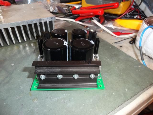

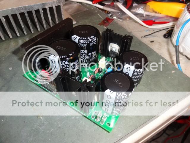

My finished capacitance multiplier.
Yes, looks like the same extrusion as I listed in the BOM, with a couple extra holes.
Aavid-Thermalloy/513102B02500G
There is nothing special about the part number. As long as the footprint and the pin spacing is the same, it will fit. Even if you select a heatsink that does not fit the footprint exactly, it will still work if it is about the same size and surface area. At lower power levels, even a 2~3 square inch of aluminum plate will work just fine.
Have you guys experienced much heat on any of the heatsinks. I put a single heatsink across the diodes anticipating some heat there, but to be honest, I don't feel any heat anywhere. I'm driving the Symasym as loud as I can stand it and there is really no heat at all. I'm using a 25-0-25 600VA transformer and the rails are sitting at 37.8VDC. I'm running about 70ma bias on the Symasym. What would you be running that would cause this to need these big sinks?
70mA to each polarity with 1.2V of Vdrop across the Pass Transistor amounts to ~84mW being dissipated in each device.
That is going to raise the heatsink temperature by how much?
Putting your hand/fingers on the heatsink will heat it more.
The average power put out by your amplifier is usually very low in comparison to the maximum. It's that average power that is the demand put on your Cap Multiplier.
Try measuring the average current passing through the Cap Multiplier when you listen at various volumes.

Have you guys experienced much heat on any of the heatsinks. I put a single heatsink across the diodes anticipating some heat there, but to be honest, I don't feel any heat anywhere. I'm driving the Symasym as loud as I can stand it and there is really no heat at all. I'm using a 25-0-25 600VA transformer and the rails are sitting at 37.8VDC. I'm running about 70ma bias on the Symasym. What would you be running that would cause this to need these big sinks?..
For a rough estimate, assume:
Ambient temp. = 50C
Max. junction temp. = 175C
Junction-to-ambient themal resistance with no heatsink = 60C/W
Diode forward voltage drop = 0.5V
This gives a max. allowed temp. rise of 125C, which will occur with 2W of power, which will happen with an rms current of 4A (per diode). Anything up to that could potentially be done without diode heatsinks.
There's a lot of assumptions in there, but it will give you a rough idea. Nonetheless, even if you don't use that much power, it's still good to keep schottky diodes extra cool, because it keeps their reverse leakage current down.
...I'm curious to see (if possible and/or if you have them measured), the response of this regulator (voltage drop under burst), also with medium current as 3-4 Amp...
I don't have anything more than I have already posted, and I can't remove my own PSU to take any more measurements now. However, I'm sure that more measurements will appear now that there are lots of PCBs out there. If you want good transient response, a large (PMI's specified 4700u is plenty), low impedance output capacitor is what matters most.
...What would you be running that would cause this to need these big sinks?...
It does not need a big heatsink, but some heatsinks are a minimum requirement, taking into consideration temps inside some chassis, higher bias currents than you are running, etc.
A small Class-A amp will generate more heat in the heatsinks than a large Class-AB amp. The same thing applies to a Class A-B with a high bias. A single heatsink is more suitable to those situations.
My VSSA uses about 300mA when idle with a single pair of output devices. The two-pair version of VSSA will use close to double that, and I am sure some people will try to run it at higher current (consider some of the experiments being done by Idefixes).
Aside from that, I wanted to make sure that nobody ran into trouble running test tones, into dummy loads, etc. See a post by Rick G in the VSSA thread.
This is not just a matter of large continuous forward current, but protecting a Schottky diode as it gets close to the reverse breakdown voltage. Schottky diodes are happier running cool... 😀
