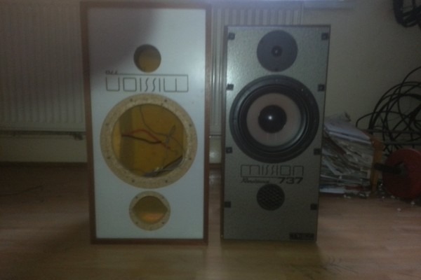

I got sound out of one tweeter the other nothing. Sound was horrible. There is a pair of speakers with working original tweeters, im gonna arrange some kind of deal to get them. The guy knows his way around tech, fixing amps and speakers. Personally I have a few items to offer, once fixed can fetch a tidy sum so im going in this direction. Also helps to get rid of hifi got stuff everyware. Regarding the 737r tweeters, too small by 10mm diameter, i will have to screw new hole's for them, the opening left from the H211's is not leaving much to go into.
Speakers have been prepared. I can naw dye the cabinets.
Your Mission 737 speakers appear to have 94mm Vifa D19TD05-08 tweeters, not 104mm SEAS ones:

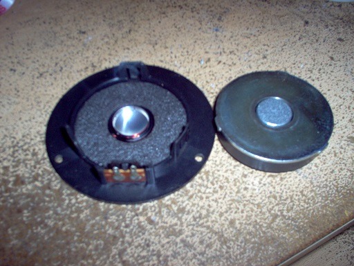

They come apart a bit like this for removal of old solidified ferrofluid:
https://www.seas.no/index.php?option=com_content&view=category&id=45&Itemid=462
This is skilful work to lift off vertically without damaging the voicecoil.
You must undo the three clips.
But tweeters will run without ferrofluid, just keep the level down until you get some fresh stuff from Blue Aran in the UK.

A SEAS tweeter comes apart with 4 screws, and can run with or without ferrofluid. That Sonitus syringe is enough for 5 x 3/4" tweeters, or 3 x 1" ones I'd guess. It's not very critical.
Ferrofluid is not strictly necessary in modern tweeters which have better glues and materials, it is an option. Some people think ferrofluid makes the sound worse. It is popular because it reduces warranty failures.

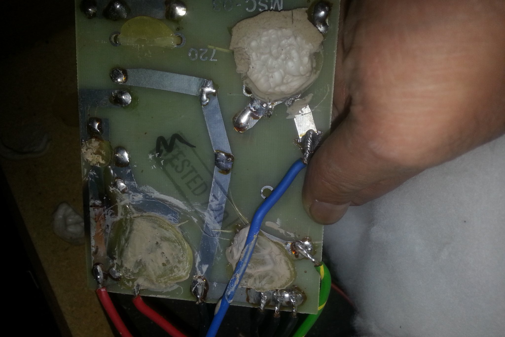

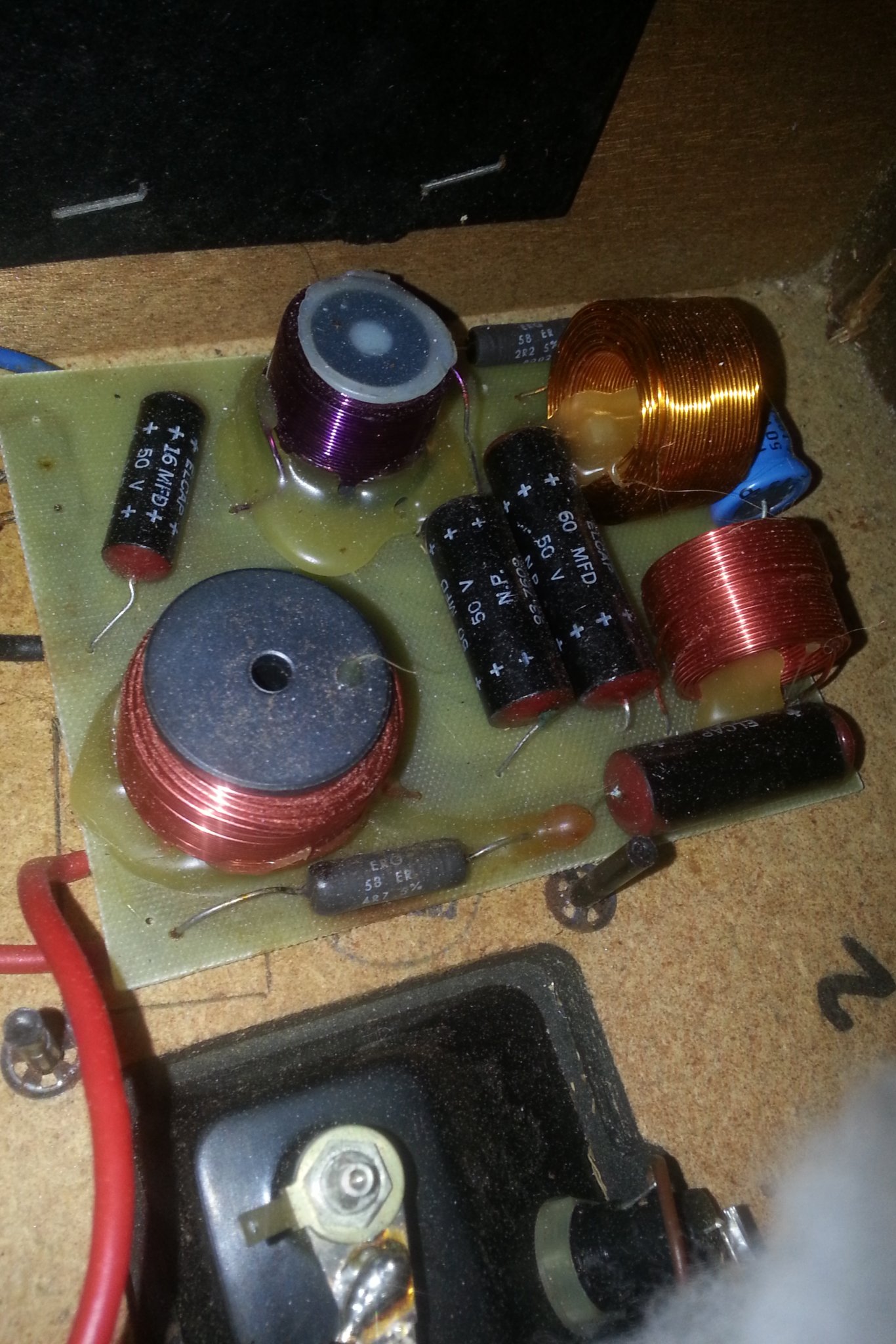

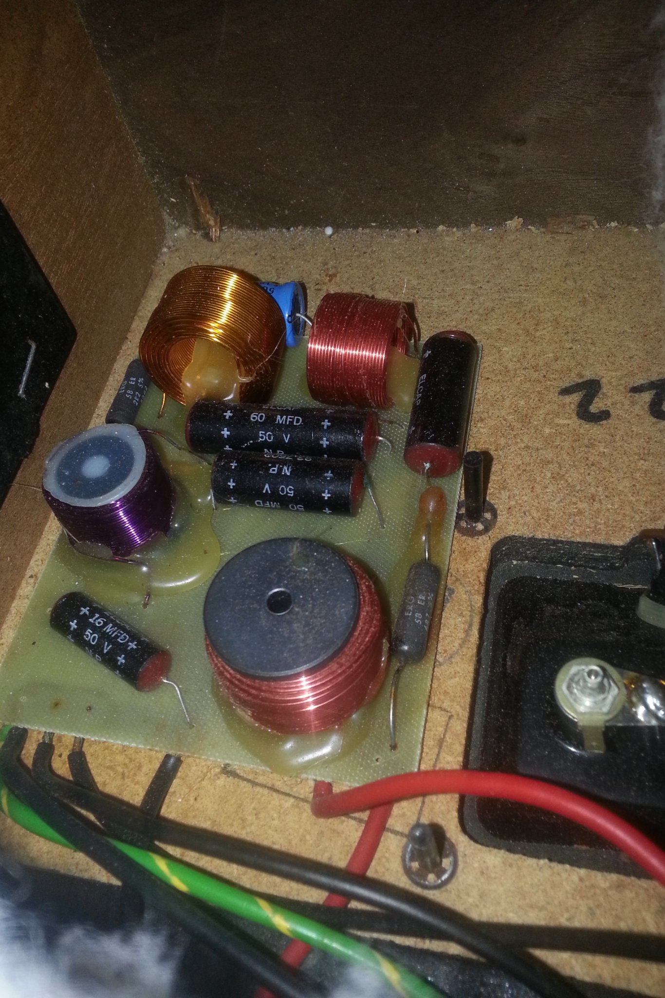

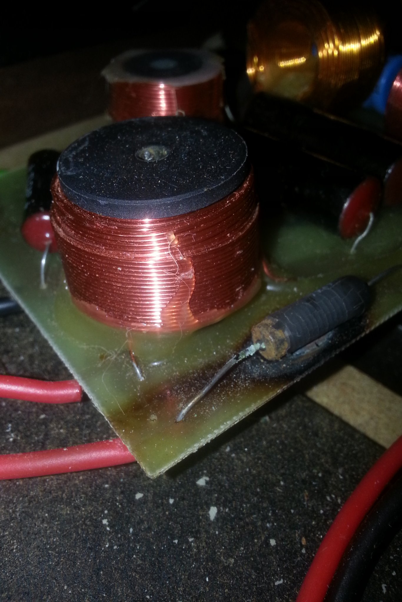

I'm back! What a ball ache. ..anyhows I've been caught up at a crossroads, I said I was expecting another set of speakers so I may use there tweeters. ..the speakers were in fact a wonderful pair of vintage mission 720! Yes them drivers all sealed and working except 1 midrange but I will get to that. Thay sound and this was just a 2min test lovely. The type of sound I like. So why not enjoy these for a while right! I opened the one with the midrange not working and saw it had the positive wire disconnected "YES" I said out loud what an easy fix and a pair of speakers for keeping. All connected up and no..still no sound. The crossover had been detached and laying between the 2 rolls of dampening. I forgot to mention the first time I opened them up I felt arround inside and my hands were wet from the midrange tubular housing and back of bass speaker magnet, "thay were stored away in a garage for some time"!! I removed the drivers and set the cabs in a warm room to dry.

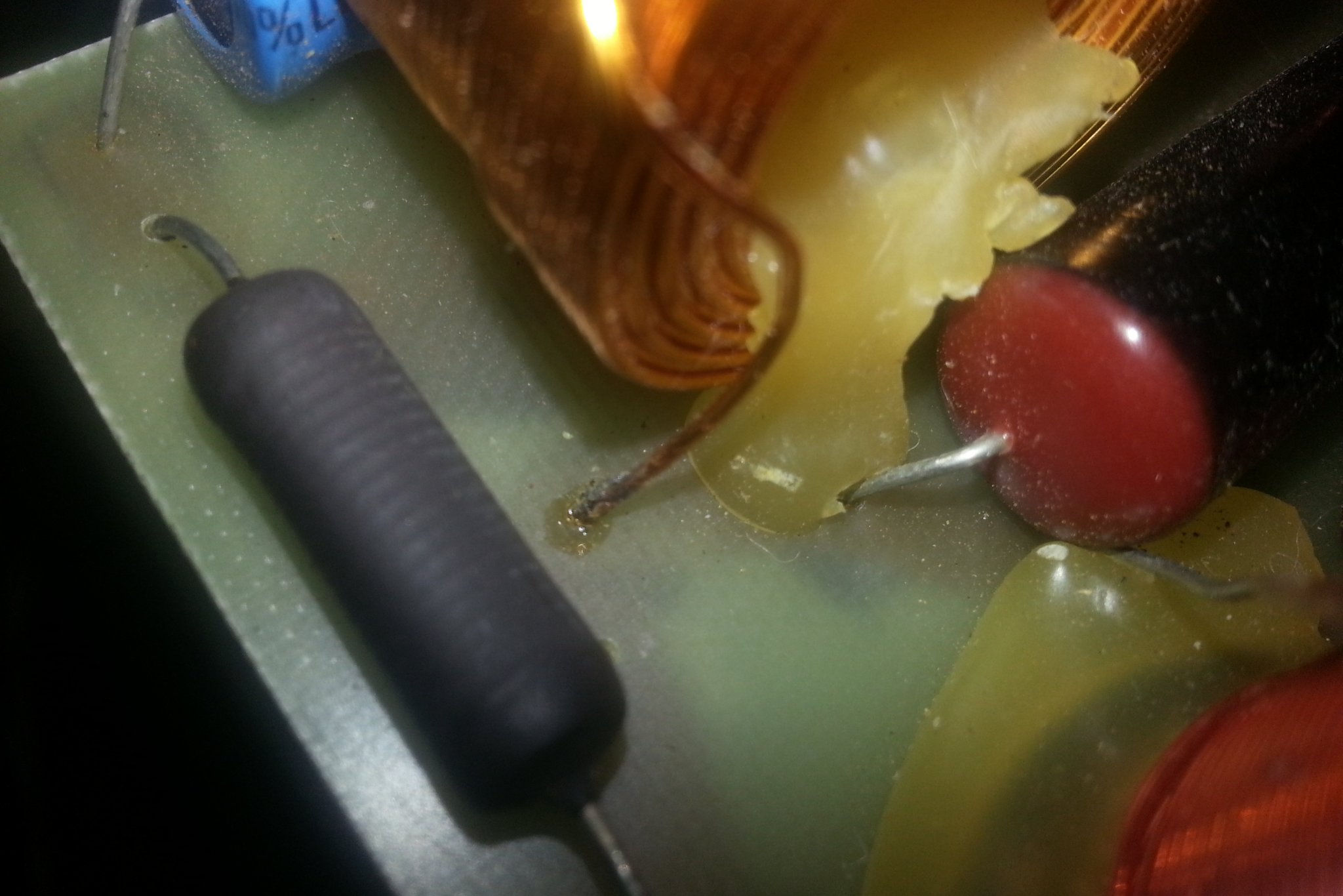

I began reading threads about the 720 speakers. I tried the battery test on the midrange and it was positive that they worked so close inspection on the crossover was in hand. TO BE CONITNUED.
"System 7" sir I saw your input valuable on the threads you commented in. Please help me. ...my crossover's are different to the ones in the threads. I will show pics. First lot is crossover with midrange problem. Yes some very bad images you do not want to see on a crossover. Visually does the last image showing the end of coil a break in sercuit?

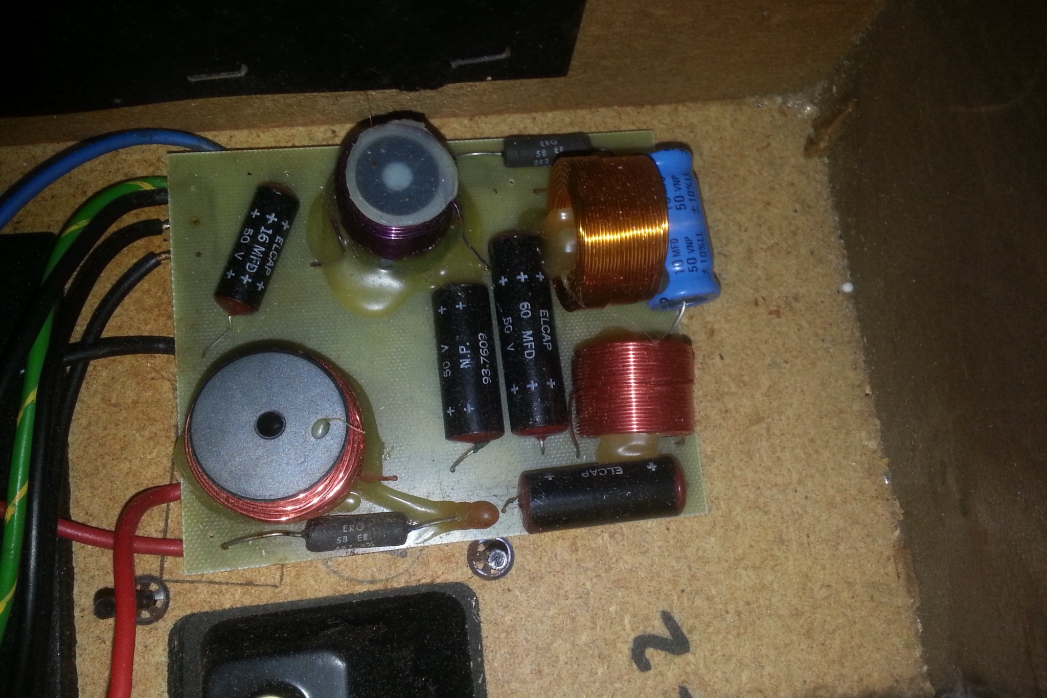

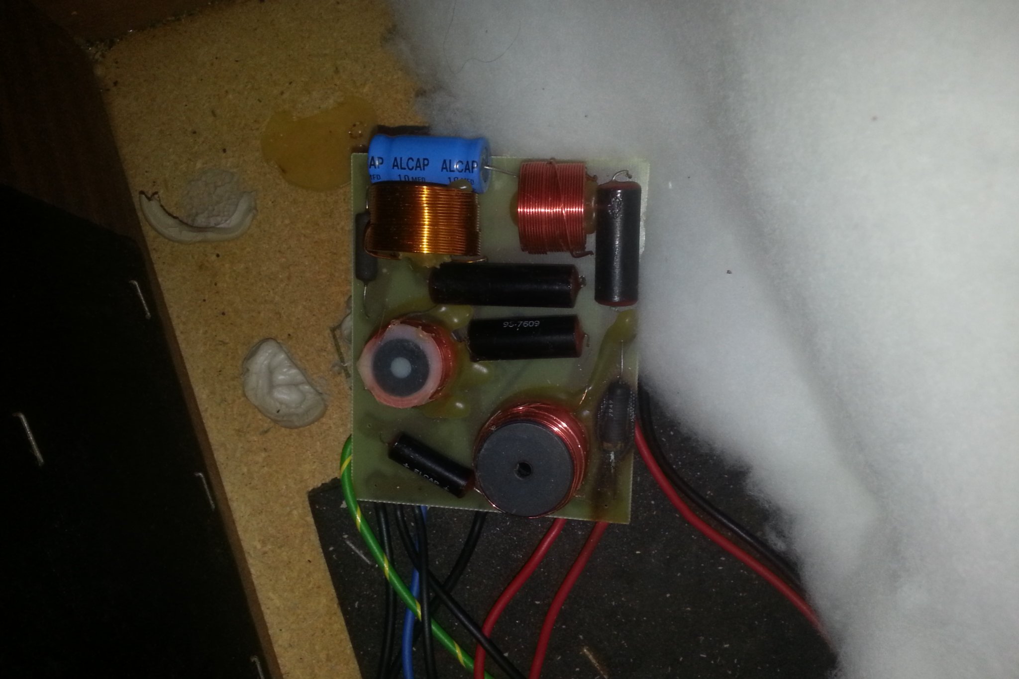

This lot are of the good speaker, crossover that's fully working. The one coil that's purple? I didn't get it..
