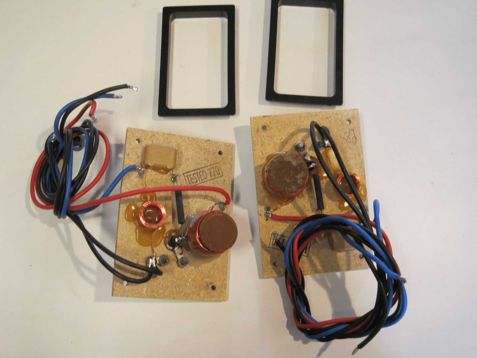

I've found this image of the original Mission 770 crossovers that was supplied by member slipmyster.
The tan coloured single capacitor at the top is a film type which does not degrade over time.
If your capacitor looks like this there's no need to replace it, but you may be tempted to upgrade it.
I had a quick look inside and Hurray!! I have the exact same tan capacitors.

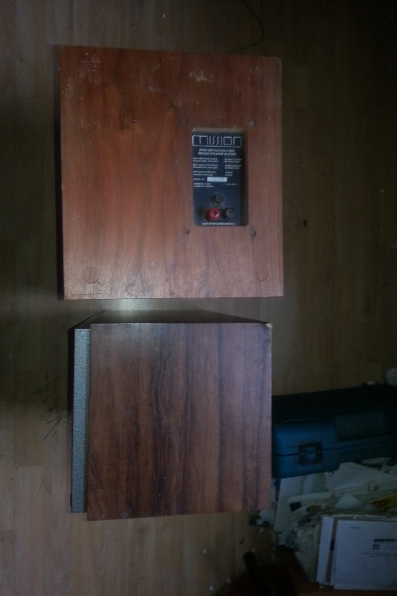

Tweeters are bothering me. I'm gonna take a punt on a pair of speakers that have H211 tweeters that work.
Look a the size difference! Thay pack a punch and sound quite nice. .
