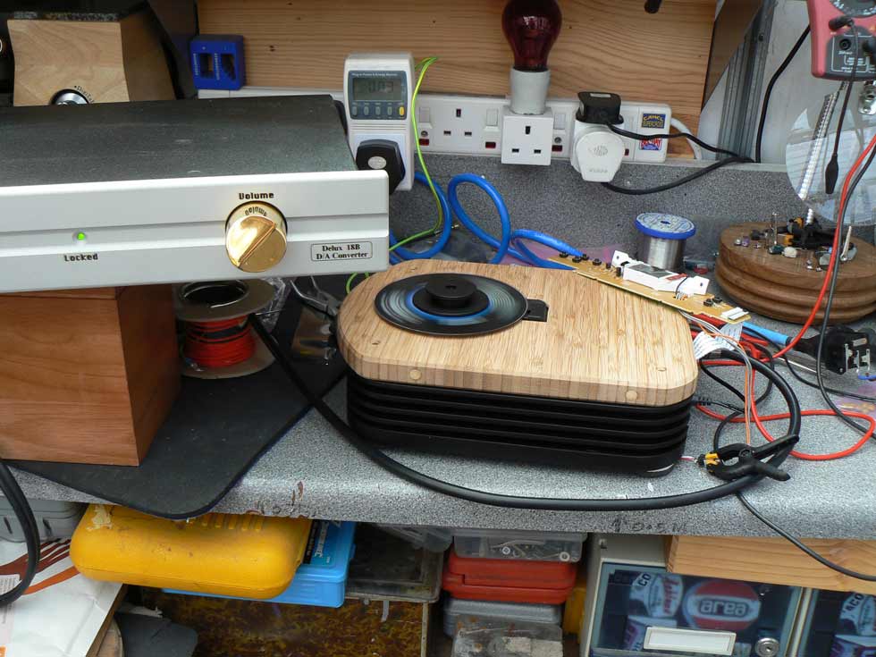

Thanks Peter, got mine up and running😀 .
A couple of questions before I go any further. On the mods pdf, what is the jumper from 5A to 5B for, does it bypass a transistor?
Second question, when you use a two legged Oscillator, do you need to add caps to the centre, B position?
Thanks again..
PS, I have no idea were to put the display and buttons yet.😕
Thanks again..
With the crystal, in most cases the additional caps are not needed. I tried it with the caps (10pF or so), but they affected the sonics in a way I didn't like:
Depending on the crystal type, without the caps some people experienced skipping or problems with TOC read out. In such cases I would recommend adding 3 twisted wires which will produce required capacitance without the signature of regular caps:
The 5A to 5B wire is for PS connection right after Q902 to the rest of the circuit; I cut some traces when I was experimenting with different supply setups and decided to connect it this way afterwards. It is not really needed, but maybe beneficial in some ways.

I like the "gimmick" cap you came up with for the crystal. I ordered the same type you are using for mine. I take it you have not encountered this problem with the citizen crystals you are using.
I will post pictures of the RCEZ32 boardset once I receive the unit, hopefully disassembly will confirm that the boards are the same or utilize the same chipset.
