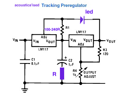

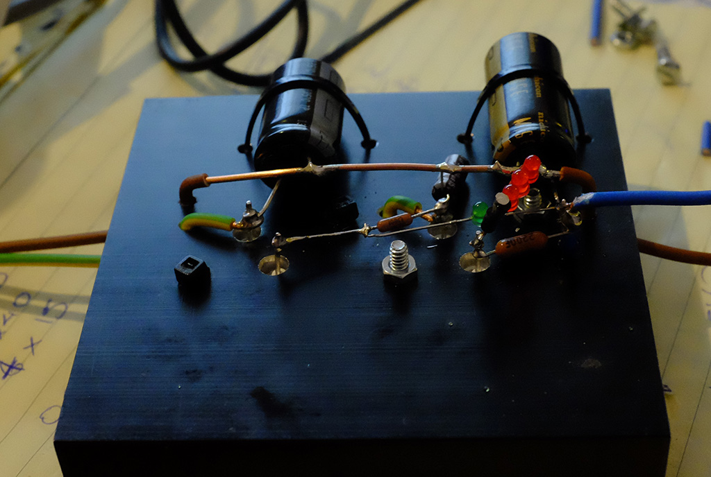

By the way, I tried the tracking preregulator today.
Here is a photo
And here is the schematic.
I built the load reg exactly like my previous schematic, and just added the input prereg LM117.
Input and output caps are the same. Voltage reference stuff are the same. For C2+R I used a sprague 10uF capacitor.
The result was a vastly smoother sound. Everything seems to flow out of the space in the room, and highs are WAY clearer. With the LM117 itself I was thinking that the Muse 1000uF was too dark, but now I really like where this is going...
In the photo I have not included the reference capacitor. Again I used 220uF panasonic FR.

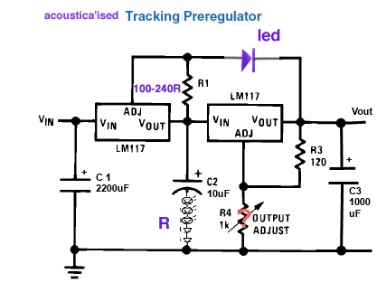

I used a cheap 10uF electrolytic for both of them. This needs to NOT be low ESR. If you do not have anything low ESR, just use a 1uF with a 3R3 or a 0.1uF with a 10R.
The most important part is still the led reference on the second reg. This makes more than half the difference.

Nope you got it in the wrong place. The leds replace R4 and you put in parallel to them a low ESR 220uF electrolytic.
C2 and the purple R can be both replaced by one cheap NON low ESR 10uF capacitor.

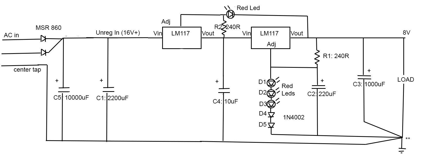

There you go
The important bits are:
C3 is NOT low ESR
C2 IS low ESR
C4 is NOT low ESR

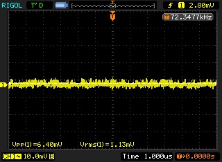

Also note that since I am running a big cable I also added a big filter cap right on the diodes, effectively creating a small CLC with the input capacitor and the long wire. This does not significantly affect the character of C1, especially if it is low ESR which means that more or less it will dominate the supply with its speed.
I tried a CRC but it significantly affected the sound adversely and the reference leds blinked just a tiny bit during big power pulls (speed up or breaking for example)
Anyway, as you can see in my scope view there really is no need for further filtering.
By the way, the prereg with this reference seems to give 8.25V output. This is quite ok as it seems, since my shiga is working perfectly for days now, and I think Tibi had said that you can use a bit higher voltage with just a bit more heat on the bridge chip.
Anyway, If you still want to get it to a straight 8V, the recipe is
2 red leds, 2 IR leds and one 1N4002

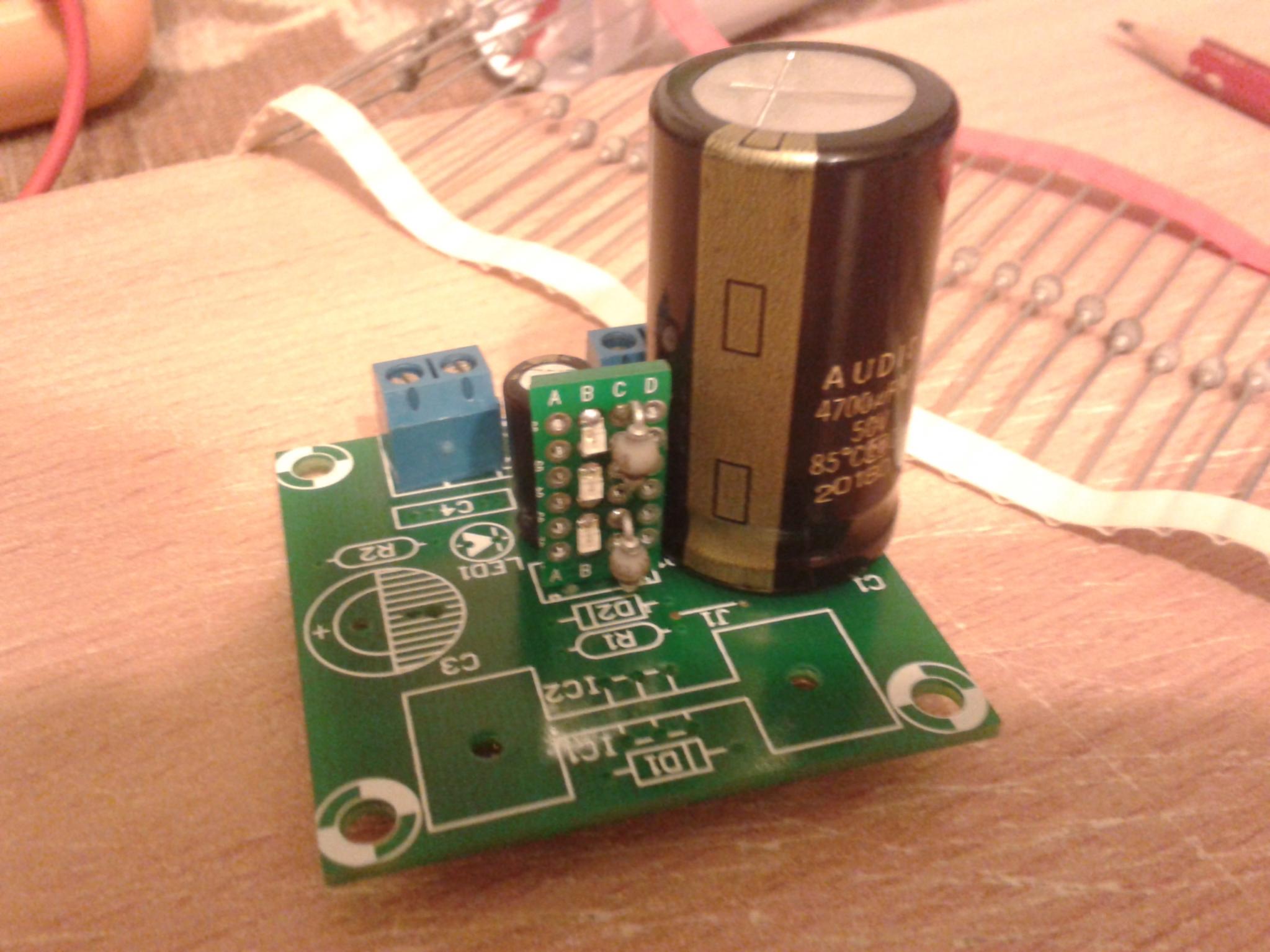

I've worked for small board with 3 smd leds and two byw27 diodes and forward voltage for the board is 6,67V.
6,67+1,25=7,92V
Hope that is OK

Yes the formula is the same.
It should be ok but Tibi should verify this.. The transport worked with even 5V. I learned this the hard way mixing my 7808 with a 7805.
By the way, did you measure it in circuit, or with a random battery and resistor? The forward voltage drop increases a bit with current, so I would try it in circuit with a dummy load of about 10ohms. If it is still below 8V, you can try using a bit smaller R1 to increase the current through the leds, although, 5mA is their sweet spot for minimum noise.
