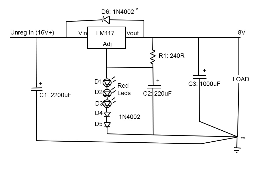

I was doing some reading again on super regs, and I remembered a link posted by 6L6 a while back about how to tweak and optimize an LM317 reg, so I did a few tests today to try the led reference thingy again (no zener this time) which lowers output impedance significantly.
I must say I am impressed. There was a very distinct boost in dynamics compared to the LM7808, mostly obvious in the impact of drums.
However the chip got hot really fast, probably from oscillation. I need to work on it a bit more, find proper output cap types and sizes, perhaps even hookup a tracking preregulator too, and I will get back to you.

Here is the schematic I am currently working on. It also works without changes with LM317.
C1: Use your favorite input cap. usually 2200uF/25V. Keep it close to the LM
C2: 220uF. Use low ESR. The lower, the better for the output impedance of the regulator. My choice is Panasonic FR at 16V.
C3: 1000uF. This must NOT BE LOW ESR otherwise the regulator will oscillate and overheat with unpredictable results. My choice is Nichicon Muse 1000uF/25V
D1-D3: 3mm Red leds. Do not use ultra bright. The cheapest you can find. If you get a bit more Vout, you can switch to green to lower it a few 10s of mVs
D4-D5: Plain old 1N4002. I used them because I had them and their voltage drop fitted perfectly.
D1-D5: The Vout is 1,25V+the sum of the voltage drops. For 5V you can use just two red leds. For 8Vs you need 3 red leds and 2 diodes. You can match or select your items after measuring them.
D6*: This is not necessary, but it protects the LM from the capacitor discharge during power down. I do not use it with LM117 since it has some internal resistance in the output, so it kinda protects itself up to a few amps.
**: Keep the ground star on the load to take advantage of the sensing function of the reference. It keeps parasitic resistances and voltage drops at bay by compensating for them. This significantly improves output impedance as well.
BTW, please do not use CAT5 wire for the PSU. You are killing your output impedance benefits. I am switching to 1.5mm solid copper wire.
Oh and it works perfectly with 12VAC, but some more headroom could make it work even better.
Sonically is very nice now.

I remember that you experienced with salas regulator, did you gave up him? becouse I have some laying around I planning to use them in 8V and 5V regulation can you just comment on them?
all the best
all the best
For 5V Salas was very nice, although it requires some attention to compensate for the swings of the digital load and prevent oscillations...
On 8V with ~1,5A for the shunt, the heatsink required was HUGE and I did not feel very comfortable shunting that kind of power. Plus the sonic improvement was not that big from the 7808, so I forgot about it and kept 7808 in there.
You try on LT1806 ?
