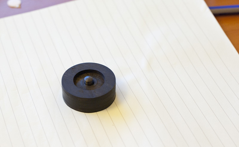

I made a puck out of ebony today... Damn I love that wood... So nice to work with and so beautiful...
40mm x 10mm dimensions
attachment.php
Unfortunately I cannot make 6mm dowels yet, so I am still using the metal axis. I hope I ll find the proper tubing tomorrow...
I really love how the puck sounds. It still slips a bit, so I think there is some room for improvement. Hopefully I will manage to find some Tru Oil too tomorrow... Perhaps some colophony too :)

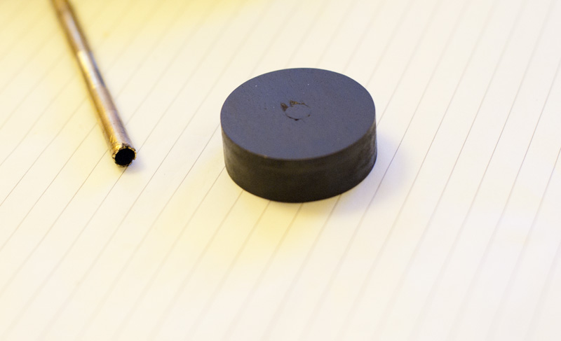

Dowel trial was a success :)
Here is the puck with the ebony dowel installed, sanded to 400 grit and finished with tru-oil. On the left you can see my diy tool that I used to cut the dowel :)
attachment.php
Construction-wise, there are some points that I have to fix. Basically in the symmetry and balance in order to make it as perfect as possible. This is my proof of concept puck anyway. I will try to make a new one tomorrow trying to fix the issues I have with this one. Mainly, I sanded the dowel a bit too much making it a bit thin and it has some slack inside the mecha's turntable, which in turn results in some wobble. I also need to be a bit more careful with the curving depth of the cavity at the bottom.

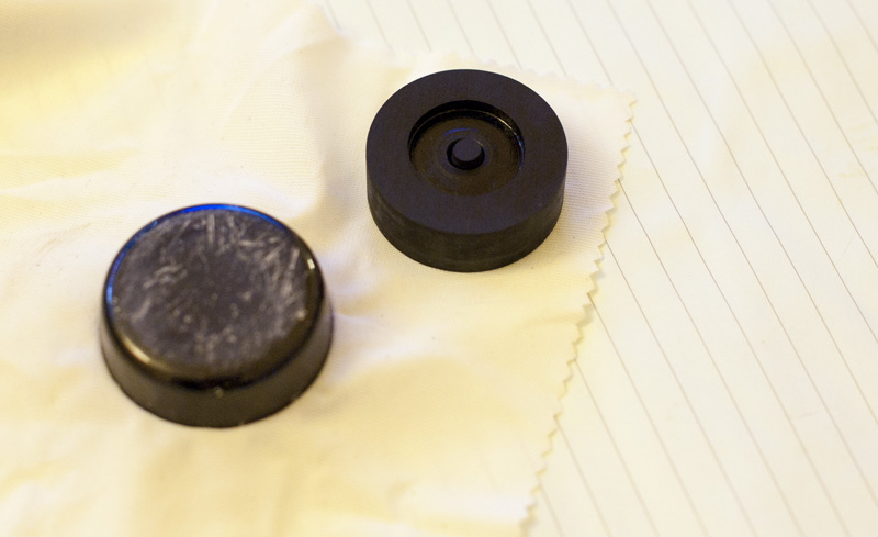

And here is the bottom side. On the left you can see the black rosin.
attachment.php
Now further to the rosin thing...
I made a few tests with the rosin on the puck before started working on it.
The black rosin is very hard. Almost completely solid, and you have to rub it rather hardish to get it on the wood and on the turntable. It seems to work pretty nicely though. I applied some on the turntable too. I hit the door button with no disk and let the turntable rub itself on the surface of the rosin.
After that, even with no puck in place, the mecha could read the toc. No playback though without puck.
I bet that if I tried a softer rosin I could get some puckless action going on a'la Jarek's spider web.
Oh and the 400 grit sanding certainly helped a lot with the disk sliding. Some fast tests before the puck was finished showed some sliding only during stoping/breaking. I bet that now with the tru oil, plus some softer rosin, the puck will be rock stable.
Now to the interesting part. The rosin seemed to have had a significant impact on the sound. The attack I was missing after switching my DCB1 pot is almost back. It could be my new pots breaking in though... Certainly worth further exploring.
