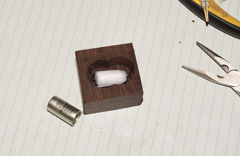

I decided to give the wood/wax a try.
The FT1 was so easy to open with a simple pair of thin wire-cutters.
The teflon was clean, dry and tightly rolled on itself.
The side caps are also nice. I might use them somewhere. Like as a thrust pad for my SL1200 🙂
I applied the wax without issues, and a simple measurement proved that unless something weird happened that is not easily detected, the capacitor remained intact. Its capacity is rock stable where it was, and the dissipation factor again remained at nearly 0. And TBH I was not even particularly careful with it 🙂
That's for those that worry that such an operation ruins the capacitor's characteristics. OK it alters them, but the main parameters remain the same.
Oh and if a type is safer for such operation, that is teflon, since the wax temperature does not affect it at all. Other types like electrolytics might be more sensitive.
On to try it now 🙂
On to try it now 🙂
