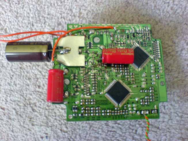

Update on my JVC mods: once AGAIN, I have replaced C906! From the paper in oil which I initially raved about, BACK to the original electrolytic 0.1uF / 50V. For my (or my ears!) there's just something right about this part in C906. I've stopped trying to rebuilt everything with audiophile parts (just because I may have the parts handy) and trusted my ears instead on this occasion. Have a theory that perhaps the laser is adjusted (there's an adjustment pot visable near the laser) with this part in place, which would take into account the EXACT value of the part (in my case 0.14 ohms). Perhaps when replacing C906 the 'ideal' isn't met any longer. Whatever the reason I'm sticking with this part now, and the original clock. To me at least, they are part of the 'magic' of the original sound. Someone mentioned earlier in the thread that with th estock JVC you can almost hear the tautness of a drum when hit - no overhang etc. It was this facet of the performance I seemed to loose with 'upgrading' the clock and C906. I've got those back again now, with all the benefits of a much improved power supply. I couldn't be happier with it now 😀
Today I replaced the 100uF Silmic I had in position C939 with 47uF Black Gate N type.
I also replaced C953 from a Panasonic FM 220uF to - again - a Black Gate 47uF N type.
As far as the board is concerned that's it for the mods now. I'm also tired of taking the thing apart 😉
Time to start experimenting with supports, chassis etc etc etc

Everything I've done is here Puffin, but here it is in one place:
C934 - Black Gate N 4.7uF / 50V
C953 - Black Gate N 47uF / 50V
C929 - Black Gate N 4.7uF / 50V
C906 - Stick with original part.
C916 - Black Gate N 47uF / 50V
C939 - Black Gate N 47uF / 50V
C952 - Elna Silmic ARS 470uF / 63V
X901 - Stick with original.
Hope thats of help Puffin.

There is indeed something special about the original C906. I tried many caps in that position and some of them sounded certainly more impressive, but not neccessarily "right" 😉
Yep exactly what I found - I liked the detail and immediacy of the Auricap, and - initially - loved the rich sound I got from the Jensen paper in oil.
However with the original part the sound just seems to 'relax' somehow and find it's own groove - its free to live and breathe! At the end of the day it just makes music sound real to me in a way the others didn't. Ditto for the crystal as well, at least with my ears and equipment 😉
