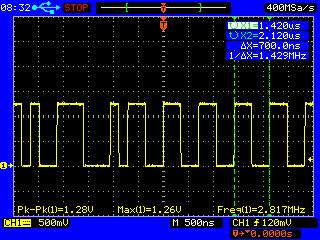

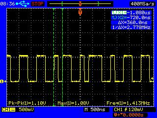

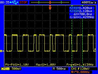

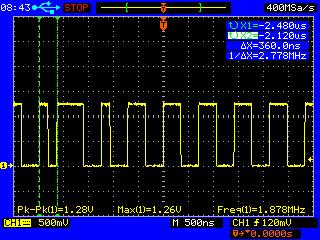

I've finished constructing the my second board and it exhibits the classic spins but does not read from the CD.
Clock is running and within the limits of an oscilloscope seems to be on frequency (16.92MHz).
Likewise, I've measured the data output of both the good and bad units and compared them.
I've been over the components twice, even changing some caps I could not measure in circuit just to be sure they are correct.
I measured all of the resistors using the good board as a reference for values, so they should be good.
Any suggestions?
Any suggestions?

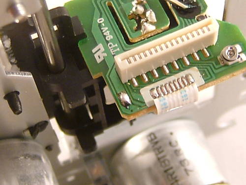

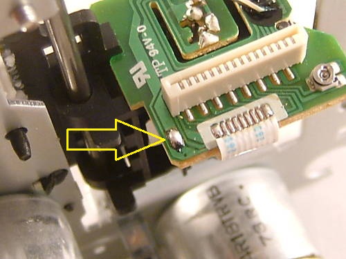

There is only one important point to note.
The laser as supplied new has a solder link in place to protect the it from static electricity damage.
You need to remove this small link with a soldering iron or sharp knife.
This is shown in the last picture of this listing.
It is to the left of the connector on the laser. The laser is also fitted with a protective plastic cover.
This simply unclips and is to be discarded after fitting the mechanism in place.

Laser Solder link...
Rudy,
The only bit of solder in you posted picture is the one to left edge of the board and just left of the connector. I take it this is the "link" you are suggesting needs to be removed?
If that is correct, this information should be noted in the data that comes with the kits and in the "Using the new 2012 Shigaclone..." page.
Tibi...Do the mounted and test units have said link removed?
Rudy,
Yes, you must remove that blob of solder, just as you describe. It's a static protection measure on any of these mechs you buy.

Yes, I removed the solder bridge.
As I said, I have two units, one unit working and one which does not.
I can swap the transport mechanism between PCB sets and the second set always fails while the first unit always works.
