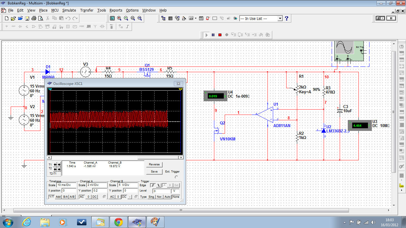

Should the big 3W resistor be 3 or 15 ohm?
According to the sim 15 ohm leads to 0.017A CCS. Am I right?
It should be 3R.

can we use the bss119 instead the bss129?
thank you
Nope....bss129 is available and cheap at Mouser.
I do not see the bss129 at Mouser. There are plenty of the bsp129 available though. I'm ordering some today.

..yess sorry, i meant bsp....

Yep have all the parts except the zvn3310 Found a VN10KM so I ran it in the sim and noise dropped to 3 nano Volts.
Need to get this thing built and see how it performs in the real world.

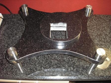

I have taken Granite and glued the Ebony cubes in the corners, and thereupon CD Transport.
Rudy
Rudy
That's stunning.
