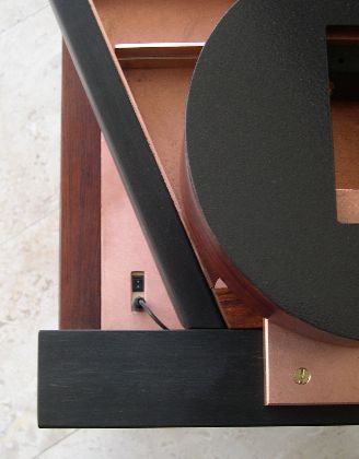

....and a square out of the topplate in order to stay as miniature as possible but still practical by unplugging if you want the display panel loose...or switching the led off (still a freak).....

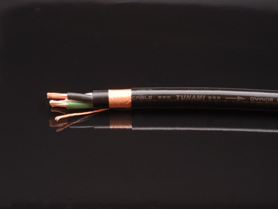

Anyway I have ordered a nice cable the Oyaide Tunami for my transport...a run from the cd-transport straight to the
house-metercabinet.....approx. 5 meters.....the order will take a couple of weeks, so a christmas present on its way.....:Present:
BTW anybody ever experimented with powerchords on the Shiga....it does make an audible difference...my winner is the Tunami with a tad more realistic timbre on the instruments and more micro/micro dynamics...I cannot discover a minus...worth to give it a try 😉
