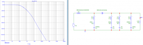

Seems to work perfectly! Simulation is with a 120R load on the end that's just obscured by that notification. I'm making an integrated PCB so no need to worry about it fitting in my case. 😀

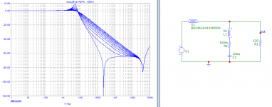

Look up "Series RLC circuit damping factor"
Optimize ESR and value of capacitor to have damping factor >1 with inductor, and then you get no ringing.
Here with 10µH inductor and 100µF cap you need ~500mOhm ESR which means a series resistor is required, that's annoying.
Increase C and L requires lower R for damping, and gives better attenuation
Add ferrite bead (1k@100MHz) and 2x 1µF MLCC, plus a high ESR cheap alu cap on the output to damp ringing between bead and MLCC
That shouldn't break the bank...

If you don't use a post-regulator then the low value 2.2µH inductor makes sense to get low output impedance across audio band. But OP wants to use a post regulator which means higher inductor value is not a problem, which means an extra 65dB attenuation at switching frequency (say ~40kHz) for about the same filter cost.

I do not think the 2 resonances of your filter in the audio band +11dB at 2kHz and 6k will do good for an audio application.
I advise to put 330mohm in series with each cap which will cure the problem and still attenuate 50dB at 100kHz

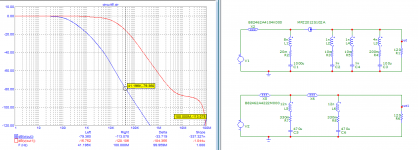

I am busy trying out different values in ltspice to try and get a circuit that is stable 🙂
Question, does the cut-off value actually matter? Or not?
The inductive kick on switch-on goes up to 19V with 100R load, that will kill eventually some op-amps. Important Zeners at the output.
You have to start the simul with 0V across the caps
The data sheet says 150mV ripple to 20MHz that would be reduced to less than 1mV

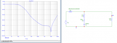

Safe to say that with these specs, it is more than adequate 🙂 inductors and resistor add about 0.79R to the output which should still be manageable.
Inductors are SRN1060-101M, caps are Panasonic EEU-FC1J221. R7 was necessary as otherwise it'd result in resonances and decreased performance.
