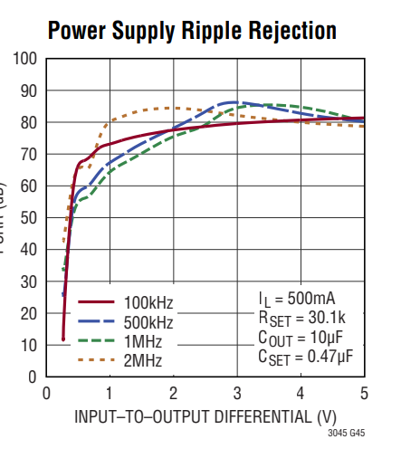

BucketInABucket, I just read the data sheet of RAC20-15DK again and output ripple and noise is 1% of Vout so 150 mV p-p! Yes that is milliVolts.... 53 mV rms so the filtering is an absolute must.
I think it a good idea to have the RAC20-15DK followed by an LC filter and then LDO regs like LT3045 and LT3094. Only 0.235 V dropout at 500 mA. You won't loose much when you set them for example at a safe +/- 14V (check if the HPA accepts this). Rejection will be higher than just LC filtering. Dissipation will be acceptable but you may use separate regulators per channel if you want.

And yes I'm aware, that's why I was thinking about a CLCLC filter. I was also thinking about using 24V versions of those regulators and then regulating down to 18V but that is quite the voltage drop. I think something like a pi filter into LDOs would be an acceptable compromise.
I'm thinking of using TPS7A4701/3301 modules.
Watch out, PSRR of LDOs strongly depends on dropout.

Yes, they will be dropping 6V so should be alright 🙂
The heat will be a real issue to deal with. I don't know why but the LT regs are sensitive to heat. TPS regs are OK too. The LC should be capable to get that 53 mV down and the regs will make it work like a good linear PSU would have done: quiet.
