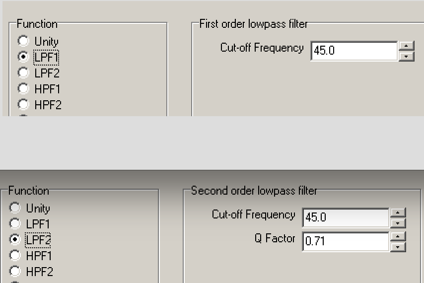

Filter recommendation (using Hypex Software Design)
Also in Hypex filter app there is no way of changing Q for a 1st order filter. Also, there is only a 1st and a 2nd filter option. By varying Q, you get Chebychev, Butterworth and LR etc. By cascading the 1st and 2nd filters and using Q where possible gives you all orders and shapes filters possible with electrical components as this is IIR. FIR is another ballgame - that screws with reality 🙂

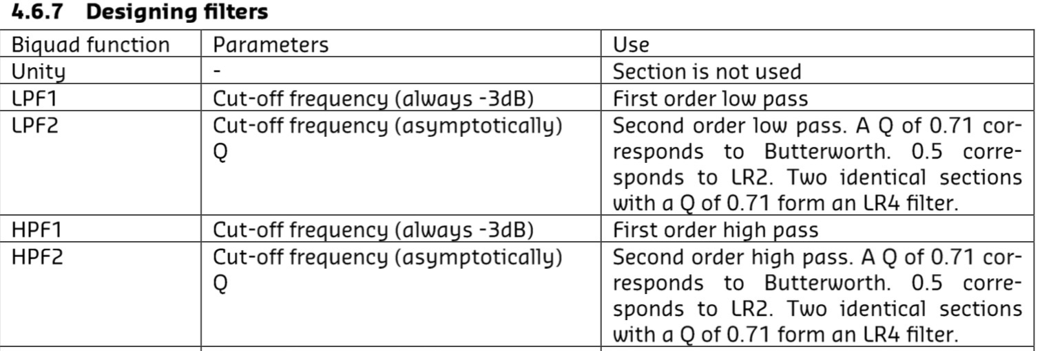

Attchment 2: From DLCP manual re filters...

If they result in a true 2nd order LR transform of the drivers than yes, one driver should be inverted. I can't answer the second question, but if it is possible then I would think it is by introducing delay, which may not be desirable.
Tony.
Using digital 2nd order Linkwitz-Riley filter does not necessarily results in an acoustical 2nd order LR slope. But if the results by applying (whatever) filters are acoustical 2nd order LR slopes and the driver's acoustical centers are in equal distance (or time aligned e.g. with DSP) to the listening (or measuring) spot then you need to flip polarity on one driver to get flat frequency response and maximal reinforcement from the interaction of the drivers on that (main) axis.
You can reverse the driver polarity by connecting reversed or can be digitally in the Hypex software. You get exactly the same results in both ways but imo the digital reversing are recommended to reduce future confusions (and just one click in the software).

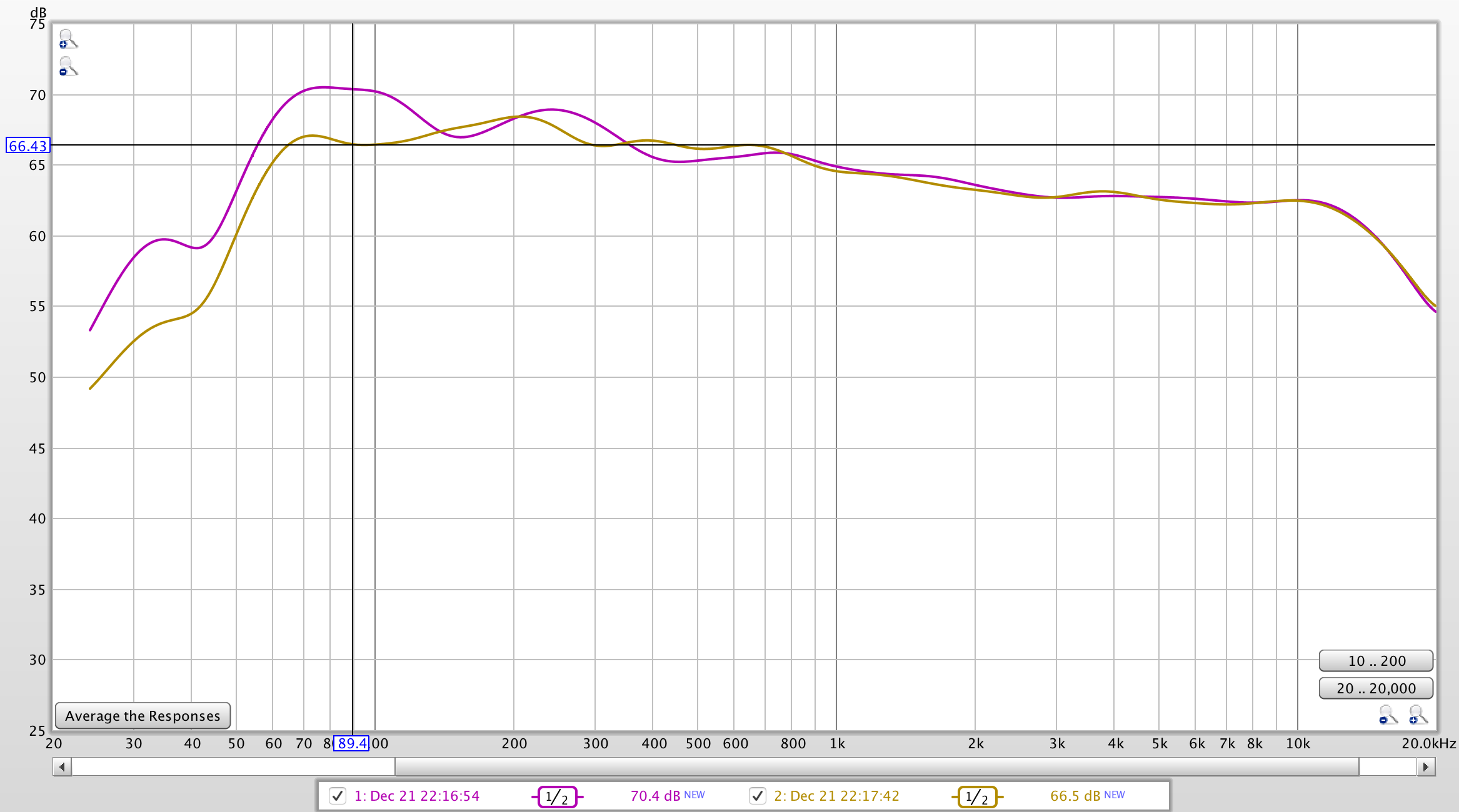

Crossover at 350 Hz and 2000 Hz
Measurment 1, 2 & 3: Linkwitz Riley 2nd order with inverted (digital) mid, smoothed lines.
LR23502000-Hz — imgbb.com
Measurement 4, 5 & 6: Linkwitz Riley 2nd order without inverted (digital mid), smoothed lines.
LR3502000-Hznoninvertmid — imgbb.com
Measurement 7, 8 & 9: Linkwit Riley 4th order
LR43502000-Hz — imgbb.com
Full sweeps:
LR2 with inverted digital mid
Full-Sweet3502000-LR2yes-invertmid — imgbb.com
LR2 without inverted digital mid
Full-Sweet3502000-LR2no-invertmid — imgbb.com
LR4 without inverted anything
Full-Sweep-LR43502000 — imgbb.com
"Standard" span of y-axis level is 50 dB so that everyone can make an immediate grasp of whats going on 😉
PS: In my sofa... heavy smoothed...

Well I got a nice plot with the settings LR2 (350 and 2000 Hz crossover) with inverse polarity on the mid and 100 us delay on tweeter and bass. All though the bass delay seems less logical, I've also build a preset with no bass delay.
This 100 us came from REW with a 1000 hz - 5000 hz short sweep with acoustic timing measurements and muting first base, then mid and and then both (for tweeter delay) and sweeping.
The overal result is great sound so far, outperforming no delays, no inversed polarities (at mid) with LR2 350/2000 Hz.
