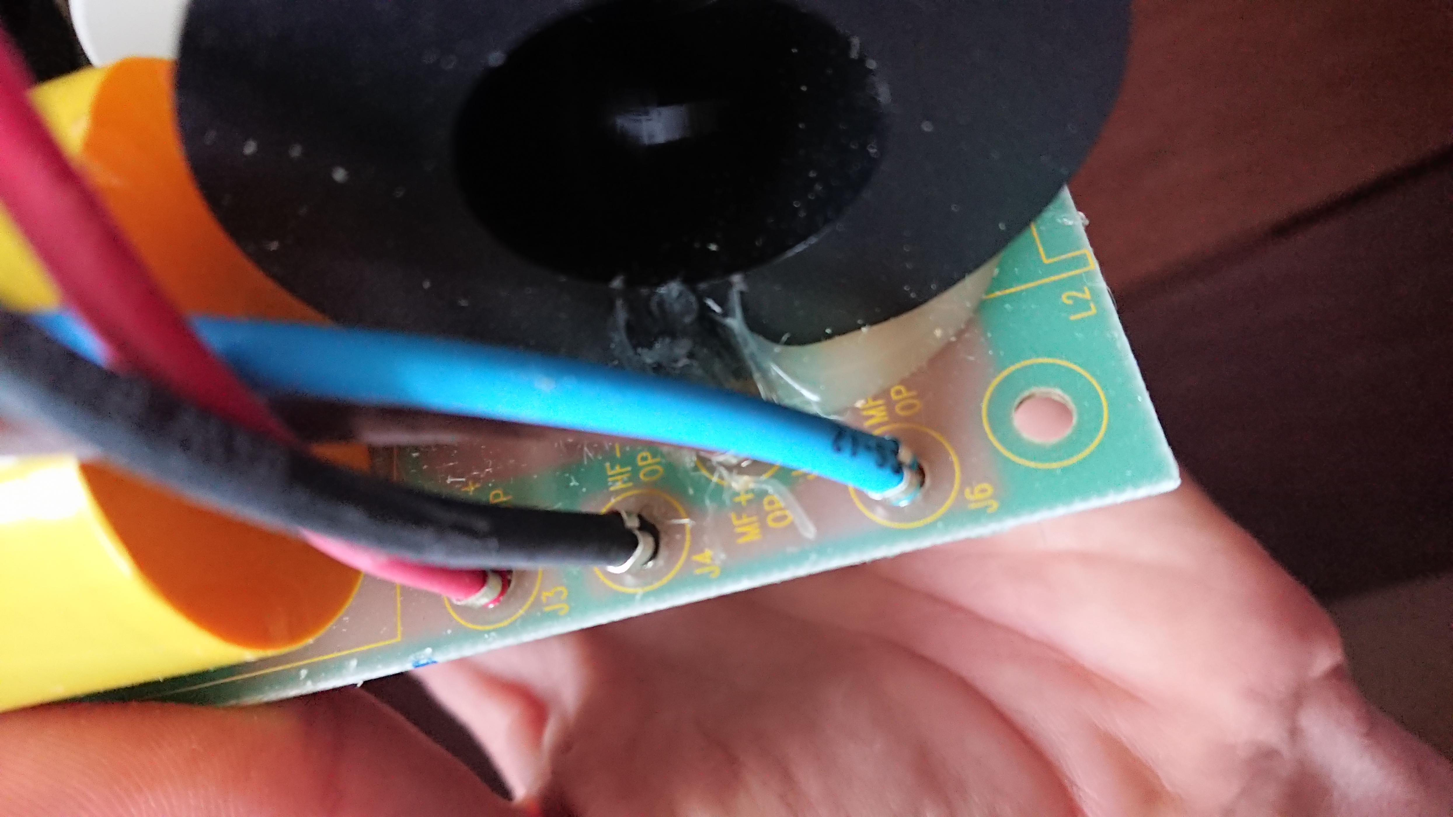

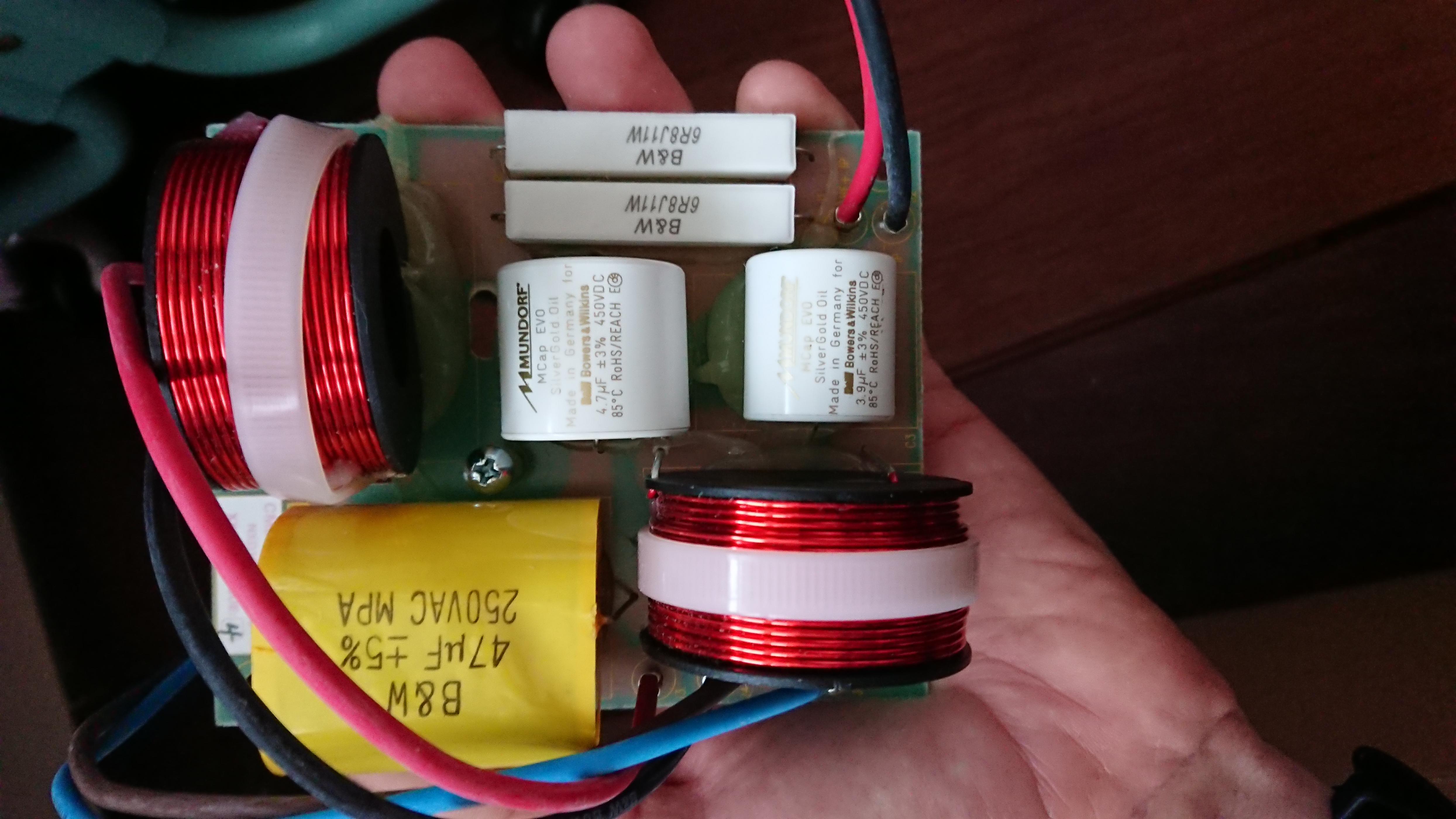

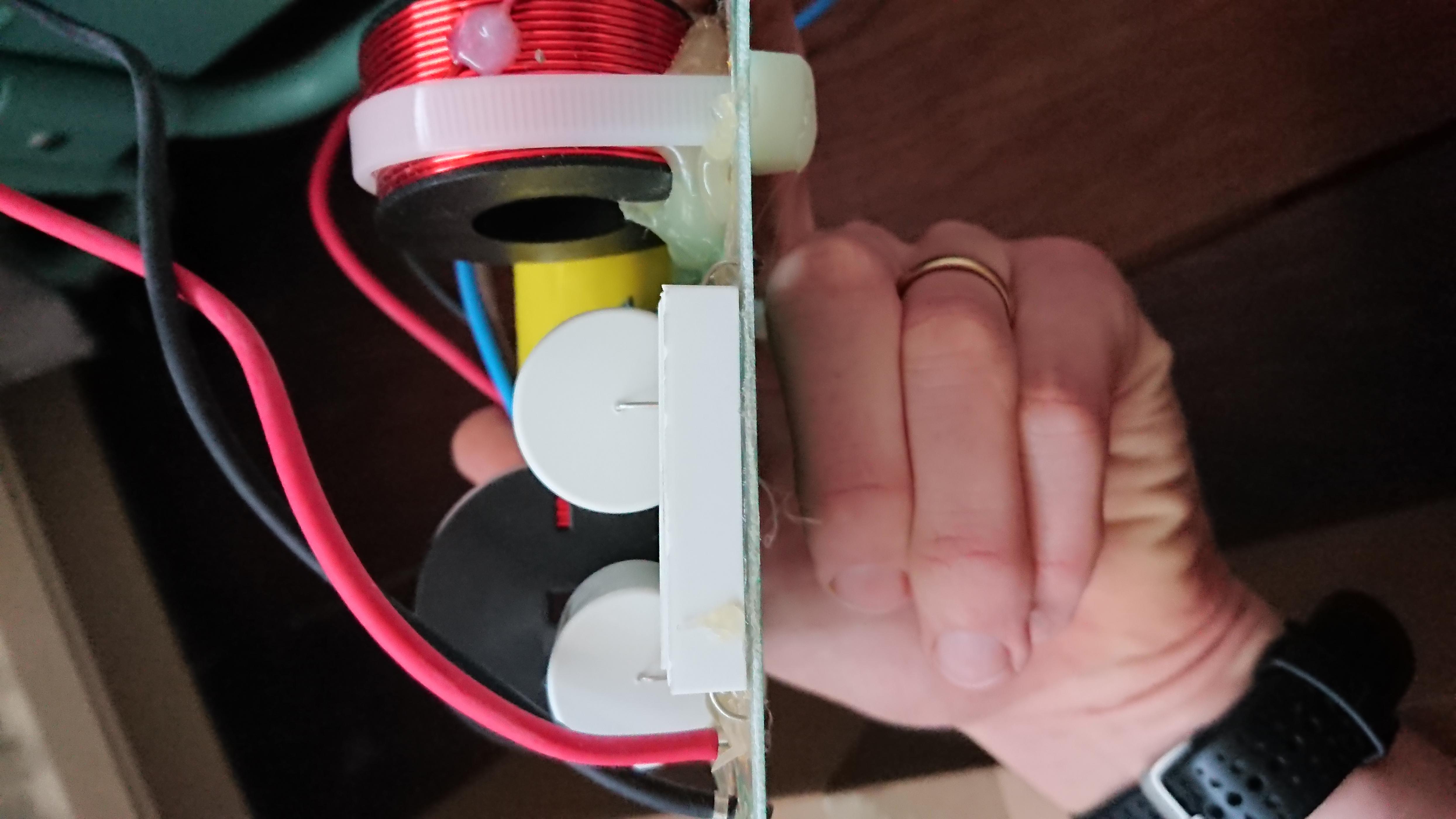

I don't know what you've done but those didn't come through as expected. Did you use the [Manage Attachments] control below submit reply?Here are the original mf hf photos.

I can't seem to upload te filter photo's due to permission problems. Strange, I'll try and use my computer when I get home.
And that last one that didn't work, was that the soldered side of the board, a most important one.
