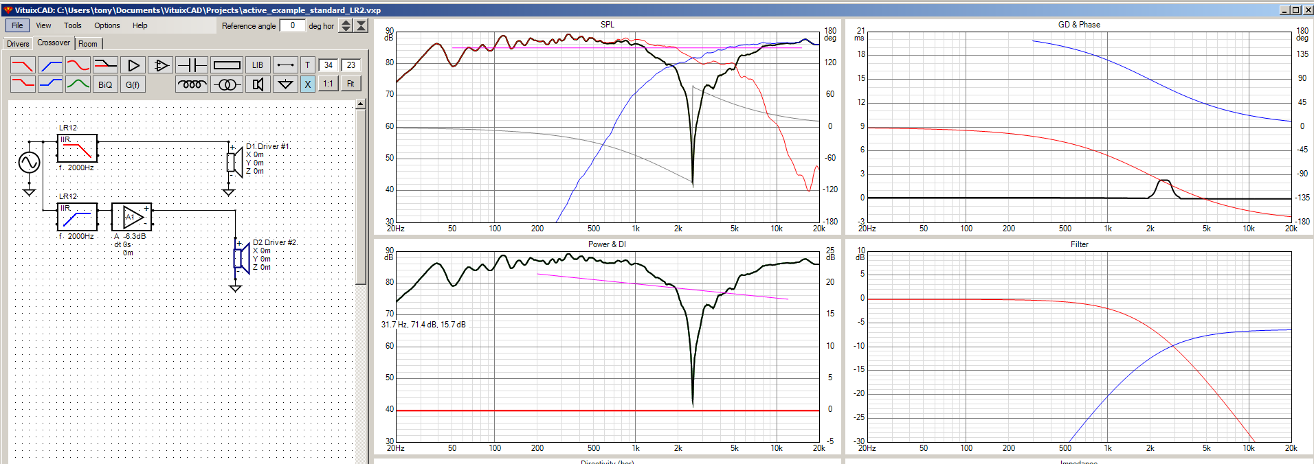

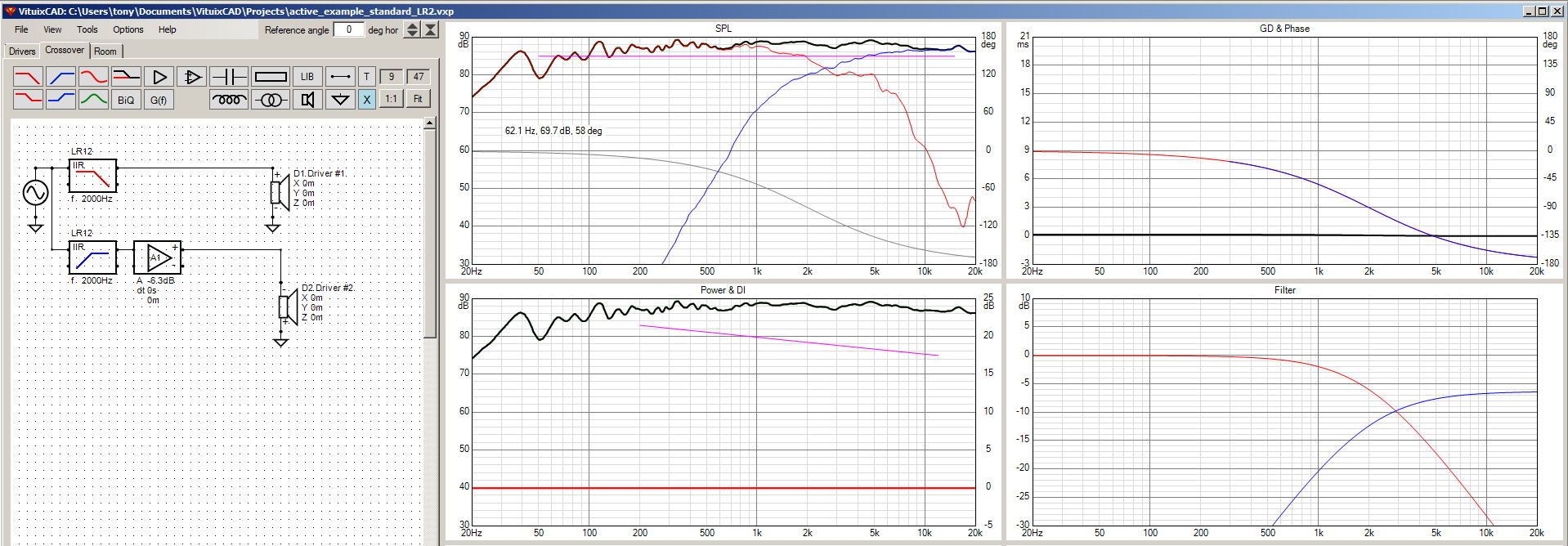

Here is a quick sim I did to show the difference between using stock LR2 filters, and custom filters. Both 2nd order at 2Khz. The standard LR2 filters when you take into account the drivers responses do not result in an acoustic LR2 roll off, and the crossover point is not 2Khz as intended.

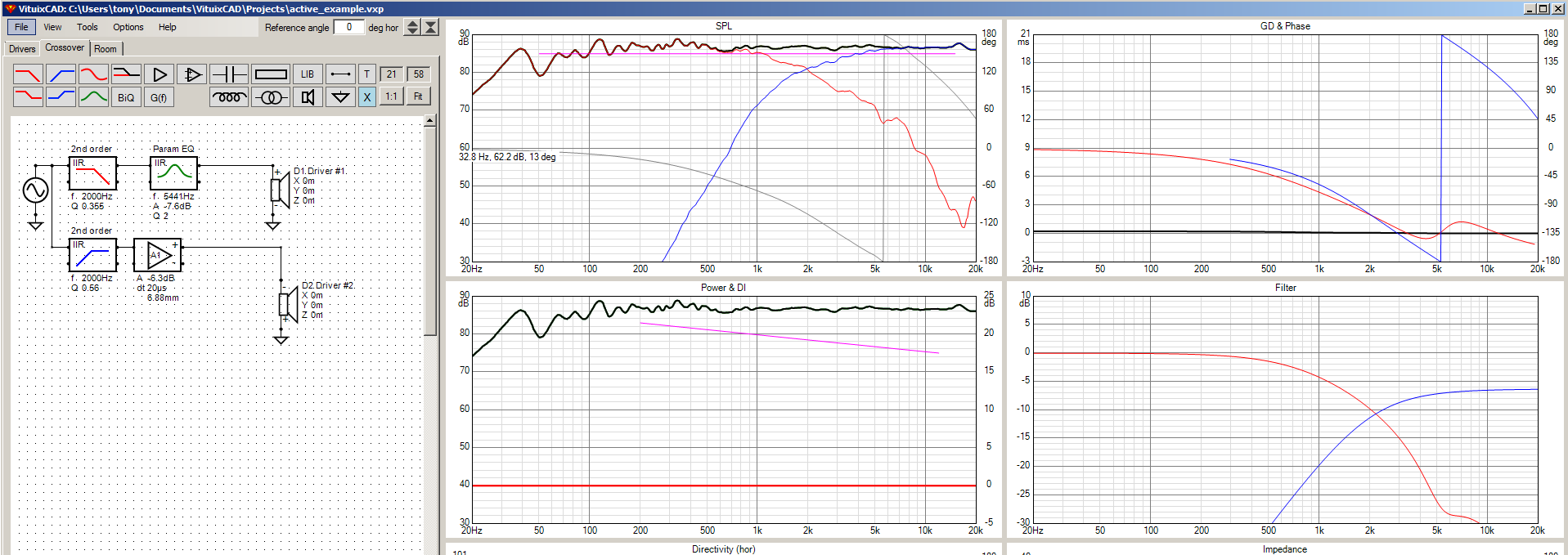

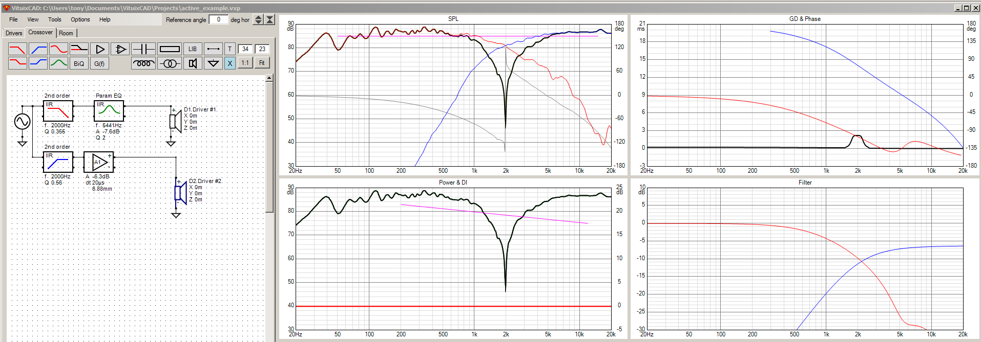

The second pic is with custom Q's on the filters to get close to the desired 2nd order acoustic rolloff at 2000Hz. I also had to put a notch filter on the woofer to get rid of the breakup, and 20uS delay was added to the tweeter.
I just used a couple of drivers I had some frd files for.
Hope this makes things clearer.
edit: added reverse null comparisons as well.
