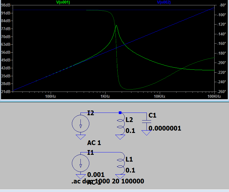

Is there any practical case where you get 0,1uF out of a typical coil?Whether that's the point may depend on the circuit in question, but at the least the impedance will fall away.
Generally speaking when the knowledgeable people simplify their knowledge there's a risk it will become open to misinterpretation, or to amplify a misconception.
The simulation is not based on an actual part. The effect is what I wanted to show and the values are arbitrary.

But quite useless if shown values cant occur in reality with a real single coil - and probably confusing for OP. I assume you speak of "equivalent capacitance" of a coil...The simulation is not based on an actual part. The effect is what I wanted to show and the values are arbitrary.

I wrote it on purpose to make the similarities to an unwanted aspect of a coil - the equivalent resistance 🙂

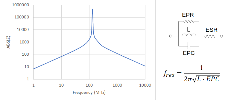

I read that there are two parasitic resistances associated with a non-ideal inductor: Equivalent Series Resistance (ESR) and Equivalent Parallel Resistance (EPR). And let's not forget the Equivalent Parallel Capacitance (EPC)!
EDIT: I should really credit the above illustration: https://resources.system-analysis.c...t-is-the-parasitic-capacitance-of-an-inductor
Live and learn - truly, I just winged it 🙂 One should also observe at what frequencies these parasitics have a real effect on.
It is also a common problem at audio frequencies especially with line level passive crossovers, input and interstage transformers and phono cartridges, but also at speaker level in audio output transformers, where in each case this specification is essential to look at. In most cases it can be seen to lower in frequency as the core is reduced and the coil is made larger to obtain the needed inductance.
It is something any inductor designer needs to know and would measure.
