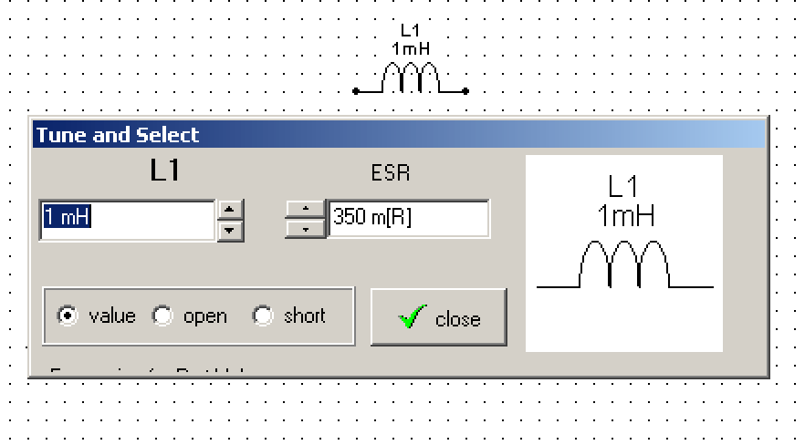

- The DCR is what I enter in the Z option of the coils tunning in software like XSim. DCR is took by continuous current measurement, so the Z after is constant whatever the frequency. It is the internal loss of the coil and not its ESR (this last always related to a frequency)

"The DCR is what I enter in the Z option of the coils tunning software like XSIM." - are you sure its called "Z" option in XSIM - this is how mine look:
DCR is to be entered as ESR. You write "continuous current" - its called direct current or DC - hence DC R 😉

- "It is the internal loss of the coil and not its ESR" - vocabulary again - the reactive part (the pure L part) of a coil that varies with frequency is a desired property, not a loss - what is actually/usually seen/described as a loss in an inductor is the ESR 🙂
- "not its ESR (this last always related to a frequency)" - the last (ESR) is what is not related (dependent) to frequency.
The ESR part of an indictors impedance don't change with frequency. The reactive part of an indictors impedance (the "pure" L part) change with frequency.

Yes, ESR is only from inherent resistivity of the wire excluding inductive effects and is the same regardless of the current type (AC or DC), so DCR is ESR on the otherhand impedance Z (occurs from the inductive effects) is frequency varient and so the total resistance at a specific frequency is the ESR + Z (generated by inductive effects).
