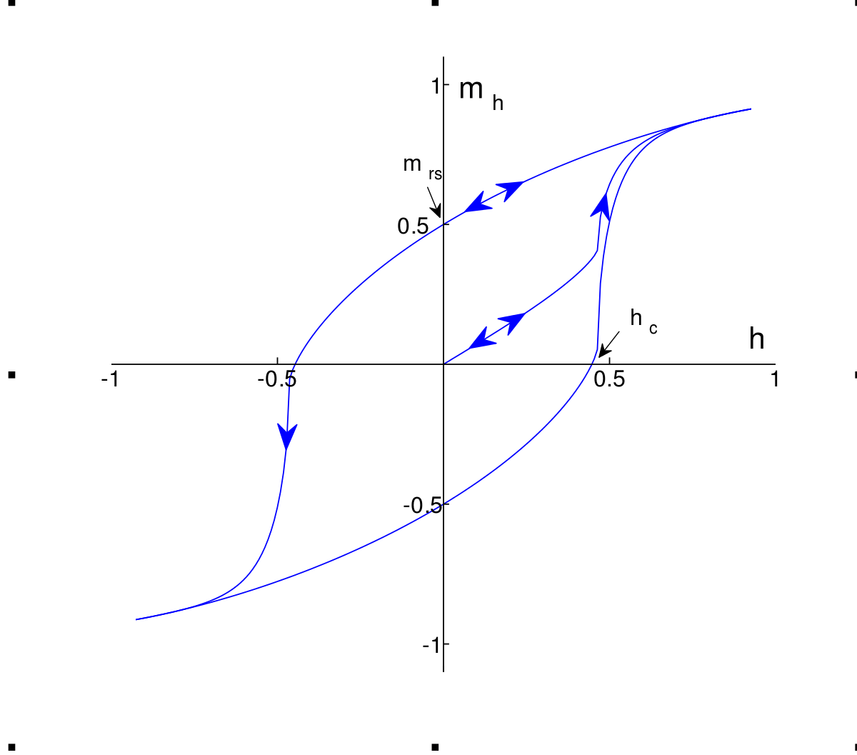

There's two types of distortion associated with the core materials. I'm assuming you're referring to saturation distortion, which only occurs when a large enough current flows through the inductor, and likely won't happen at home SPL as you say. But there is also hysteresis distortion, as it takes an amount of energy to flip the magnetic polarisation on the core material. This energy can be pictured as the area under the signal power curve, when you have a low frequency there is a long period t, and so a large area occurs, for a high frequency there is a small area, assuming both signals have the same RMS power. So the proportion of energy being used to counteract hysteresis increases with frequency and therefore waveform distortion, the area in the hysteresis loop is analogous to the energy lost as heat. This is in addition to the nonlinear magnetic response to the field being generated by the inductor wire, as the coercivity of the magnetic material causes the magnetization of the core material to be opposite that of the input signal, up until the coil field is more than the coercive field required to flip the polarisation. Air cores don't have either the saturation or hysteresis issues, air is paramagnetic so linear magnetization with external field, ideal as long is you ignor the lower susceptibility of air, thereby requiring a longer wire for the same inductance, so cored are much better for low freq applications.As far I understand most of t<he good enough iron core are not distorsing at spl home level, so the ferrous core coil are good enough with the good plus of low DCR.
In the image H represents the field provided by the coil and M represents the magnetization aka the field generated in the material as a response to H. Hc- coercive field and Mrs- remenant magnetization at zero external field H.
