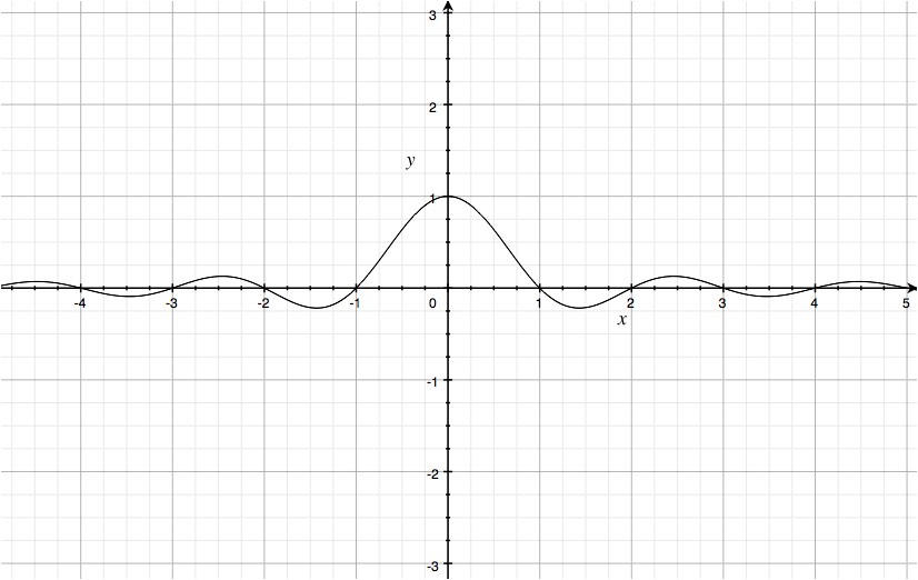

sinc is a mathematically ideal lowpass filter with vertical cutoff and no ringing.
The equation is sinc = sin(pi * x)/(pi * x) which when plotted looks like:
attachment.php
You should recognise the shape of the impulse from all the linear phase filters that have been posted to this thread.
While sinc is an ideal low pass filter, the ripples to each side continue to infinity. This is a problem when you have a limited number of poles/taps available. The DAM1021 can use 1016 taps/poles for 44.1 filters. If you simply truncate the ripples you get high levels of distortion.
This issue is addressed by applying a windowing function to the sinc filter.
Interpolation is a result of applying a low pass filter to the data.

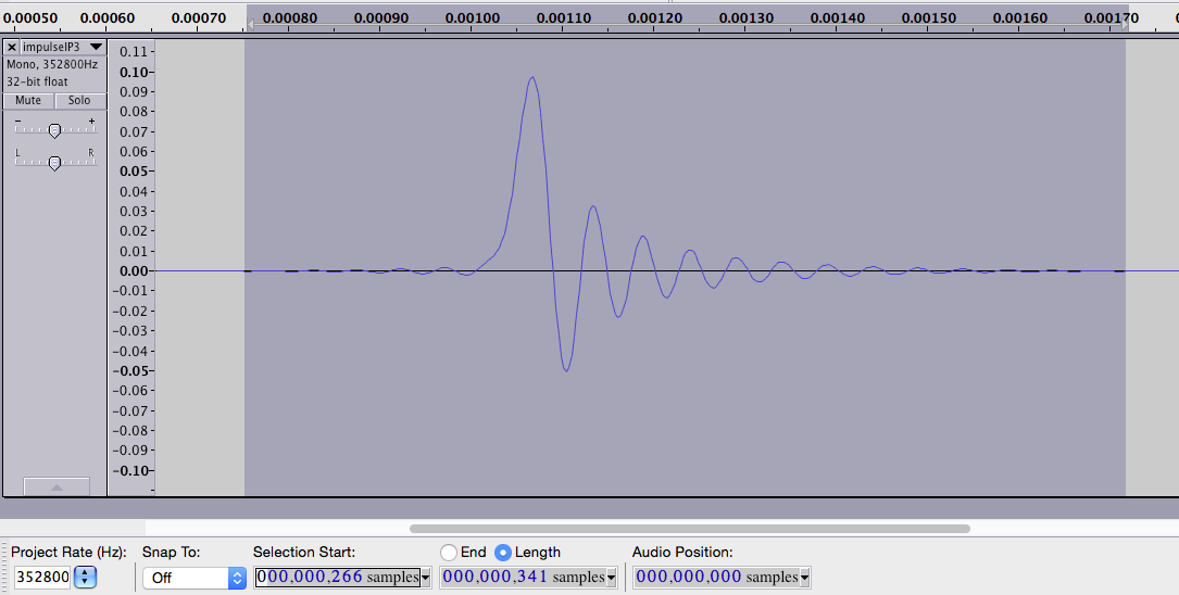

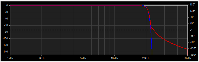

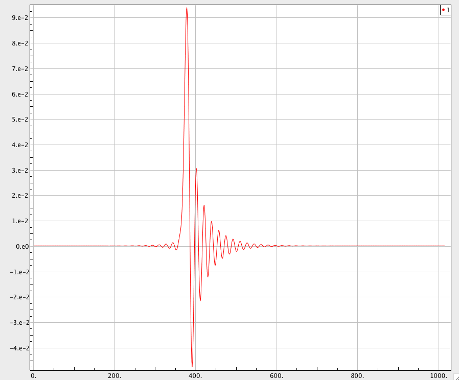

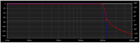

Here is an Intermediate Phase filter. Wanted to target the character of most natural sounding 030 sample in post #49 at Mastering Captured Vinyl For CD - Hydrogenaudio Forums (where they make the effects of filter phases quite noticeable by bringing the stop band into 4kHz).
Adjustments are made by visuals and listening without measurements, so I may well be very far off it. But I like the sound listening to it in the past few hours. My intention is to have a satisfactory filter on dam1021 for a variety of genres so that I don't bother with changing filter presets.
Filter is steep, stops at around -60db Nyquist according to rePhase. Pre-ringing is negligible, but helped reducing post-ringing amplitude. Arcam FMJ D33's Filter 1 helped settling on these values.
I used blackman-nuttall windowing and adjusted centering for IP in rePhase after Pos' suggestions in vendor thread.
Attached are two versions of the filter (0db and -6db against possible clipping for those who don't have volume control) and the mandatory specs charts.
I couldn't plot a nice impulse response in REW, and Holm doesn't seem to support sample rates higher than 192kHz. Attached impulse responses are drawn in ClickPlot from the text output and in Audacity from wav output.
Any suggestions for achieving an accurate 30% IP and lowering the noise floor without adding further ringing are very welcome.
I can post rePhase file if anybody is interested.
Cheers.
