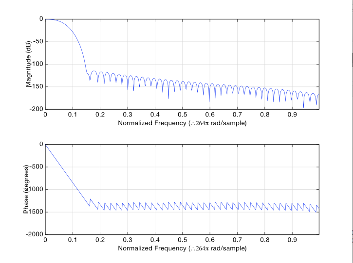

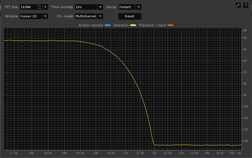

If you want to visualise the effect of the filter you can use SoX to do so. It won't be exactly what you'd get from the output of the DAM1021 but still better than nothing.
The way I've been doing it is:
Code:
sox  /path/to/input.wav -r 352.8k /path/to/output.wav vol 8 upsample 8 fir /path/to/firfilter.txt
If you see clipping errors reported, drop the vol setting by 0.1, rinse and repeat, until you get no errors.
The output file will be up sampled to 352.8k have the selected fir filter applied. You can then open up with Audacity, Baudline or your preferred spectrum analyser and see the result. Anything you see above Fs/2 is a mirror image.
On OS X you can drag files into the terminal to insert the file path which makes a bit easier.
If you want to see what filter curves SoX is outputting with various the guru tweak settings grab a short - 3 seconds is heaps - .wav containing white noise. Google should turn up a few sites that have online test file generators, these are fine for the task.
Code:
sox /path/to/input.wav /path/to/output.wav gain -h 0.1 rate -m -I -b 90 -p 28 352.8k
The gain -h 0.1" setting provides 0.1dB headroom for any following effects, and might need to be adjusted to avoid clipped samples.
"rate" is used to upsample, interpolate and dither. Settings in this case are those posted by John Swenson in a thread linked earlier:
-m medium quality
-I Intermediate phase
-b bandwidth as a percentage of nyquist or fs/2 (= 19845 Hz for 22050Hz)
-p phase setting, 0=minimum, 50 = linear-phase. 28 is a intermediate phase, slightly biased toward linear-phase.
352.8k = target sampling rate.
You can then analyse the filtered file and get fairly accurate idea of the filter curve. Don't pay too much attention to the absolute dB values - look at the values relative to the passband. Not sure how you recover the phase information.
Screenshot attached.

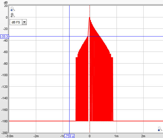

Missing rePhase file in post #141 attached.
One of your new links in the first post helped me understand what REW impulse plot is about, it's in dBs!
So I'm attaching that version of the impulse response as well. I aimed a 30% IP. If this calculation is in decibels, I hit the mark at 26% (bottom of the ripples is about -69.5 dB).
I will work with the filter again after analysing it with your SoX method, probably next weekend.
Cheers.

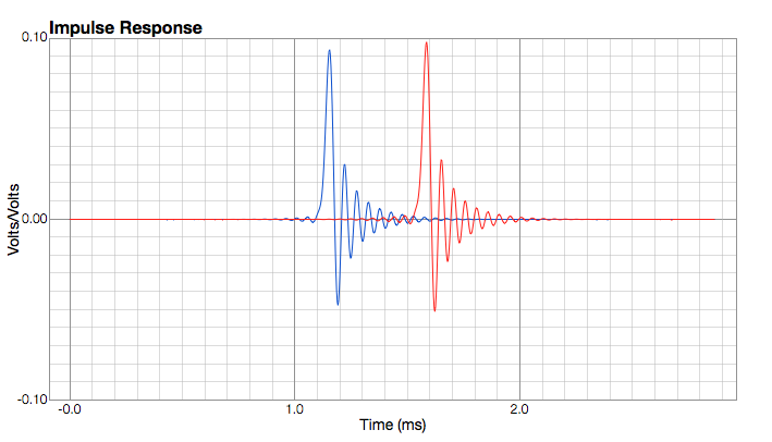

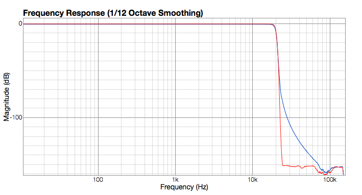

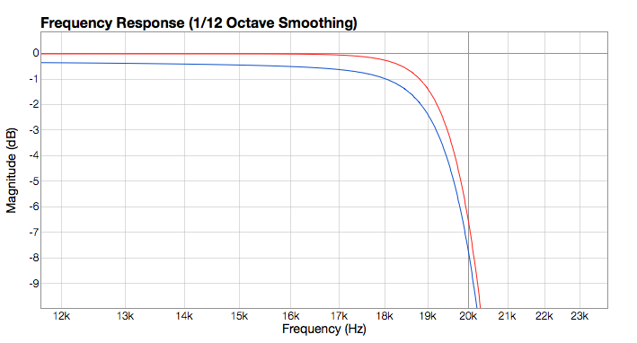

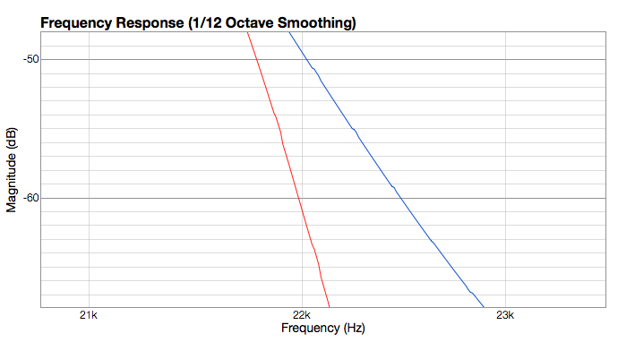

Change centring to "Middle".
Red is centering = middle
Blue is centering = 35%
Slightly more pre/post ringing but a massive improvement in stop band rejection at Nyquist. There is about 1.5dB less roll-off at 20kHz using the "middle" setting.
I've added a couple of zoomed plots showing the difference at 20kHz and 22kHz. You can see the reduction of roll off at 20kHz mentioned above and 10+dB improvement in rejection at 22kHz resulting from this single change in configuration.

Reduces ringing length and amplitude as well... hmm. We need Pos to to explain why he recommended intermediate centering values for IPs. Pos, where are you?
That said, I'd be already happy with original roll-off, better than I expected.
I'll try this version as soon as possible. And proceed with porting it to higher sample rates.

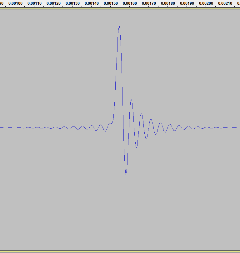

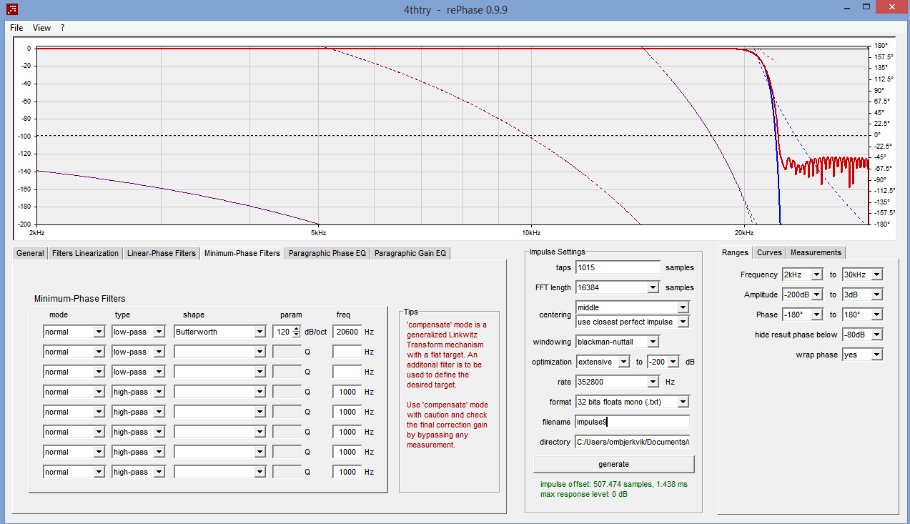

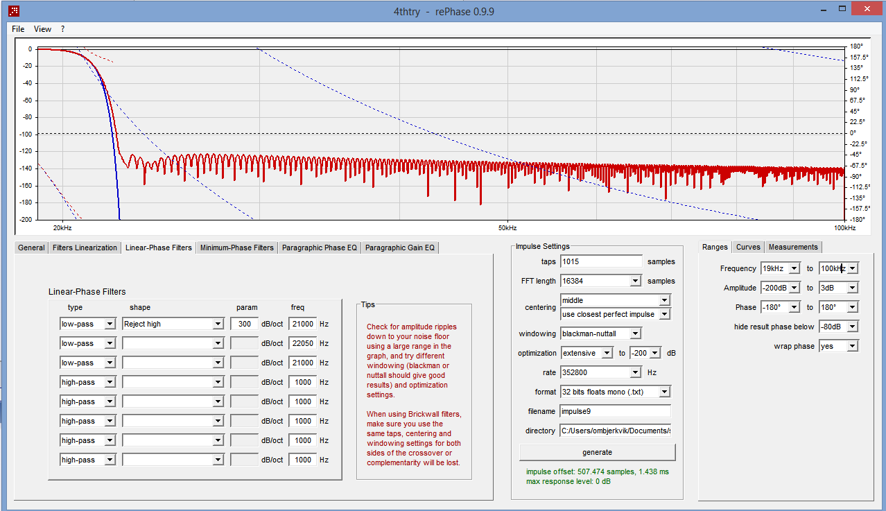

Hi there.
Have tried different filters and I am in the process of "filter brewing" myself.
Feel free to try.
Notice: Fairly new to this but I think it sounds good.
However with some of these filters the difference in sound is quite marginal.
Impulse response is done with audacity.
The 22.050khz is down at -80db or so. A minimal phase combined with linear. Little faceshift in the 2-5khz region.
We are down -1db at 20khz.
The .rephase file, .txt and .skr are in the zip..
Hopefully I am doing this right?
EDIT: Looks like it is somewhat similar to leehans IP filter
http://www.diyaudio.com/forums/digi...ilter-brewing-soekris-r2r-14.html#post4231740
Havent tried that one yet.
Best regards
  • 4thtry_combined.zip
    4thtry_combined.zip

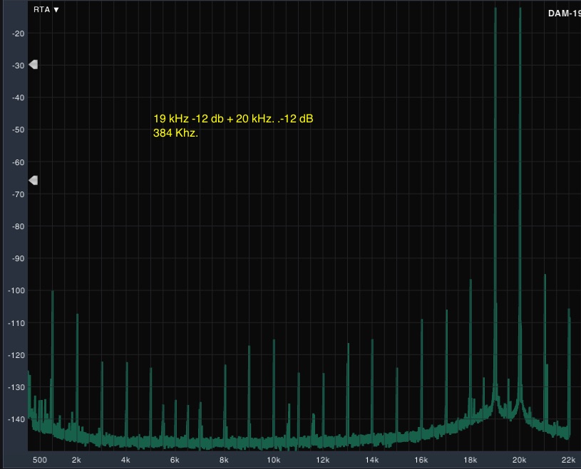

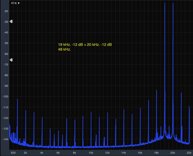

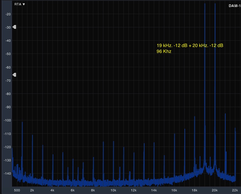

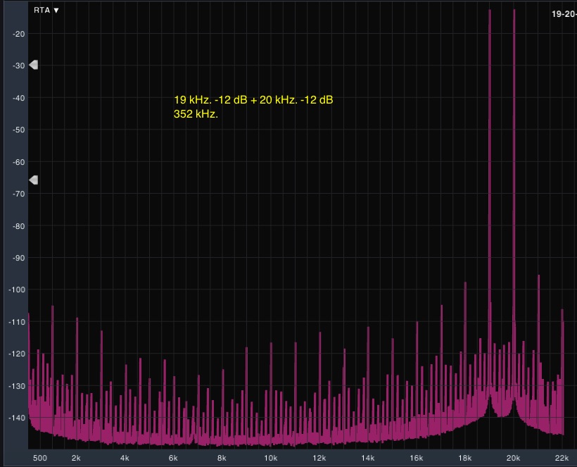

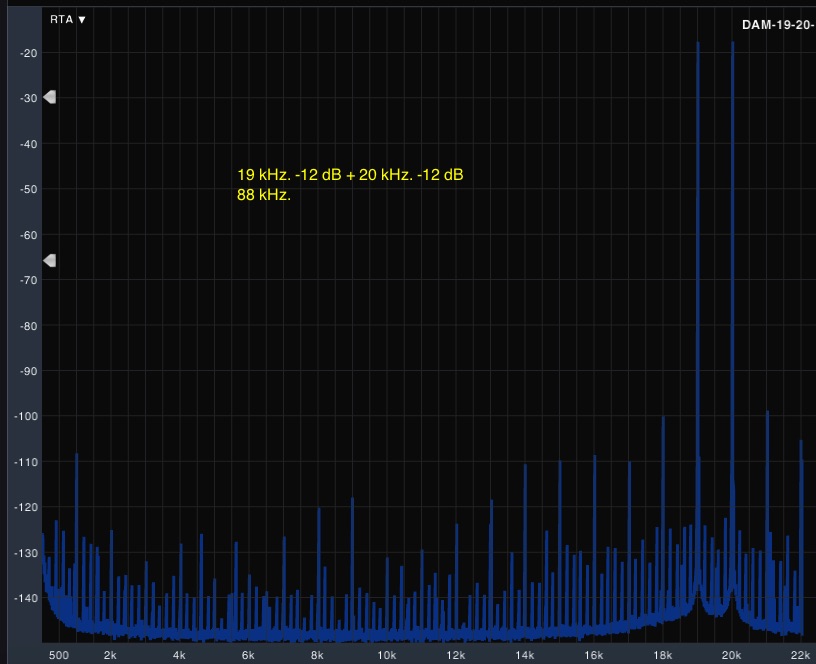

I tried all filters. The best sounding in my opinion is 1021MinPhaseSlowrev1.skr of spzzzzkt. And also those measures i has made are best.
But there is a problem with the measures. All filters of 44,100, 88, ... 352 have noise, saturation, rounding....?
I see in all measures i made, 1k, jitter j-Test, or 19 kHz. -12 DB + 20 khz. -12 dB.
So I gather that is 352 F2 filter problem.
This problem does not occur in 48, .... 384 kHz. measures.
Spzzzzkt please could you design a filter F2 352 kHz. with similar characteristics to 1021MinPhaseSlowrev1 44,100?
