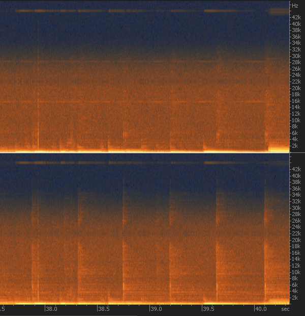

Ok... I've been investigating SoX and it looks like it's basically doing zero insertion upsampling, then applying tweaked FIR filters and dithering to the upsampled audio. This is basically same as what the DAM1021 is doing, but the SoX method only allows you to tweak without actually seeing what you are doing. That is probably over-simplifying.
Anyway I realised you can apply the FIR coefficients from rePhase to audio files using SoX which I'm sure SoX users already knew... Given the upsampling is roughly the same, it's a nice way of visualising what is happening to audio files in the DAM1021.
One of the things I hadn't realised is that with the filter bypass you cannot apply gain to the file without it clipping. It's a bit bizarre because the file sounds quiet, but when you look at the spectrum you can see why. The image below shows a short section of the intro to So What upsampled x8 with SoX with no other processing.
attachment.php
As can be seen the file contains two channels each with base image and seven mirrored images. The total energy at any point is the same as the un-upsampled file - the level meters are identical BUT the level when played back is signficantly lower. If you increase the gain at all SoX reports 1000's of clipped samples. The NOS config I posted had gain set to x8.
So I now understand why the NOS filter sounds harsh 🙂
This means that the NOS filter files need to be altered so there is no gain applied to any filter that has a bypass setting. The trade off is that level will be low and the DAC will clip if you set the gain any higher than V+00.
Next screenshot is "AirListen" filter coefficients applied to the x8 upsampled sound file.
attachment.php
You can see the audio mirroring around 22.05kHz with some sub-2kHz audio showing up between 42-44kHz. There is no mirrored audio above 44.1kHz.
I've tested a couple of filters against a 0dbFS sine test tone to see if retaining the mirrored image always causes clipping. This doesn't appear to be the case. The AirListen filter didn't cause clipping, but an apodizing filter I was trying out - which has no content above 22.05kHz - did cause clipped samples. I'm not 100% sure of the cause of this, it may be the filter is peaking where the roll-off begins.
More to come, but there are already some clues which will help build better filters.

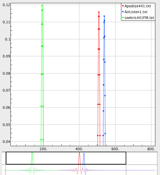

Just had the idea to try Soren's default filter coefficients to see how it behaved on the 0dBFS sine test file.
Code:
sox  0_16.wav -r 352.8k 0_16_Sok441.wav upsample 8 fir Soekris441FIR.txt vol 8
sox WARN vol: vol clipped 54830 samples; decrease volume?
sox WARN dither: dither clipped 49403 samples; decrease volume?
The command sequence changes the sampling rate of the file to 352.8k with the "-r" switch, up samples the input file x8, applies the FIR filter described in Soekris441FIR.txt (a rePhase .txt output file) and adjusts the amplitude by 8dB to correct for the amplitude loss of the upsampling process. This is about as close to the process Søren has described for the DAM1021 as I think we can get using SoX.
What leaps out is the large number of clipped sample being reported. If also occurs in the DAM1021 it would go a long way to explaining why the default filters - and some of the user generated filters sound "shouty" or harsh.
Attached is an image comparing the impulse peaks of the Stock 44.1 filter, the AirListen1 filter and the Apodizing filter I'd made. The Soekris441 and Apodize441 both result in clipped samples when used with SoX. Soekris441 results in 54830 clipped samples at the volume adjust stage, while Apodize441 results in 30 clipped samples.
Søren has commented that there is some kind of compensation for the filters to prevent over saturation but I'm not sure if will prevent clipping. I guess this is something we need to find out.
