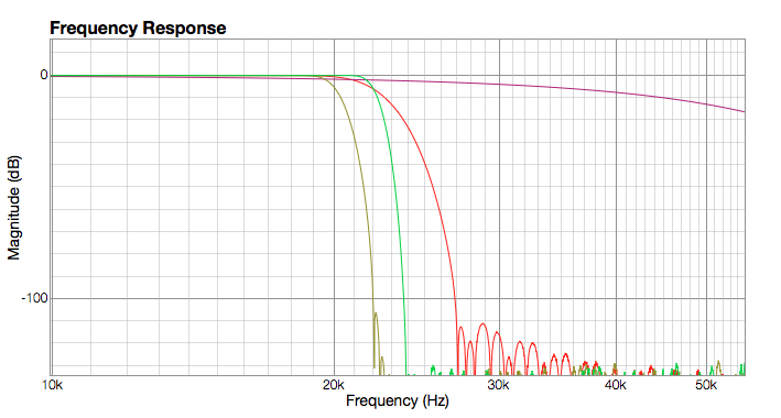

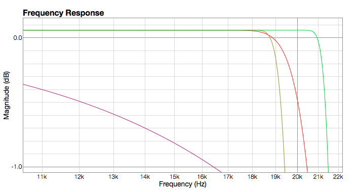

This is a comparison of the frequency response of the filters you mentioned.
Red: 384_C130_MP, Olive: CT1014_60, Green: C960_140dp, Purple: 16_C130_MP

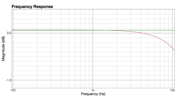

Response below 10kHz for the same filters. showing essentially flat response for all expect the 16_C130_MP, which is -0.3dB at 10kHz. The 16 has very slight rolloff from 0Hz so should sound tilted to the bass if anything.
Looking at the start of roll-off ( 0 to -1dB, offset from zero is just that I ran out of adjustment in graphing software), The "16" is obviously rolled off, but others are essentially flat to 18kHz.
So it would seem with the exception of the 16_C130 there is no obvious reason that these filters will sound particularly different based on frequency response. At worst you'd expect slight differences in "air" and "detail", but certainly not bass/treble shifts.
So if the response is essentially flat we have to look elsewhere...

The question is then, if frequency response is not the determining factor, what is?

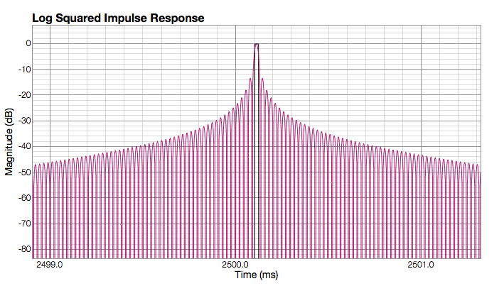

The most obvious factor is impulse response, and we have looked at this earlier in the thread. Mike Pflaumer describes the effect in one of his patents and points out a relationship between the width of the log squared impulse response in milliseconds and the size of the sound source being reproduced.
Pflaumer also suggests that the response above -80dB is sonically significant, but adds the caveat that the main response and the first pair of side lobes have the greatest impact.
The impulse width of the NOS FIR in response to a 1 sample impulse is around 0.02ms.
Being lazy I'm using the calculator at Frequency formula period time frequency cycle per second hertz Hz amplitude duration periodic time period to angular frequency formulary wavelength acoustic equation relationship wavelength Hz millisecond ms calculation calculate calculator t=1/f Hz
If we punch in 0.02ms we find this is a frequency of 50kHz.
Following Pflaumer,
speed of sound at 20°C at sea level = 343m/s
0.02ms = 0.00002 seconds
343*0.00002 = 0.00686m = 6.86mm
So with the NOS impulse any sound source smaller than 6.86mm will sound as though it has rolled off HF. As this appears to translate to 50kHz it's not a huge issue. There are no side lobes to influence the way the NOS filter responds. My take on this is that the NOS filter give the most accurate tonal balance, simply because it doesn't smear energy in time based on amplitude and frequency.
Looking at the 384_C130_MP the difference is quite apparent. The main impulse is broader, and at -10dB the side lobes start to influence spread of energy. Taking the -10dB point the time span is around 0.07ms. Using Pflaumers formulation this means a sound source that is smaller than 24.01mm will be smeared and lose apparent HF energy. In terms of wave period, 0.07ms is roughly 14.285kHz.
At -20dB the width of the impulse is 0.2ms, and sound sources smaller than 68.6mm will start to be smeared. This corresponds to 5kHz.
At -80dB the impulse has spread to .67ms, the equivalent of a sound source with a size of 230mm, and a frequency of 1492Hz.
I find it difficult to visualise how this works on the filter sound tbh. My best shot is this:
With the MP filter the attack is very steep so initially all frequencies have an equal relative balance, as per the NOS filter.
As the amplitude decays the frequency at which time smearing effect gives a perceived HF roll-off decreases. In this case the frequencies below 1.5kHz should be perceived as relatively louder, despite the filter being essentially flat below 17kHz.
It's a bit speculative but it's about the only way I can really correlate impulse to perceived response vs actual response of the filter.

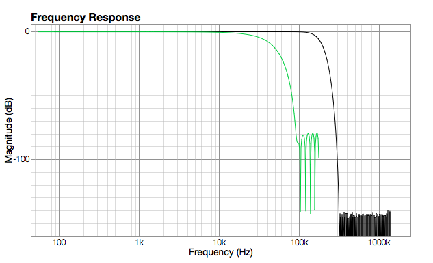

The passage in Dunn's paper I mentioned above is worth considering when we discuss any of the slow roll-off filters.
The key thing here is that distortion products will be largely dependant on non-linearities in any equipment following the DAC. This potentially makes the slow roll-off filters heavily system dependent.
In other words YMMV...
Take, for an extreme example, a full scale input signal of 1kHz below the half sample frequency. The image of this tone (to be suppressed by this filter) will be at 1kHz above the half sample frequency, and at full scale. The filter attenuation at that frequency is 25dB.
The output of the DAC following this filter will therefore have two tones 2kHz apart. A second-order non-linearity in an amplifier or loudspeaker would produce intermodulation products at the frequency sum and frequency difference of these tones. The amplitude of the products would be equivalent to the product of the two amplitudes multiplied by the coefficient of non-linearity.
If the second order non-linearity in the following stages (amplifiers and loudspeakers) is worse than 1% at that frequency and level then the resulting distortion product at 2kHz will be approximately -70dB below the signal. Do not forget that - for our listener at least - the signal itself is inaudible and will not have any masking effect.

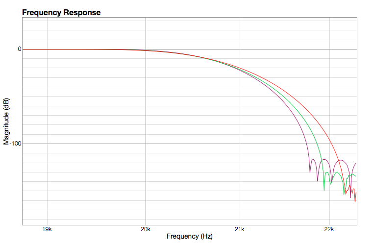

After a bit of playing around I've got something I thinks sounds reasonably similar to the Izotope SRC "best" settings in Audirvana+. I'm not sure I'd be able to wring anything much closer out of 1016 taps anyway... (nb: comparisons done using the 115dB version)
Vocals on the tracks I listened to are positioned in a similar relationship to the rest of the instruments on both A+ and this filter.
The primary intention here is to address the concerns raised by Julian Dunn regarding the distortion products resulting from non-linearities as a result of insufficient stop band attenuation. The second concern I'm trying to address are Pflaumers comments regarding harshness resulting from imaging in the transition band.
I've noticed in playing with these filters that anything less than 100dB stop band attenuation is audible as "clouding" and a loss of transparency. I'd initially done a version with 115dB stop band attenuation but it seems 130dB is better again despite the roll off becoming less steep. Out of interest I tried a 150dB version...
I'd been analysing 24bit .wav files, and realised while I was doing these filters that the filters really needed 32bit .wav's to adequately reflect what is happening in the DAM.
I'd highly recommend working 115 -> 130 -> 150dB so you get a feel for what increasing attenuation does, even if you just give a reference track or two a listen at each stage.
I'm interested to hear if anyone thinks the 150dB filter is overkill after having a listen?
purple: 115dB, green: 130dB, red: 150dB.

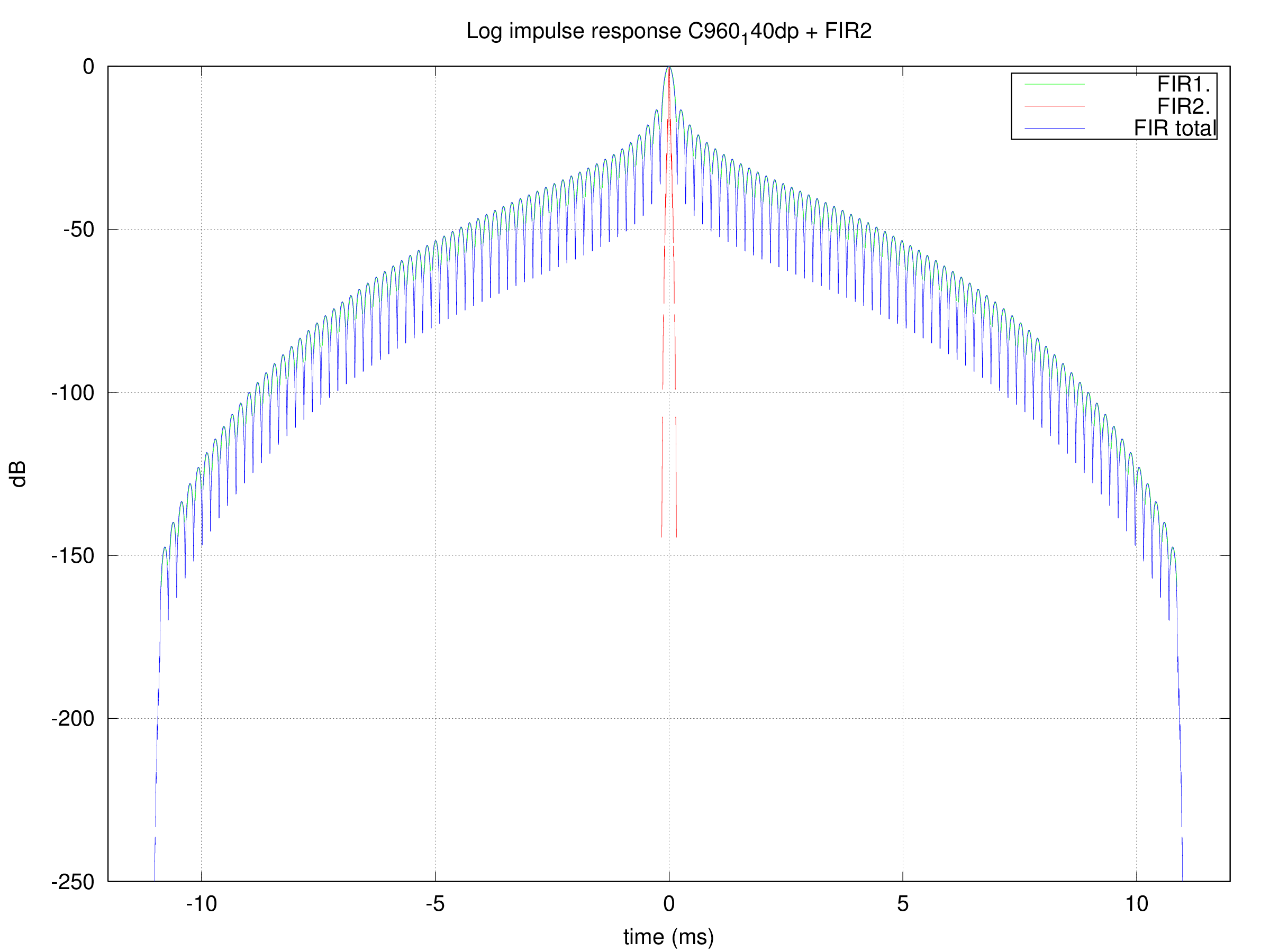

While looking at the impulse response of FIR1 instead of the whole FIR1*FIR2 seems to be safe for moderate-to-long length FIR1, e.g. looking at the following example we see that the visible difference of the total system consists in deeper notches, and some effects at the very margins at very low magnitude.
Whereas if the FIR1 is very short (take the NOS as extrem example) the FIR2 influences the total impulse response considerably

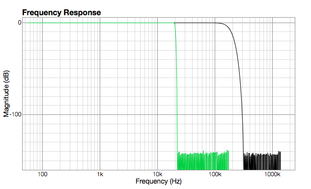

Roll off is by determined the number of taps, the passband band ripple and stop band attenuation.
C128 is about as short as is feasible to achieve roll-off under 30kHz while keeping passband ripple and stop band attenuation to a reasonable level.
If I'm hearing what I think I'm hearing with the 1016_K150_BW filter it may well be that we are better off focusing on stop band attenuation as a primary goal.

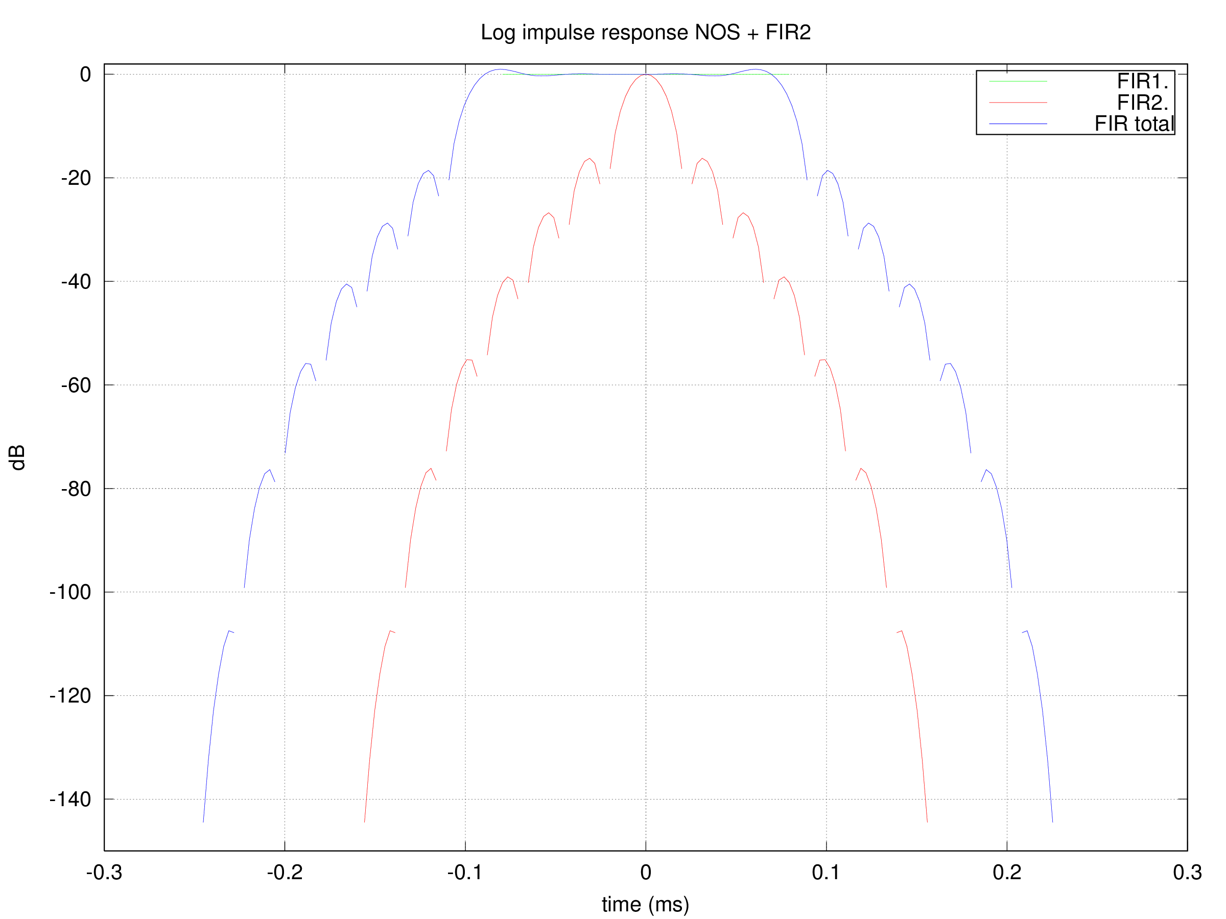

FIR1 will only be altered when FIR2's is not flat through to the start of FIR1's stop band . Typically you would design the FIR2 response to suit the FIR1.

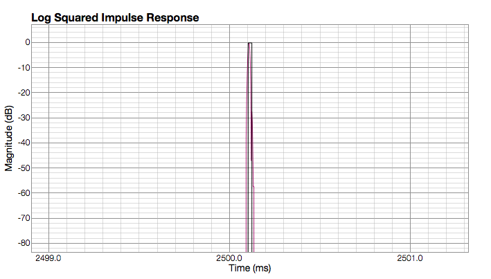

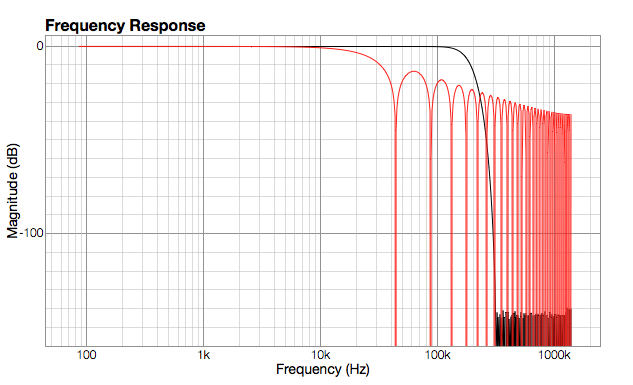

NOSx8x8 vs F2_K150:
You can see the F2 curve undercuts the NOS response above 220kHz, which means FIR1 response will be altered above this point.

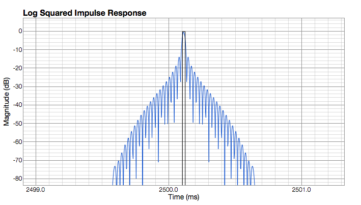

1016_K150_BW vs F2_K150
No interaction between FIR1 and FIR2 so FIR1 response is unaltered.
1016_K150_BW vs 1016_K150_BW up sampled with F2_K150

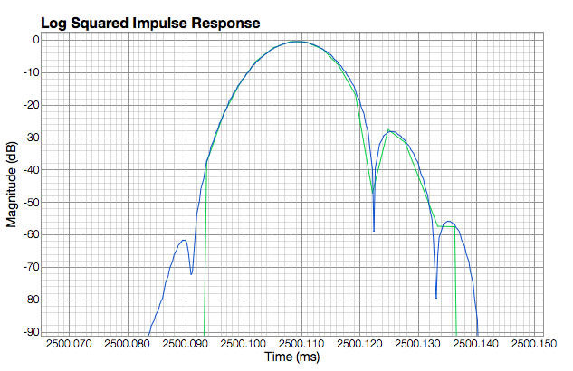

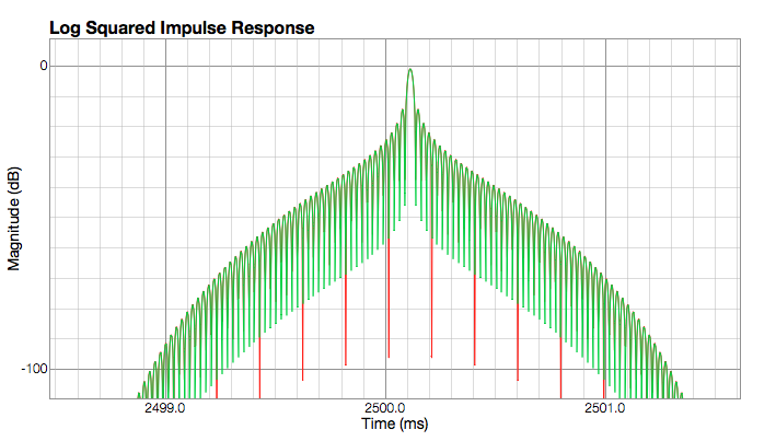

In the case of very short filters like the C16 which has a total of 16 taps there are some changes to the filter response where the FIR2 roll off interacts with FIR1
C16 vs F2_K150 (16 vs 120 taps)

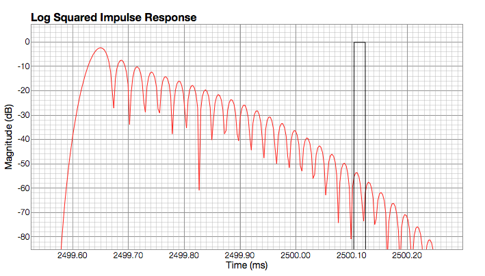

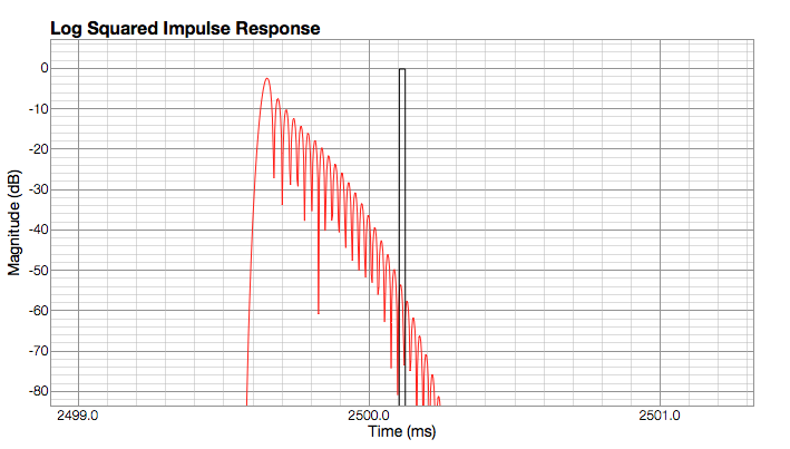

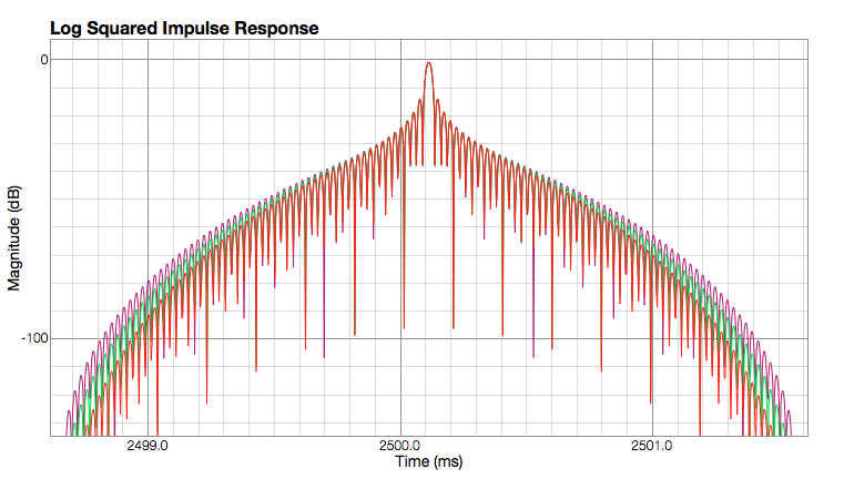

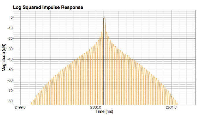

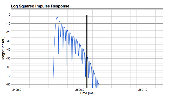

And impulse...
