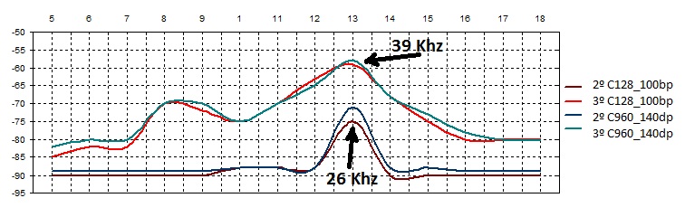

Can you explain how have you produced this image? This rise of distortion at 11 kHz is unexpected to me. What was the bandwidth of THD measurement? THD is typically measured with a −1 dBFS sine tone in the bandwidth of 20–20000 Hz.What oneoclock's plots don't show is the peak in distortion around 11-12kHz that all the filters except NOS display.
Attached shows:
NQB3:red, C960_140dp:green, C128_100dp:blue, Izotope steep rolloff defaults: orange, stock 44.1: purple

The measurement is based on an a single sample impulse in a 44.1/16 .wav, which was resampled to 352.8kHz in RX4 standard, then exported as a wav.
The file was then analysed in Fuzzmeasure. I've been using this to check check/plot frequency and impulse response as it is an easy way of overlaying multiple plots. As I've noted the "peak" disappears when the file is up sampled to 2822400z so I have my doubts it's particularly meaningful.

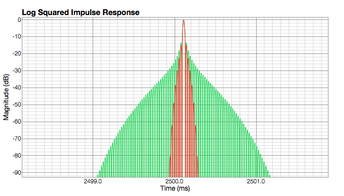

This is a comparison of the log squared impulse response of the C128 and C960 filters:
This can be thought of as how the filter will process a 0dB signal over the length of the impulse.
The C128 (red) has a narrow spread of energy over time, whereas at say -30dB the C960 is influencing the signal for twice as long. The total energy in the impulse at that point will be roughly the same, but we will perceive it differently due to the "smearing" of the impluse energy in time.
Hi Paul. I'm not familiar with Fuzzmeasure, but I'm pretty sure that it is not possible to infer THD from the impulse response: it only gives you the frequency response, phase response, and group delay. For measuring THD one needs a sine sweep or a series of sines. You can run this experiment directly with RX and I'm sure that its distortion does not significantly depend on frequency.

The "HD" peaks look to be directly related to the corner frequency of the filter /2, and the amplitude is related to the steepness of the filter.

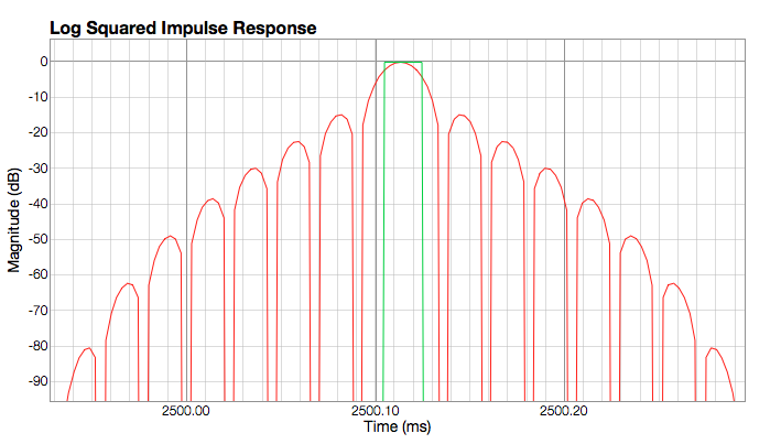

Thanks, this makes sense. And NOS is even narrower?
Yes, much narrower, with no taper.
C128_100 vs NOS attached.

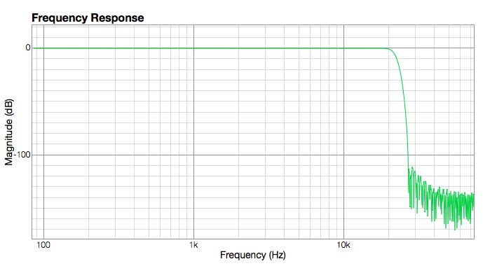

Attached is an filter that is similar in length and roll-off to the stock 44.1 filter. it is -0.1dB at around 19kHz.
